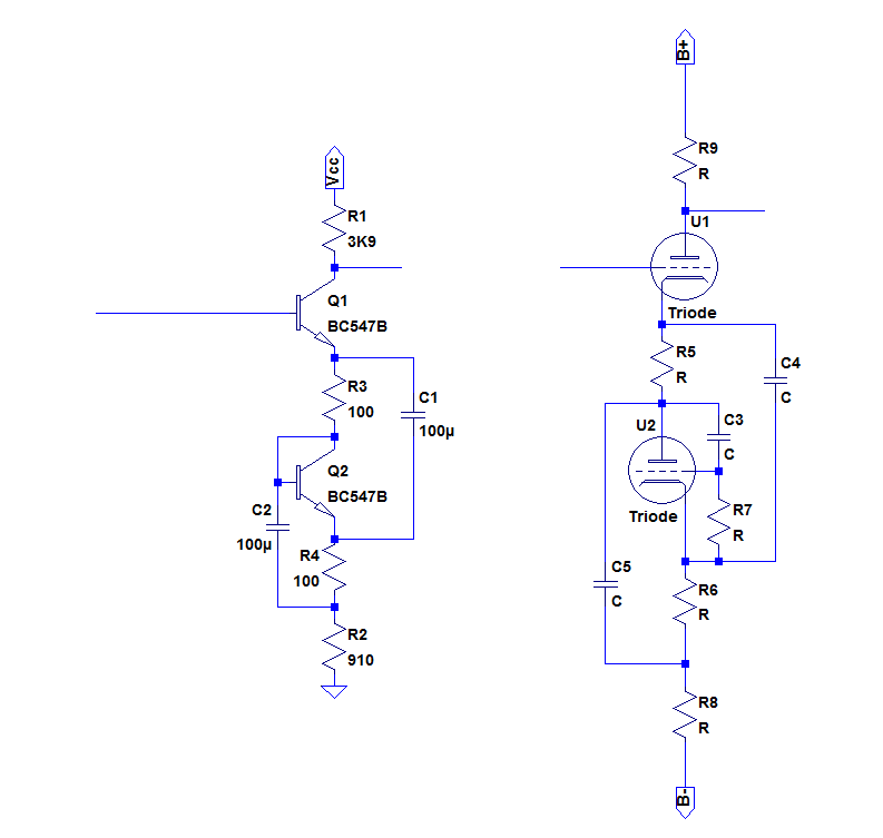

Yes, but you need a trick to make the compensating device work in antiphase, otherwise you double the non-linearity.
Here is how it can be done:
It is based on a capacitor bridge C1 C3 and isolating resistors R3 R4.
The transistor version is quite straightforward, because it is acceptable to use a diode-connected transistor as compensator, but with tubes, things are more complex: to make a proper facsimile, you need to operate the correcting tube in the same conditions as the amplifiying tube, meaning in particular a comparable A-K voltage.
This requires a B- voltage equal to B+, not exactly practical.
With the anode load, you just replace a resistor with something else, which is much easier
To be constructive, here are some ideas to spice up the circuit.

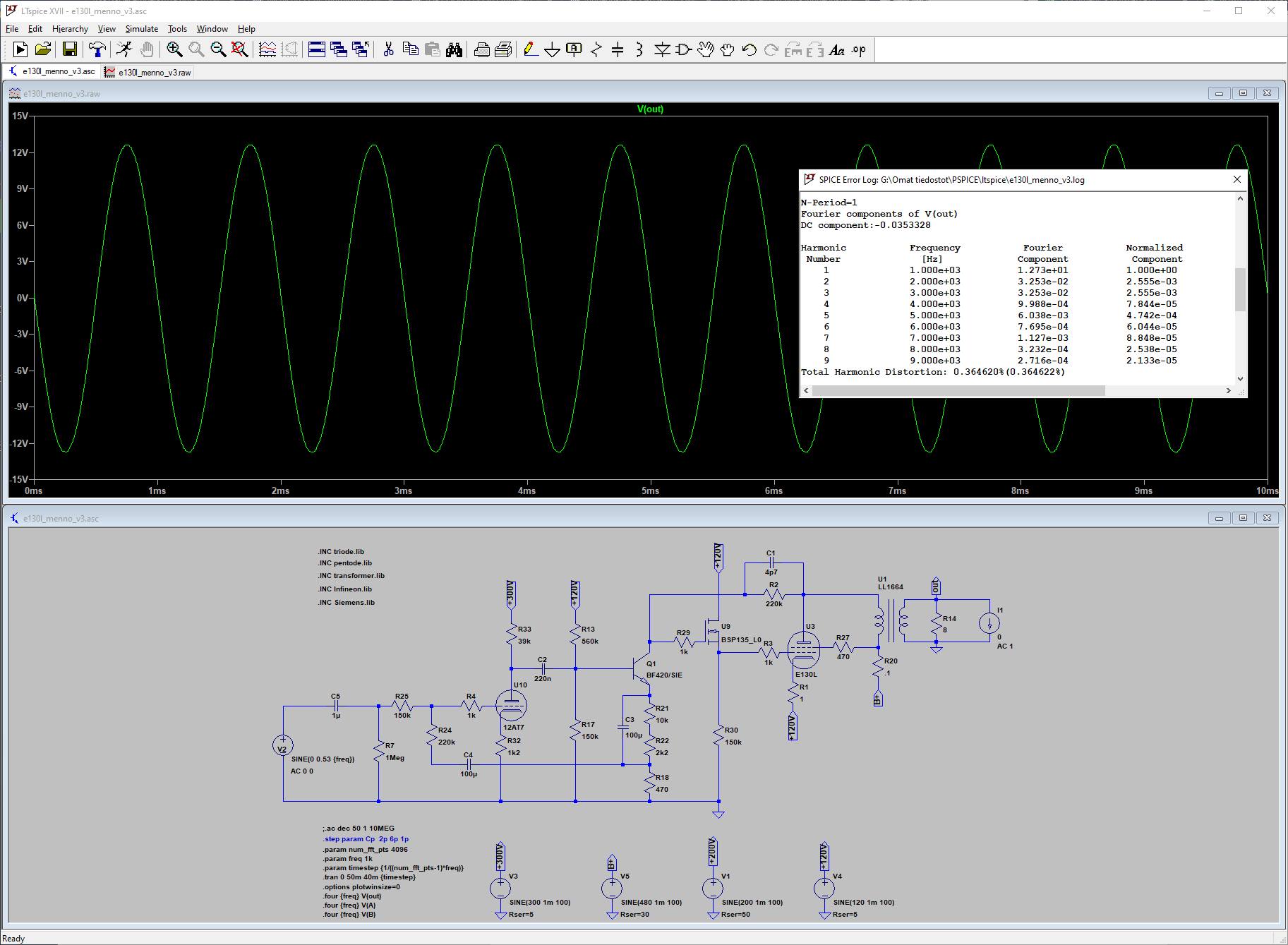

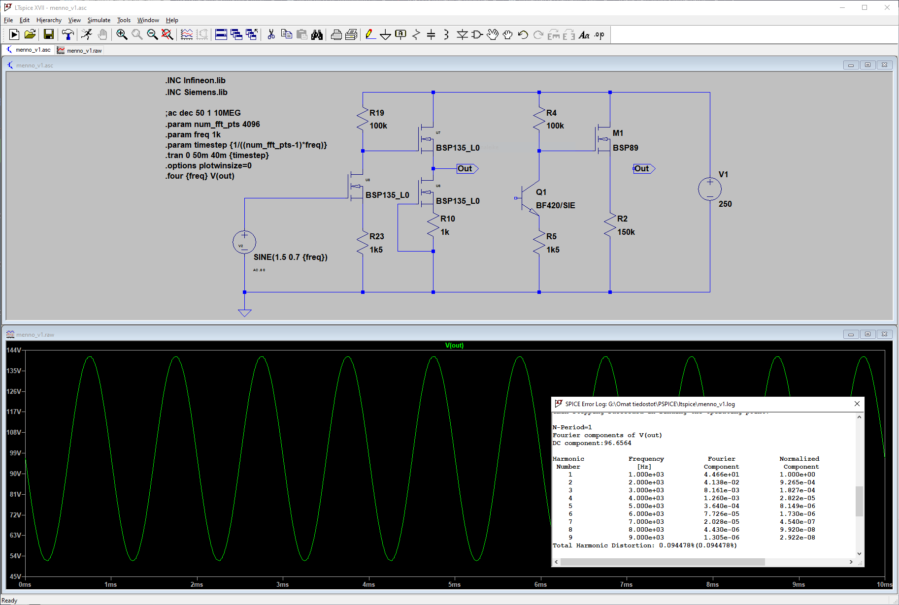

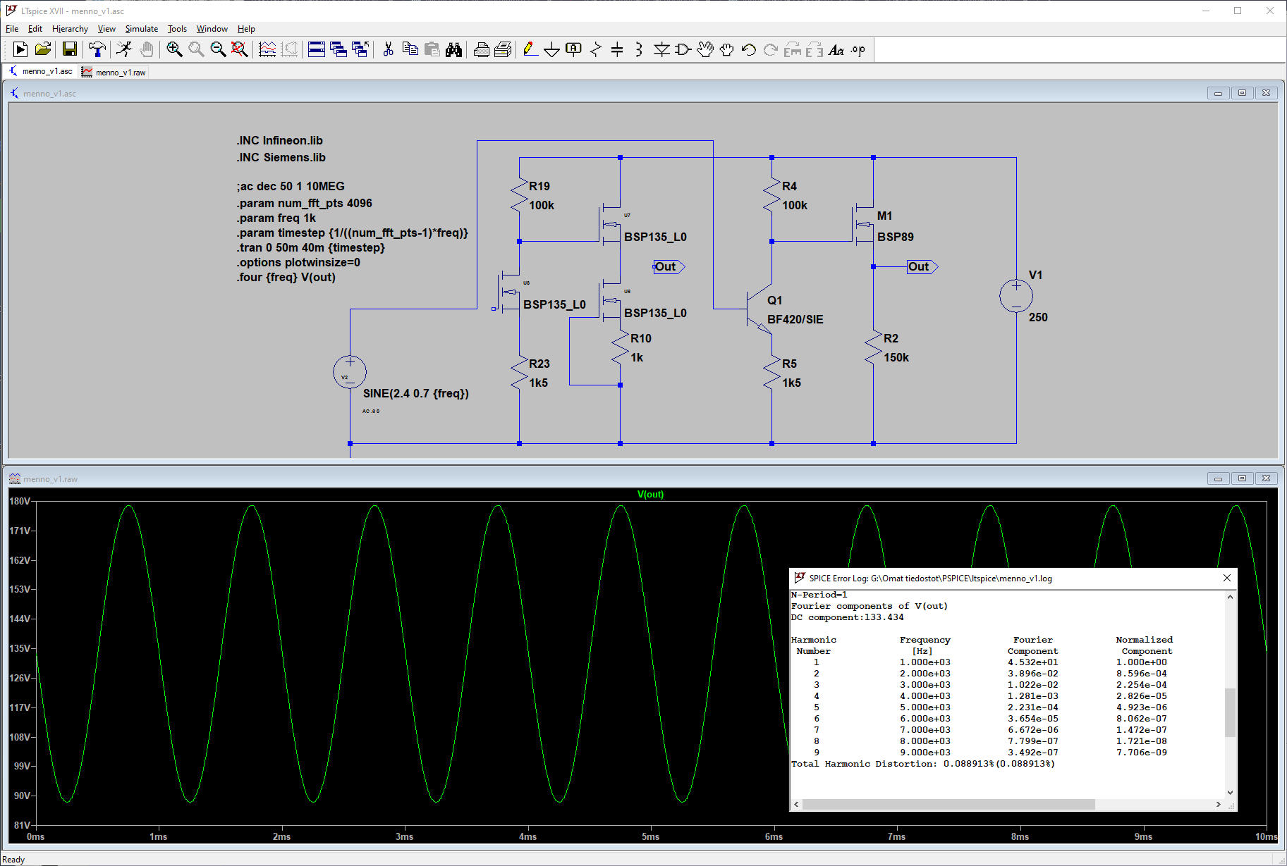

In this voltage amplifier example, the original circuit has a simulated THD of 0.47% with BSP89's as transistors and an output of ~90Vpp:
It seems your results are dependent on simulation models. My results are quite different. I used Infineon's spice model for BSP135 and Siemens's model for BF420.
Your pics are too small to decipher the figures, but I easily believe you.
In general, a BJT will be much more linear for the reasons I explained, but the BSP135 might have an even higher transconductance, or a completely linear transfer function, or both (in sim at least).
It would be interesting to investigate and pinpoint the origin of the distortion in your circuit.
Note that in the conditions of the sim (which I assume are the same for yours), the real circuit built by Jack with BSP135's yielded 0.83% THD, twice the simmed value with BSP89 (which means nothing).
I do not know what your figures are, but the BJT variant should be much better than that, even if it doesn't arrive at 0.038%

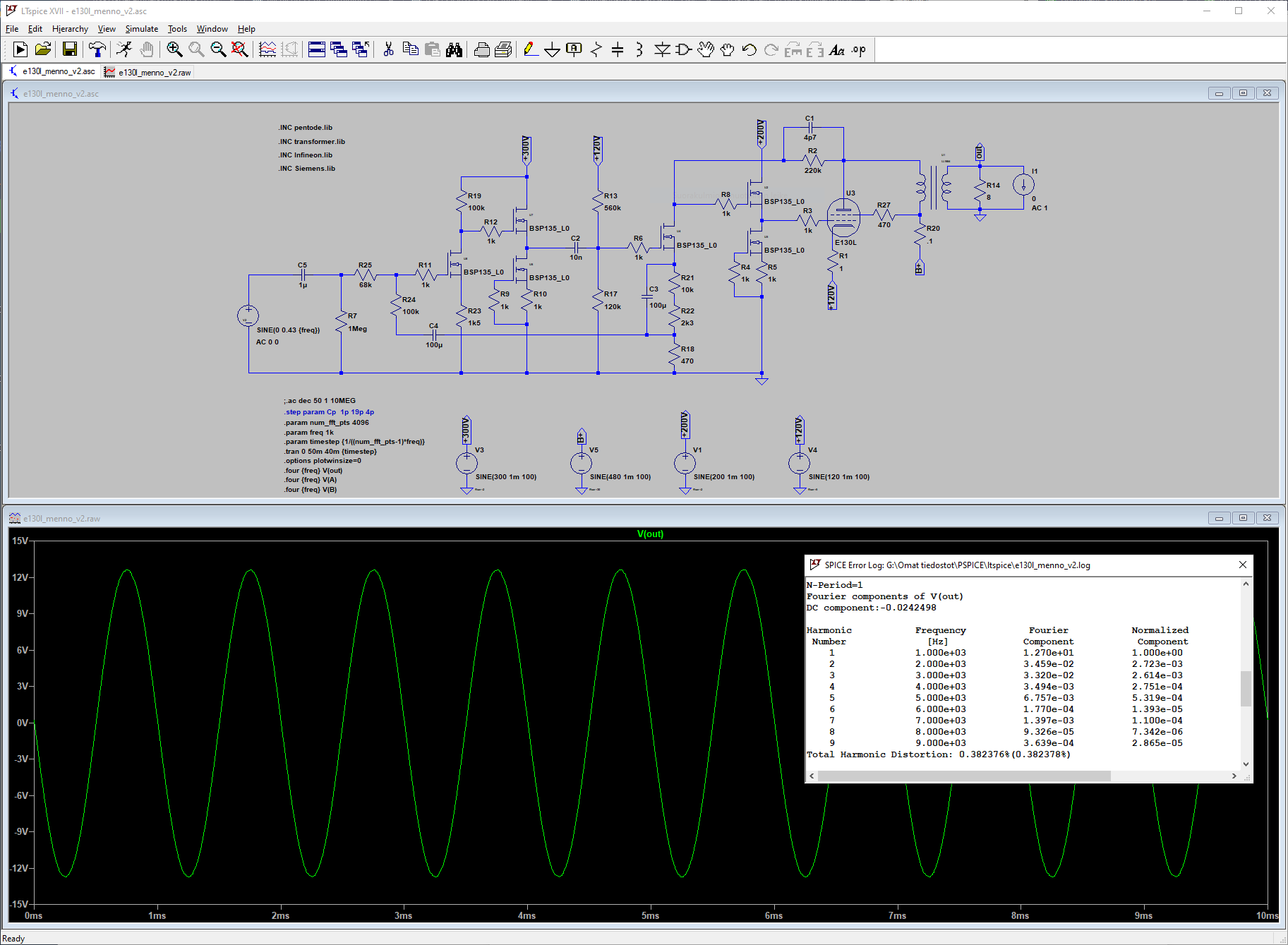

Here are the same pictures in a larger format. By adjusting the DC bias the THD in Menno Cell can be lowered to 0.09%. The same applies to the BJT variant as well. With the models I'm using the BJT variant reached 0.01% THD when the DC bias was 3V.
I cannot explain why the Siemens BF420 model performs so much worse than the Philips one: it should be the opposite, because the Philips has a much lower Vaf.
Anyway, 0.09% with the BSP135 is pye in the sky compared to the 0.83% of the reality.
There are probably compensation mechanisms leading to the (apparent) cancellation of some distortions

Yes, simulations are just simulations, dependent on models and typically overly optimistic. Simulations of tube power amps often fail to model the output transformer which I have found out to be the most critical part. Gobs of feedback can hide output transformer deficiencies in simulations but not in practice. And in some cases intrinsic distortion cancellations between tube stages may be missed in simulations. I do not know if this type of distortion cancelling is occurring with Menno amp. Anyhow simulating the whole Menno amp predicts that it has quite low THD which is to be expected due to the amount of feedback used. I used E130L as the output tube since I have worked with that before.
Based on the article I would assume that the primary goal of the Menno-Cell was not to have the lowest THD but to be a universal building block similar to tubes. E.g. the CCS in Menno-Cell offers few benefits and can be replaced with a suitable resistor. Using CCS however makes it more immune to operating points etc. which may be more important for generic use. Also the use of depletion mosfets instead of bjts may be due to the same goal.

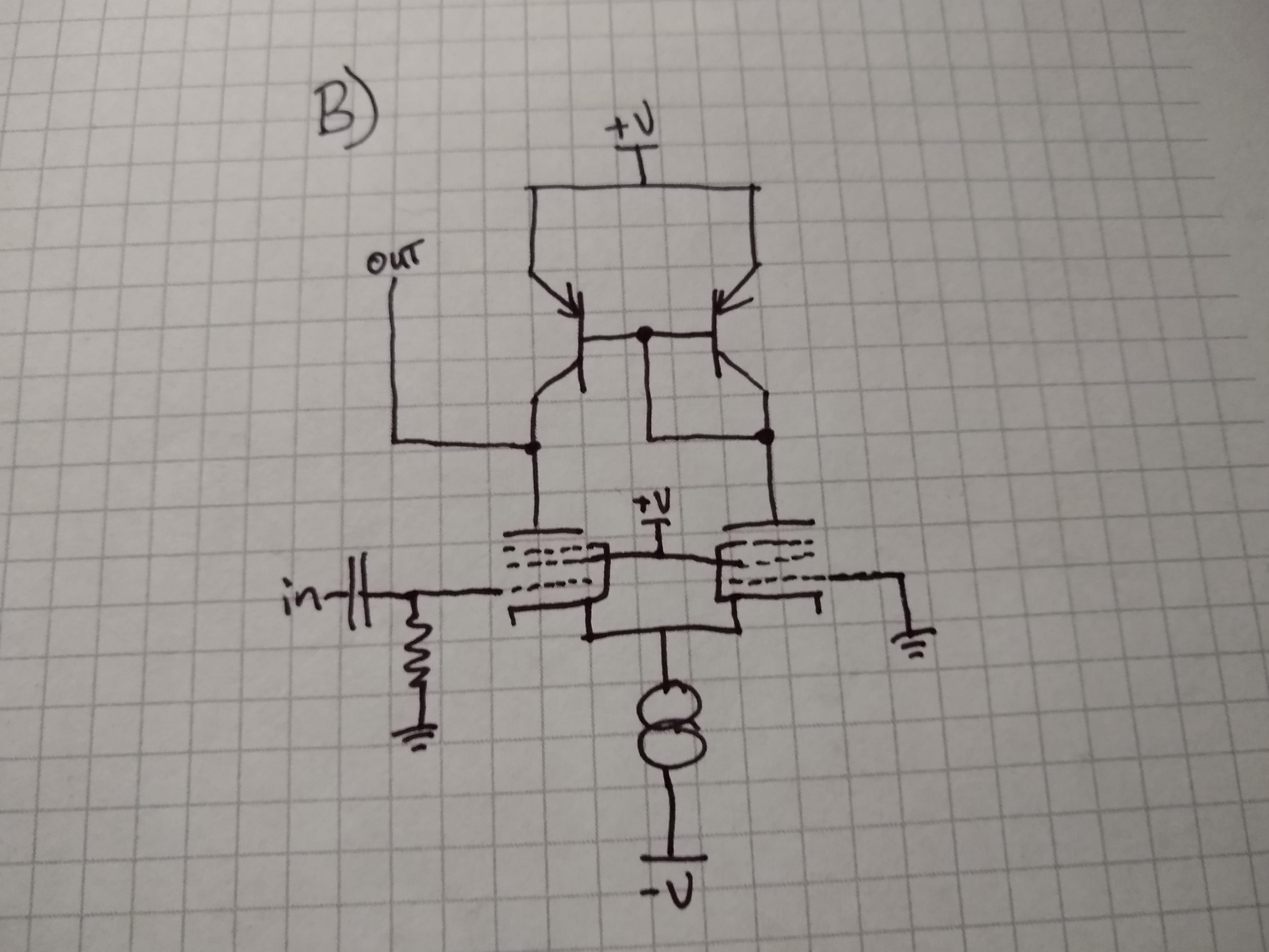

Just to be clear, I'm not talking about using a differential stage as a phase splitter, I'm talking about using it to linearize the pentode which has to work into a vertical load as a V-to-I converter. It is not hard to see the uneven spacing of the curves of even the most linear pentodes working into a near vertical load.
The idea is to set up a circuit to use two pentodes to work in a way that one pentode is working upward into its steep load while the other is working downward so that the composite characteristic of the circuit has more evenly spaced curves. It's not an idea I came up with, it's a copy of your standard solid-state audio amp input stage.
It is wasteful because it uses two tubes for a single phase of a V-to-I conversion (or two mosfets if we are making a little board to do the job) but I'm guessing it would be measurably better in an amp like Menno's.
