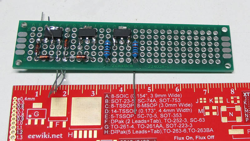

I was reading Menno van der Veen's article "Build 18 W Single Ended Valve Amplifier with Trans Technology" in the December 2019 issue of AudioXpress, went back and got his two part article from 2018.
Menno uses the BSP135 as the driver for the valve output stage. I don't have BSP135 at the moment, some are on order from Mouser, but I do have LND150, a DMOSFet you can use between 1 and 3mA.
Here's the LND150 before it goes into pentode mode:

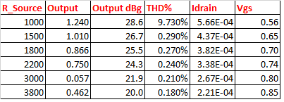

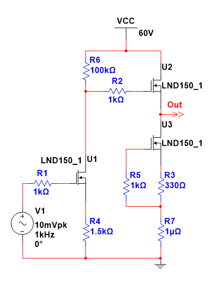

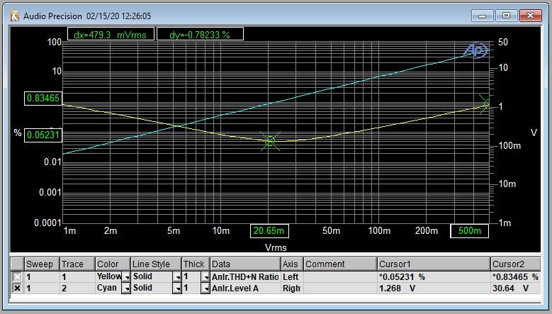

I ran some tests starting with Menno's values, adjusting the source resistor on the follower for 1mA, and then varying the source resistor on the synthetic triode to look at THD% and gain:
Nice.
I think that the high reported THD at RS = 1,000 Ω is related to the R6 value of 100 kΩ. In a nutshell
R3 = 1000, op point = –0.600 V, at 0.600 mA
R3 = 1500, op point = –0.710 V, at 0.473 mA
R3 = 1800, op point = –0.760 V, at 0.422 mA
R3 = 2200, op point = –0.815 V, at 0.371 mA
R3 = 3000, op point = –0.900 V, at 0.300 mA
R3 = 3800, op point = –0.963 V, at 0.253 mA​
So, it becomes perhaps-obvious that with a 60 volt B+ supply, R6's voltage drop with the given operating-point currents goes negative. LOL. The transfer curve of the depletion-mode MOSFET LND–150 is
i (mA) = (0.581 VG ⊕ 1.192)³​
with
R² = 0.99987​
, from the curves given in the literature. That would be a pretty darn good fit.

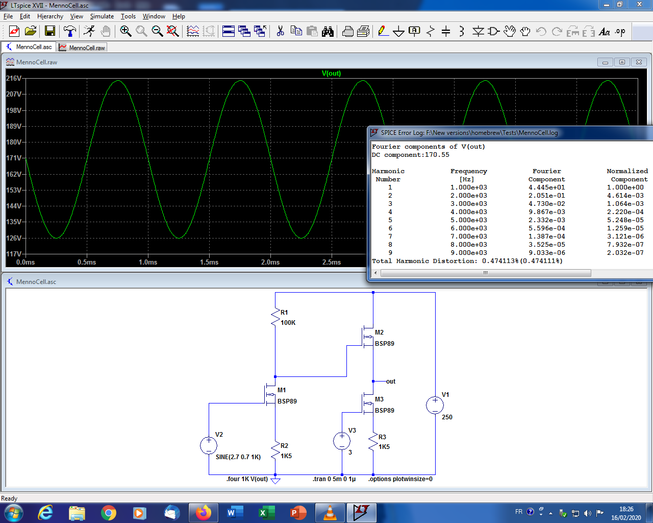

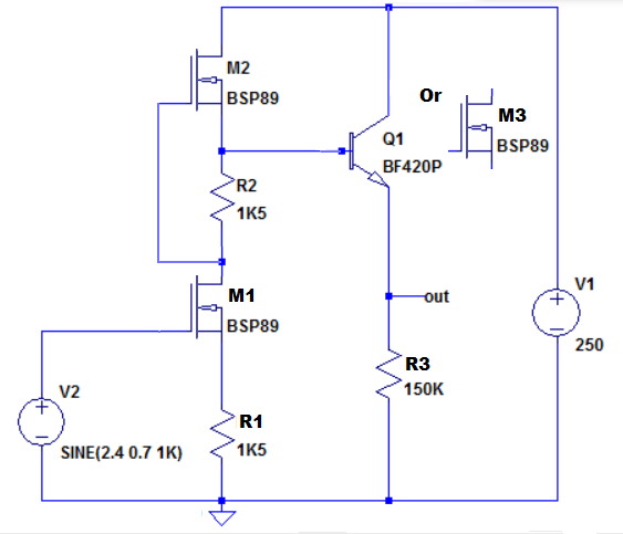

To be constructive, here are some ideas to spice up the circuit.
In this voltage amplifier example, the original circuit has a simulated THD of 0.47% with BSP89's as transistors and an output of ~90Vpp:
attachment.php
The distortion is mostly H2, caused by the non-linear modulation of Vgs, as in all simple amplifying stages of this kind.

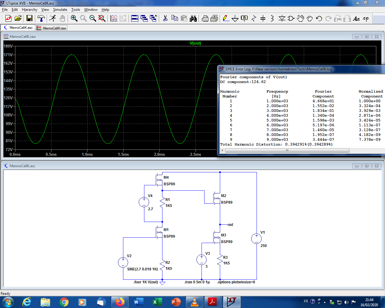

To improve the performance, there are a number of possible methods. One is to make the drain load non-linear in a homologous way.
In practice, the same transistor is wired as a resistance multiplier.
To make a zero-sum change, it is possible to lift the transistor from the output CCS: if the output current doesn't need to be especially high, it can be replaced by a resistor:
attachment.php
The mod simply rearranges existing components, and improves the THD but it kills the initial "cell" concept, unless the active load is seen as an additional cell.

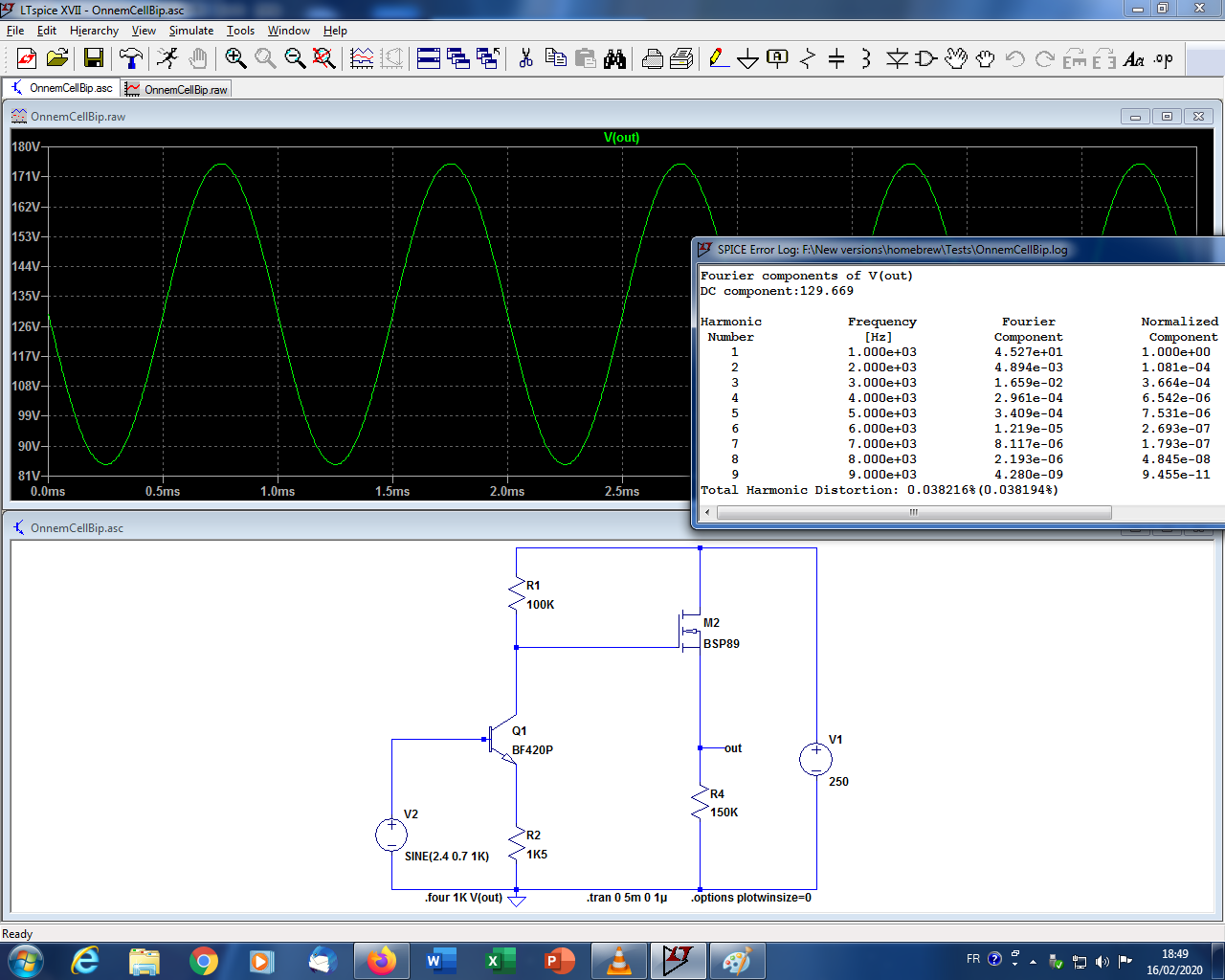

It is possible to keep the cell almost identical, and vastly improve its performance by replacing the MOS with a BJT, in this case a video-output transistor: the BJT has a smaller Vbe than the Vgs and has a higher transconductance, meaning a smaller proportion of non-linearity relative to the signal:
attachment.php
Of course, the BJT is a current-driven device, meaning a base current and a finite input impedance, but in this example, the input impedance is >150K, which is probably not going to be problematic

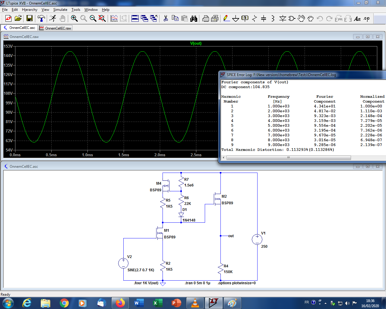

They are depletion fets, just like tubes.
So why not an SRPP followed by a "cathode" follower ?
Mona
It isn't suitable as a direct substitute, because the ~infinite impedance of the SRPP makes the gain ~infinite and the DC bias unstable without external feedback, but the figure of merit of the circuit is very large: the THD is about the same as the original, but the gain is ~40 times larger.
In this sim, the depletion FETs have been emulated with a DC source in the gate:
attachment.php
This means that with properly applied FB, the THD could become 40x times smaller.
As the so-called "transamp" uses a semi-global FB scheme, it could in principle benefit from those properties.
However, it would be difficult to use in the 18W amplifier: it already uses 3 capacitors (C1, C2, C3) in the FB loop, and they have very awkward values, certainly because of the need to split the 3 poles sufficiently, and throwing an additional 52dB of gain into the game would certainly result in motorboating.
The DC stability issue would also be problematic.
In a completely revamped version, the circuit could do marvels though (with a large amount of FB, which might not be to everyone's taste, but that's another problem)
