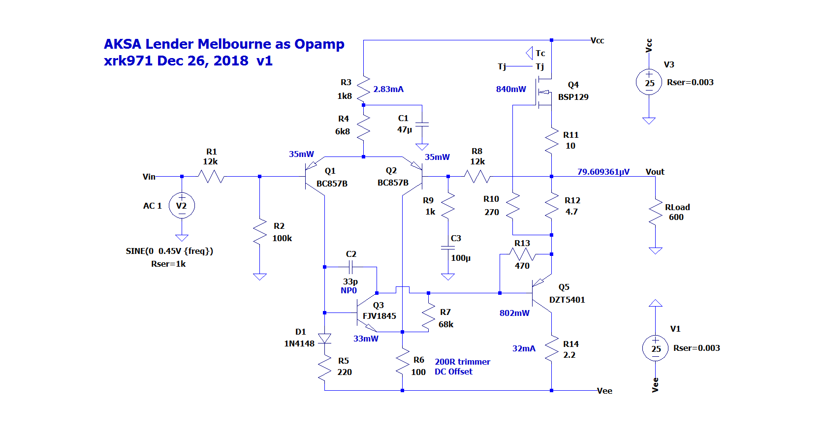

I was trying to see how the Melbourne could be made into an Opamp. A 5 active opamp with nice sonic performance is kind of cool.

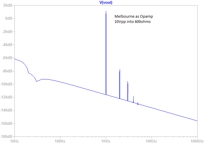

10Vpp into 600ohms:

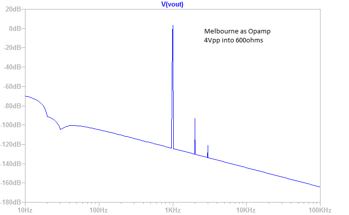

Here is 4Vpp into 600ohms:

10Vpp into 600ohms
Harmonic Frequency Fourier Normalized Phase Normalized
Number [Hz] Component Component [degree] Phase [deg]
1 1.000e+03 5.148e+00 1.000e+00 0.07° 0.00°
2 2.000e+03 2.004e-04 3.892e-05 92.48° 92.41°
3 3.000e+03 2.127e-05 4.132e-06 1.90° 1.83°
4 4.000e+03 2.736e-06 5.314e-07 -144.17° -144.24°
5 5.000e+03 1.918e-06 3.727e-07 -179.82° -179.89°
6 6.000e+03 1.488e-06 2.891e-07 179.56° 179.49°
7 7.000e+03 1.272e-06 2.471e-07 -179.98° -180.05°
8 8.000e+03 1.115e-06 2.165e-07 -179.96° -180.02°
9 9.000e+03 9.893e-07 1.922e-07 -179.99° -180.05°
10 1.000e+04 8.904e-07 1.730e-07 -179.96° -180.03°
11 1.100e+04 8.084e-07 1.570e-07 -179.99° -180.06°
12 1.200e+04 7.405e-07 1.438e-07 -179.99° -180.06°
13 1.300e+04 6.825e-07 1.326e-07 -179.99° -180.06°
14 1.400e+04 6.332e-07 1.230e-07 179.98° 179.92°
15 1.500e+04 5.898e-07 1.146e-07 -179.99° -180.06°
Total Harmonic Distortion: 0.003915%(0.004216%)
Code:
4Vpp into 600ohms
1 1.000e+03 2.059e+00 1.000e+00 0.07° 0.00°
2 2.000e+03 3.126e-05 1.518e-05 94.45° 94.38°
3 3.000e+03 3.442e-07 1.672e-07 7.31° 7.24°
4 4.000e+03 8.807e-07 4.277e-07 -177.41° -177.47°
5 5.000e+03 7.051e-07 3.424e-07 -179.98° -180.04°
6 6.000e+03 5.862e-07 2.847e-07 -179.99° -180.06°
7 7.000e+03 5.022e-07 2.439e-07 -179.99° -180.05°
8 8.000e+03 4.391e-07 2.132e-07 -179.99° -180.06°
9 9.000e+03 3.900e-07 1.894e-07 -179.99° -180.06°
10 1.000e+04 3.507e-07 1.703e-07 -179.99° -180.06°
11 1.100e+04 3.185e-07 1.547e-07 -179.99° -180.06°
12 1.200e+04 2.916e-07 1.416e-07 -179.99° -180.06°
13 1.300e+04 2.688e-07 1.306e-07 -179.99° -180.06°
14 1.400e+04 2.493e-07 1.211e-07 -179.99° -180.06°
15 1.500e+04 2.324e-07 1.128e-07 -180.00° -180.06°
Total Harmonic Distortion: 0.001520%(0.002151%)

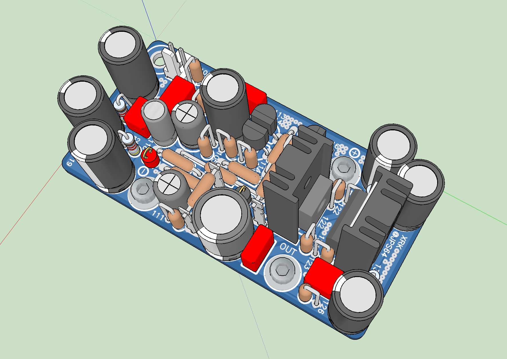

x- sorry for the noob question. After having finished the Karlsonator, I will go into the Melbourne - have got prints from you - Does the extra numbers in the parts list in post 7 refer to something - such as numbers at a supplier?
Hi HenryLarsen,
Cool that you are going to make this preamp! The 3rd column is normally the "package type" as auto-generated by Eagle. I think 0207 are SMT resistor size 0207 for example, and the CMF55 are the axial 1/4-watt 1% metal film resistors by Vishay-Dale. But things like TO92 EBC is generic and you need to make sure it is the variant with EBC pinouts vs BCE, etc. The caps with E3, 5-7 refer to the E3 series of 3 values per decade and the 5-7 probably is the pitch and diameter? JPS64 would probably be best person to answer. Hope that helps.

Code:

No, it works great as such. It can drive 50ohm headphones no problem when DC coupled. 600ohm loads pose no challenge for even maximum output of 40Vpp when running +/-25v rails. 10kohm or higher load of typical high impedance is of course, no problem.

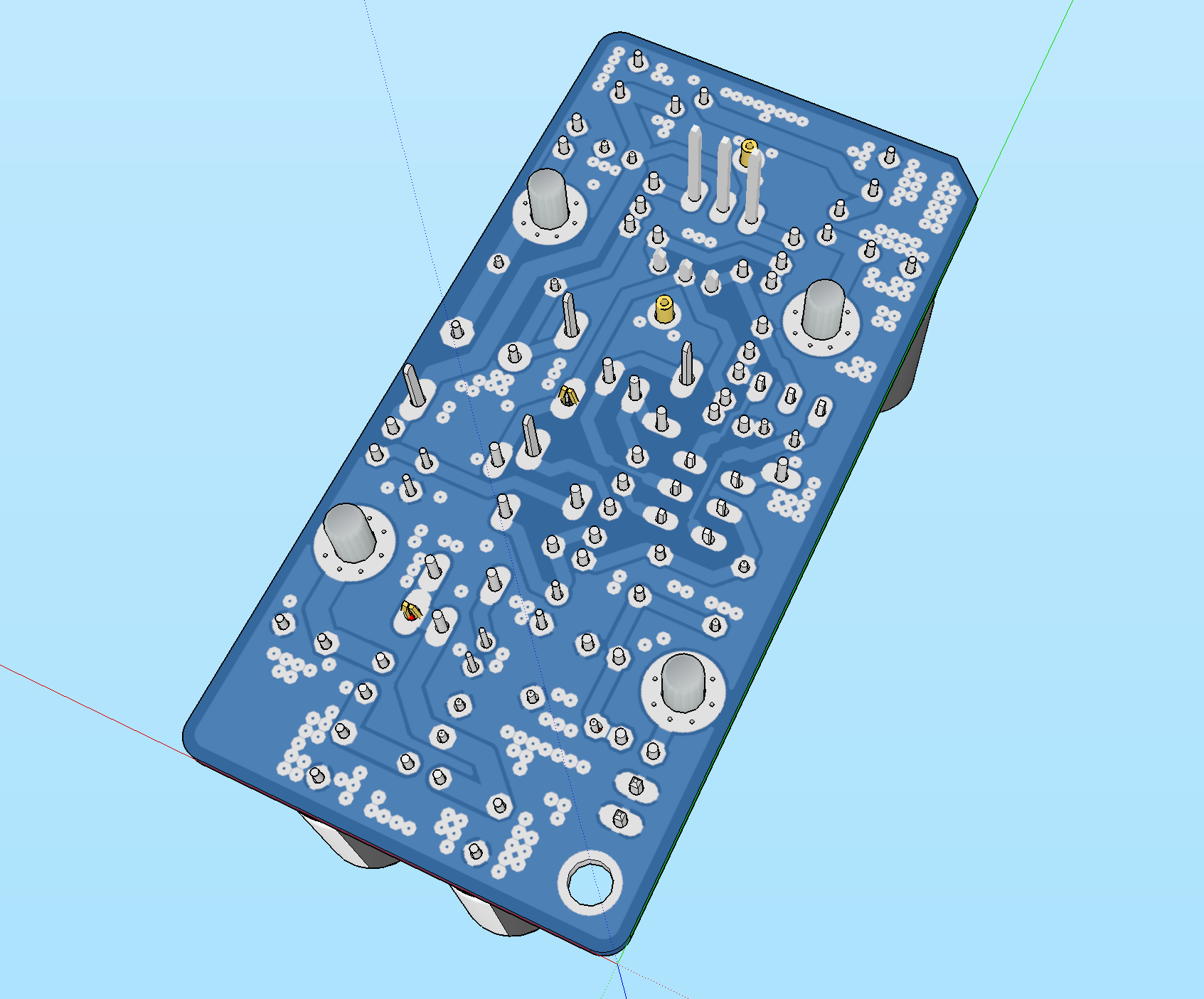

JPS64 is back and I should have new Gerbers tomorrow. Here are the new improved layouts for the TH board. With correct pin outs for M2X of course.
