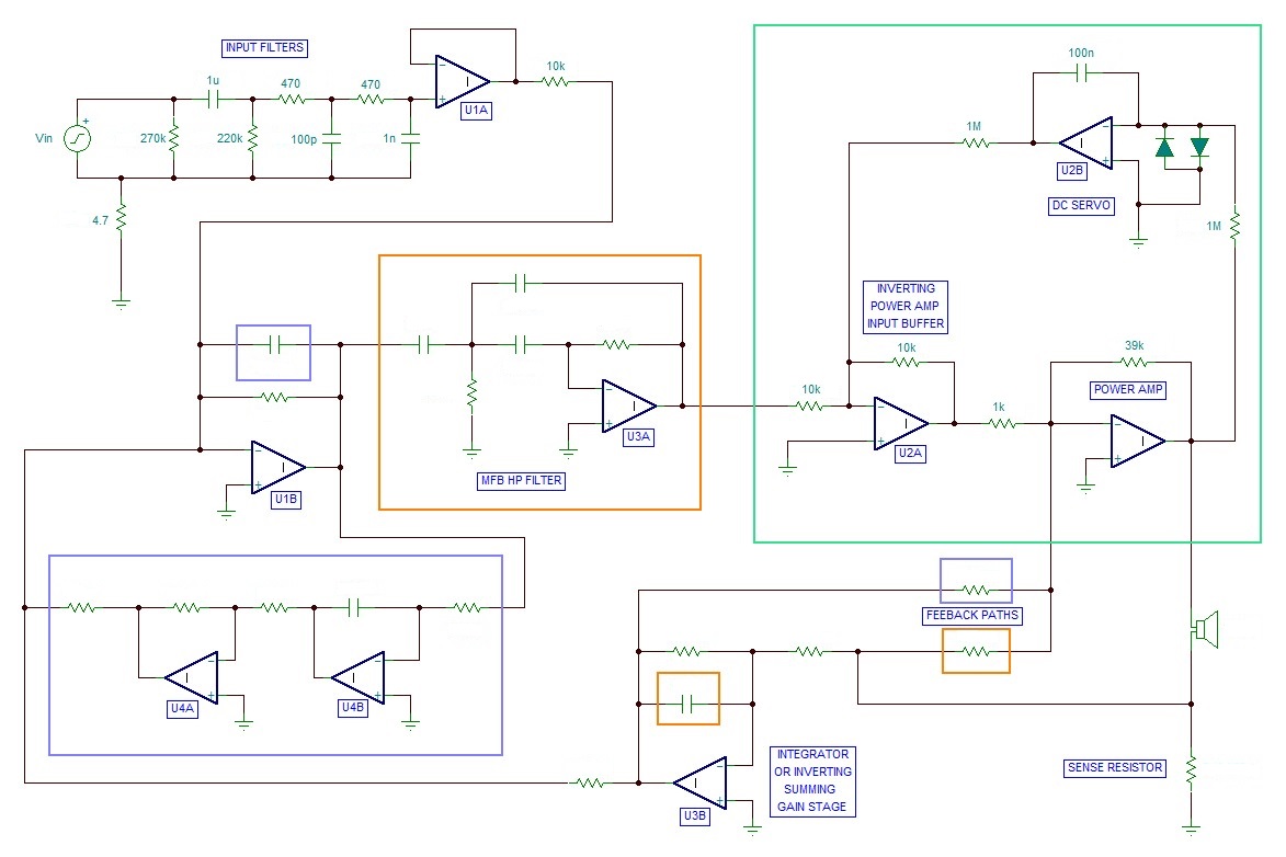

This is sort of a multi-disciplinary project combining an amp and EQ/boost/MFB (can I say that?) network and it could have been started here or there within these forums. Part of the original idea was to clear out my stock of TDA7293s so it ended up here. If the project is wildly successful I could work on a version that uses a class-D amp, but that is far in the future for now.
I would prefer a holistic design approach, but I am also considering separate boards for the line level circuit and for the amplifier so that these could be split from each other more easily in the future. Baldin took that approach in his design a few years back. I have always been wary about doing it that way, feeling that this opens up the possibility of (for instance) accidentally choosing a power amp that is inverting when expecting a non-inverting amp, connecting the speaker and then watching the system self-destruct at power up. Designing the system (amp+circuit) as a whole gives me some peace of mind in this regard.
A few more topology tweaks and now things are finally coming in to focus!
I added an input network and buffer - this is directly lifted from Bob Cordell's "Super Gainclone" circuit. The DC servo and power amp input buffer idea is also borrowed from that design. I've re-arranged the MFB and DC-servo (no longer 2-pole) so that I could add the power amp input buffer, which will allow me to keep the input impedance to the power amp IC low. Now the MFB op-amp can't be eliminated, so if that filter is not needed or desired it should be converted to an inverting buffer. This can easily be accommodated on the PCB.
To cut down on the confusion I have put component values into the circuit where I know what they will be. For the parts of the circuit that depend on the driver and box parameters that are required for a particular ACE-BASS or LEMF application those component values have been removed since they were meaningless anyway.
Feel free to comment on what is shown. At this point I could use the input. Also, thoughts on the op-amp types are welcome - I am considering using OPA2604 (inspired by Bob Cordell again) because of their FET inputs, low distortion, and ability to drive low impedance loads. A cheaper option might be the TL072.
Latest circuit effort attached.

are the grounds shown are all signal grounds except: the first one (4R7) and possibly the last one (sense R)?
Let me clarify about the grounds.
- The sense resistor goes to a "power" ground, returning the current from the power amp. This will connect to the local amp power supply bypassing caps and then on to the main PS ground.
- The 4R7 on the input is doing a couple of things: Its helping to reduce/prevent ground loops involving the mains cable ground and the RCA interconnects coming from the upstream equipment. It's also establishing a "quiet" line-level audio ground from the main ground of the power supply.
- Although I did not draw it specifically, all the other grounds in the circuit will be connected to the "4R7 lifted" ground at a star point. This is more layout related, but I probably should have more explicitly shown this.
yes that's helpful and in line with what i would have expected. thanks for adding clarity to it.
How much capacitance would you suggest be added parallel with the 4R7 so that all of the small signal coupling would not be required to simulate a bad capacitor?[*]The 4R7 on the input is doing a couple of things: Its helping to reduce/prevent ground loops involving the mains cable ground and the RCA interconnects coming from the upstream equipment. It's also establishing a "quiet" line-level audio ground from the main ground of the power supply.
[*]Although I did not draw it specifically, all the other grounds in the circuit will be connected to the "4R7 lifted" ground at a star point. This is more layout related, but I probably should have more explicitly shown this.
[/LIST]
Maybe it would not take much, but surely it would take some. So, what would that be? In my experience, a minimum value would be 4n7.

I do not advocate using a capacitor in parallel with the 4R7 resistor.
There exists common mode choke based circuits and op-amp based circuits that could possibly compensate for lack of a capacitor parallel with the groundlift resistor. A different option that works ever so much more easily is a smaller value groundlift resistor.
The concern is not in the circuit itself, but rather what usually happens when a PC is connected at input.
