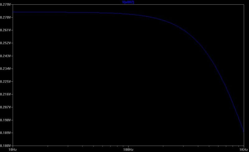

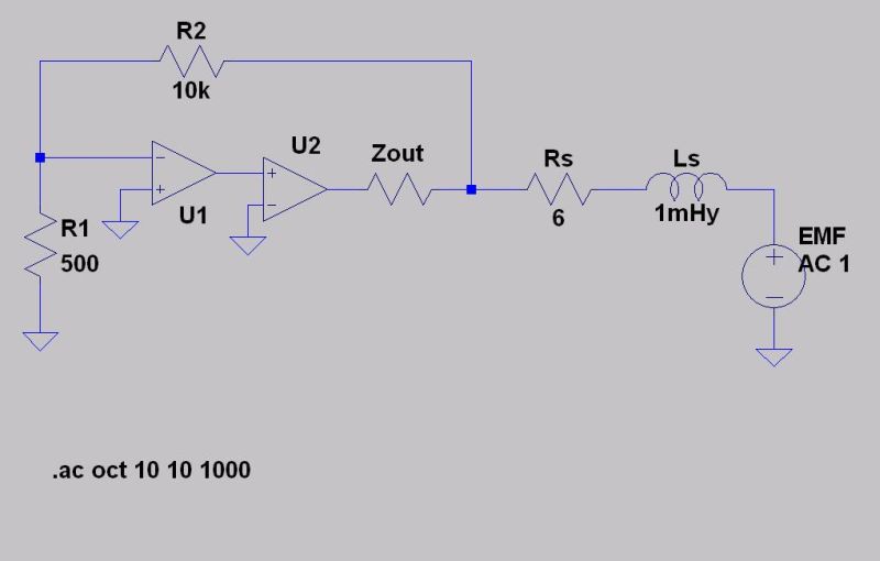

Some more simulations
Here we have the block diagram of a classic SS amp under back EMF drive.
U1 is the input/VAS stage (gain=2K), U2 is the emitter follower stage (gain=0.9), Zout is the follower's equivalent output impedance, closed loop gain 21 dB, feedback 40 dB.
Rs and Ls are the speaker's resistence and inductance; EMF is the generator.

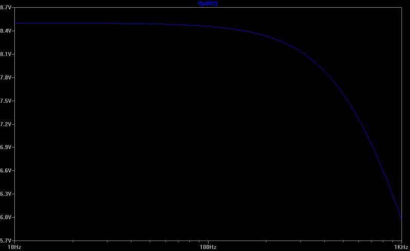

Now we have the plot for Zout 50 ohms, representative of a classic Darlington (2 transistors) stage:
The VAS drive voltage increased to 8.5V, so it's much more likelly that some distortion could arise due to EMF.

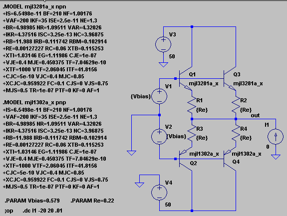

A while back in this thread, there was discussion about power amp output transistor models. I came up with a model for the MJL3281a that was a tweaked version of the OnSemi model, modified so its DC parameters were a much better fit to the data sheet characteristic curves than the standard one. I cloned this model to a PNP as well, making a symettric pair. I put these in the simulated circuit below, with a stepped DC current source as the load, going from -20 A to +20 A. This circuit has 0.22 Ohm emitter resistors, with the bias current adjusted to Self's optimum value for this configuration, 107 mA per device.
I plotted V vs I, which wasn't very interesting. But there's also the undocumented LTSpice d() plot function, which takes the derivative and plots it. This is more interesting, as it gives the output impedance at DC as a function of load current. In reality, this could be a multi-dimensional nonlinearity - that is, the output impedance could be a function of both output current and voltage, but I'll neglect that for now. Also, it would be more realistic to have a non-zero resistor from the junction of the two bias voltage sources to ground. A picture of the test simulation circuit is below.

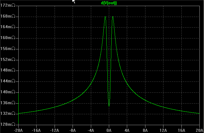

The output impedance vs current is shown in the graph below.
One interesting thing might be to try to duplicate this behavior as a nonlinear one-port using controlled sources that are polynomials. This might be done using MathCad or a similar tool to fit the I/V curve. Then, this nonlinear impedance could be put in series with an ideal, distortionless voltage source. Any computed distortion would then be due only to the impedance nonlinearity and its interaction with the load. The effects of feedback on this distortion could also be examined.
