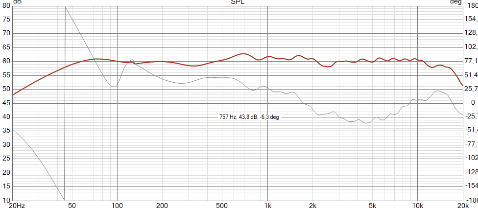

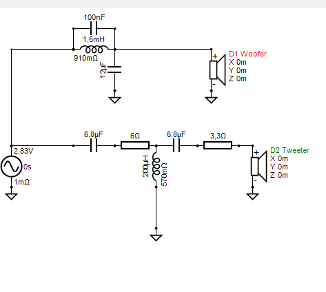

The crossover is very simple and cost-effective. Crossover-point is 2.3kHz but the tweeter can probably eaasily handle a lower one.
When measuring the built speaker the tweeter seemed to be even more sensitive than when I originally measured the drivers. If one wants to build this speaker he should experiment with different resistor values to find his own sweetspot. I started with a 3.3Ω but the tweeter was definitely too bright with it. I settled on a 6Ω but as the measurement will show the tweeter is still a bit loud with it, but I like how it sounds.
As I said, the crossover could still use some work to be really good.
Actual response is merged with nearfield port measurement. Merged at 100hz with 4 octave blend. Notice the port-resonance at 720hz (any tips?).
Unfortunately I haven't made any directivity measurements yet, but I think the speakers would measure just fine.

Nice job so far!!
Regarding the port resonance - lining with open cell foam does not do much, and you haven't lined much of the inside walls. Try lining the sides, back, top and bottom (probably just laying over the crossover) with 30mm cotton insulation, something like THIS.
Your actual measurements show a 5dB rise from 2 kHz to 10 kHz, this will probably be "bright" or "fatiguing". Try (1) increase the resistor, try moving it in front of the first capacitor or after the last capacitor to see what works best. (2) Maybe try a very small inductor (something like 0.05 mH) before the first capacitor on the tweeter.

I've got some more resistors laying around. I will try them out tomorrow, from testing out in Vituix it looks like another resistor after the last capacitor could do the trick.
Thanks for the cotton insulation tip, I'll order some and try it out.
Just finished testing with the resistors. Another 3.3Ω worked and the response is looking very fine now (besides the resonance). Small dent from crossing over is visible but I got some more caps laying around which I will give a go and see if they make it look better. But already very happy with the results now!

Response looks great! If they don’t sound forward to you with that rise at 7k, don’t worry about it……sometimes that narrow bump is nice to bring vocals out in a mix that’s cloudy or complex. An impedance sweep should show if it’s a system resonance or not.
