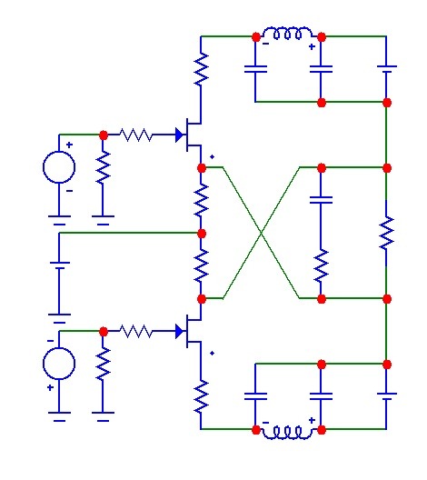

I've been wanting to make another Circlotron for a while; I built my first one in the early 80's.
I have 60 unmatched LU1014, rather than going through the tedious process of matching up a quad set, I might give this a go as I have an untouched matched quad set of THF51S from Watanabe sitting in a draw.
OK, the H3 probably won't be as low, but it can have plenty of grunt to drive my inefficient speakers - 86dB 3R. :smash:

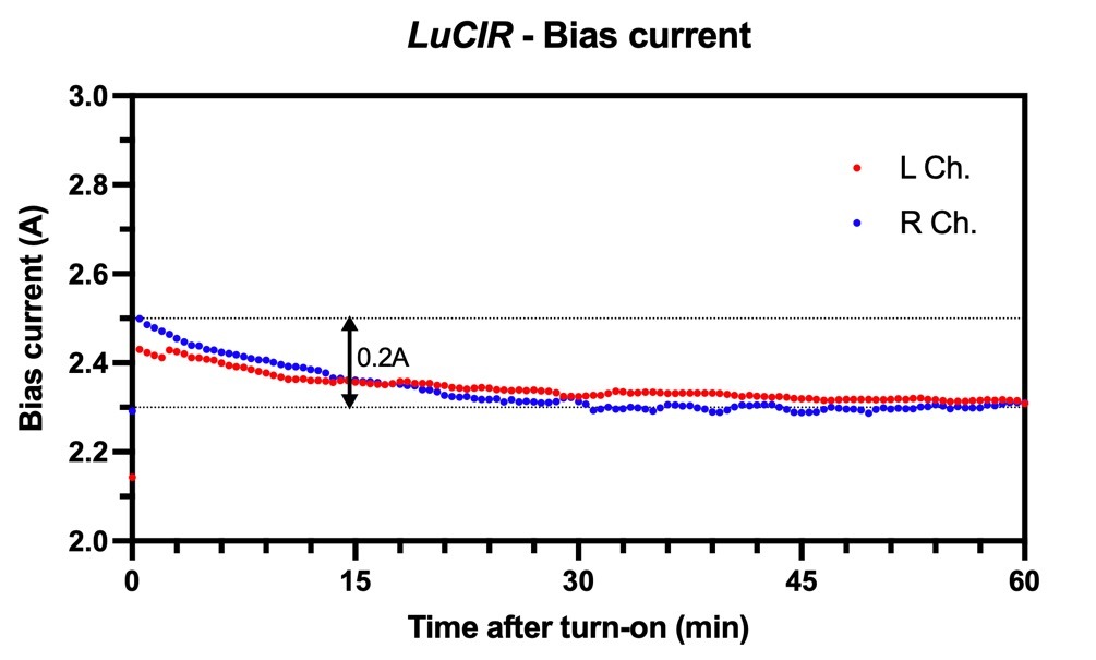

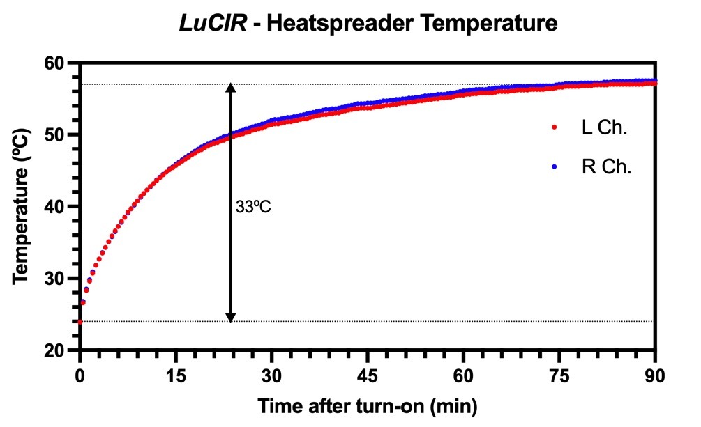

Thanks to the temperature-compensated LU1014 Vgs, the bias of the amplifier remains constant even with the increase in temperature of the heatsinks.
There is no need to wait for sonic bliss after turn-on, and there is no danger of thermal runaway.

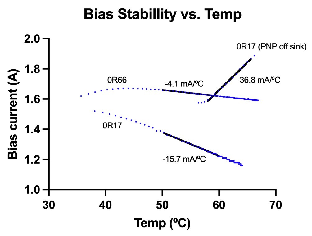

I don't believe I conducted this specific experiment, at least not with the optimized final circuit mounted on the larger heatsinks. Most of the measurements I performed were on a test rig with an undersized heatsink, but they were primarily done with the compensation circuit in place.
However, I did carry out an experiment that effectively demonstrates why it is important to use temperature compensation in this amplifier circuit and adjust it based on the specific circuit details/implementation. In these measurements, I monitored the bias current and heatsink temperature for amplifier circuits initially biased at around 1.6A at ambient temperature. I suspected that the required compensation depended on the value of the LU1014 drain resistor (Rd), so I recorded measurements for two different Rd values (0R17 and 0R66).
As an afterthought during the second measurement (0R17), I removed the temperature sensing transistor from the heatsink and allowed it to cool down to ambient temperature. By doing this, I effectively restored the initial bias and eliminated temperature compensation. Subsequently, I turned the circuit back on and continued recording the bias current and temperature. Without compensation bias current rises rapidly (approximately 40 mA/ºC).
Assuming that the coefficient of 40 mA/ºC does not vary significantly with Rd (although this may not be a safe assumption), the bias current of the constructed amplifier would increase by approximately 1.3A due to the 33 ºC temperature rise.
The exact duration of this increase and where it would stabilize would need to be determined through further experimental investigation on the actual amp. Maybe I can find the time to do the test one of these days.

The temperature rising rate is depending on the total heat dissipation, heatsink Rtha, and heat capacity of the heatsink.
It should not be circuit details dependent.
But of course the dT between sink and LU1014 junction is depending on dissipation of the LU1014 itself.
Patrick
What I say is that the apparent dI/dT rate (change in bias current per unit temperature) is circuit dependent as documented specifically for Rd in the figure.
Fortunately, it appears to vary very little between different (matched) LU1014Ds🙂

Do you have any insight as to why at the same starting bias current of 1A6 the heatsink temps began at ~57C (for the experiment w/o the PNP on the heatsink)? I read that you allowed the heatsinks to cool to ambient between experiments, correct? Am I misinterpreting?
I allowed the temperature sensing transistor to cool down. Not the heatsink - to lazy to wait for that to cool down properly.
