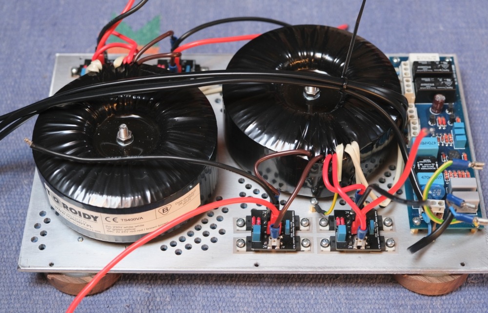

To start with a family photo.
Patrick

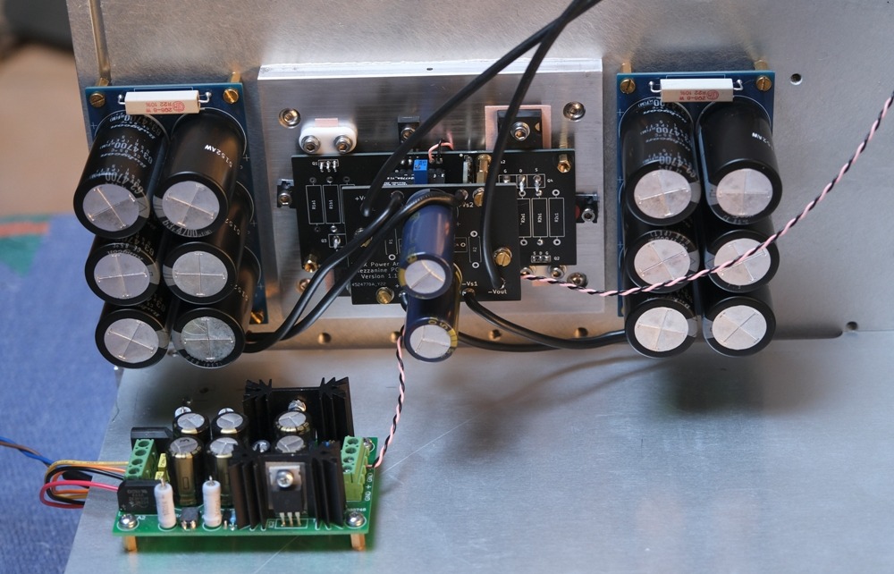

First of all, there are quite a bit of circuit adaptations required to go from a headphone amp buffer to a speaker buffer.
These considerations and the required changes in the circuitry is discussed in the pdf attached.
Patrick

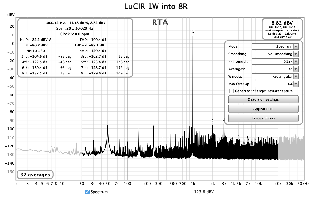

All the credit for this amp truly goes to Patrick. I have simply been fortunate enough to put it into practice and enhance its performance by conducting all the device-dependent experimental work that simulations cannot accomplish for you.
The amp lives up to my all my expectations in terms of sound and greatly exceeds them when it comes to measured performance. I have developed a fondness for the sound of my B-DAO head-amp and I had hoped that this new amp would offer a similar and equally impressive audio experience. Thankfully, it does. This similarity is not surprising, considering that the only significant difference between the two is the placement of a single resistor...

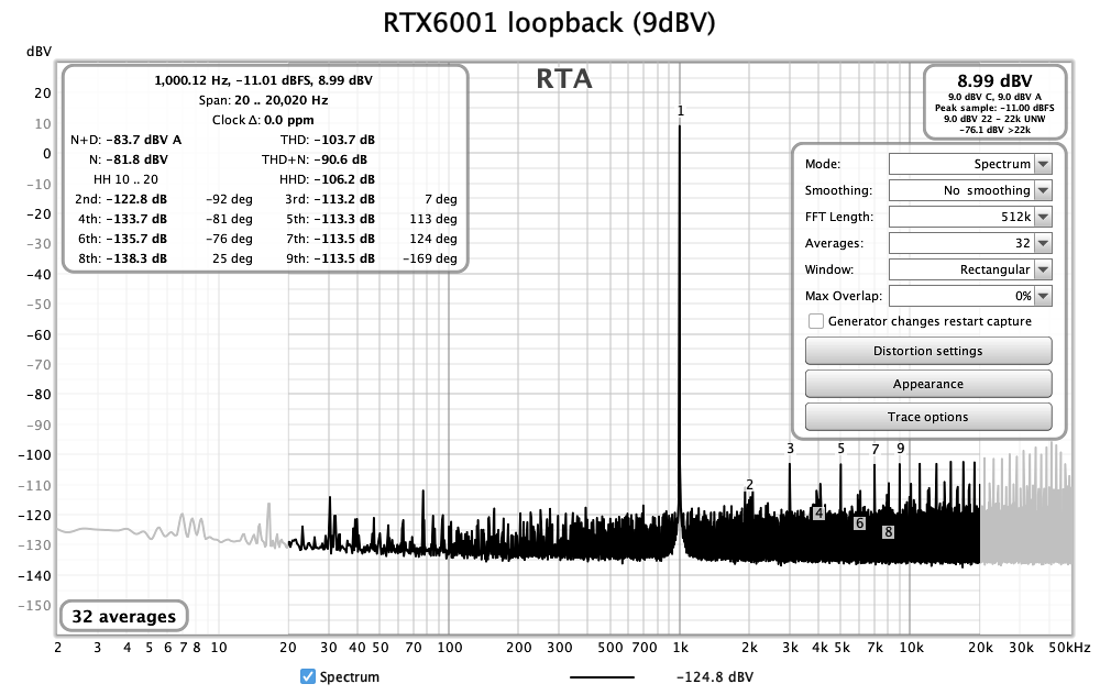

The amp operates silently with minimal noise (below 100 µV), and distortion is almost negligible (THD -100dB @ 1W into 8R). With the selected rails, the amp can deliver 30W into 8R, although I haven't extensively examined its clipping behavior as I do not have a pre-amp capable of providing the required voltage swing.
I have included an FFT plot for 1W into 8R, along with the unloaded loop-back measurement of the audio analyzer. These two measurements are remarkably similar, highlighting how close the amp is to the limitations of the measurement setup.

We have in the past been accused of being paranoid with our curve tracer matching.
But you can see in the distortion measurement posted above, especially how low second harmonics is.
This can only be achieved when you curve trace under operating conditions.
And then match to 3 coefficients in a 6th order polynomial of Id vs Vgs.
The 0th order, i.e. Vgs only ensures lowest DC offset.
The 1st order, i.e Ygs, ensures equal current sharing.
Only when the 2nd order coefficient is also identical that you will get perfect even harmonic cancellation.

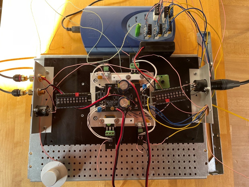

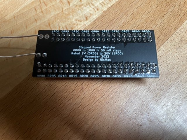

what are those comb-like things in the test rig pic?

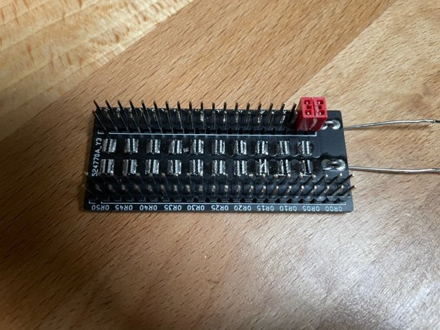

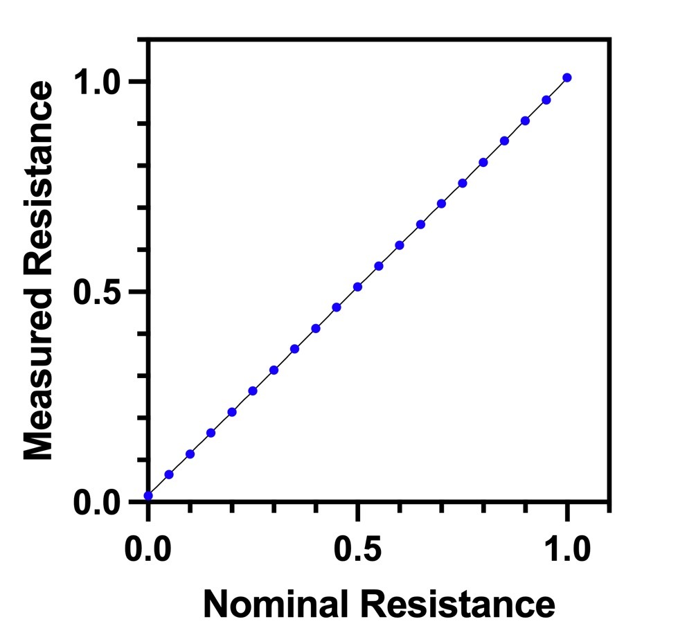

Tired of repeatedly soldering and desoldering various combinations of low-value power resistors, I opted to create a straightforward, adjustable precision power resistor. This resistor consists of a series of 20 pieces of 0.05R resistors (0612, 1W, 1% tolerance). The resistance is adjusted using jumpers, employing two to reduce contact resistance. Consequently, the resistance can be set anywhere from 0 to 1R in 0.05R increments, with a nominally rated power of 1-20W depending on the chosen resistance.
I constructed two of these resistors and verified their functionality by measuring the voltage drop across the resistor while maintaining a constant current of 0.5A. The measured resistance was consistently approximately 15mR higher than the nominal value, likely due to the resistance introduced by the jumpers. This additional resistance was found to remain relatively constant and unaffected by the set resistance value.
The variation in resistance between the two resistors across different settings was determined to be 0.12% with a tolerance of +/-0.21%.

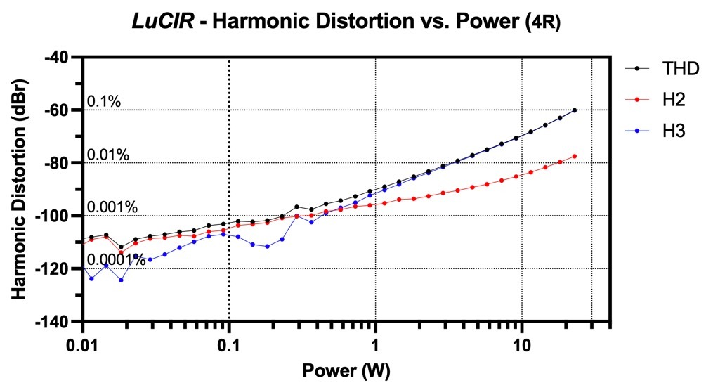

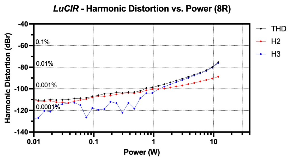

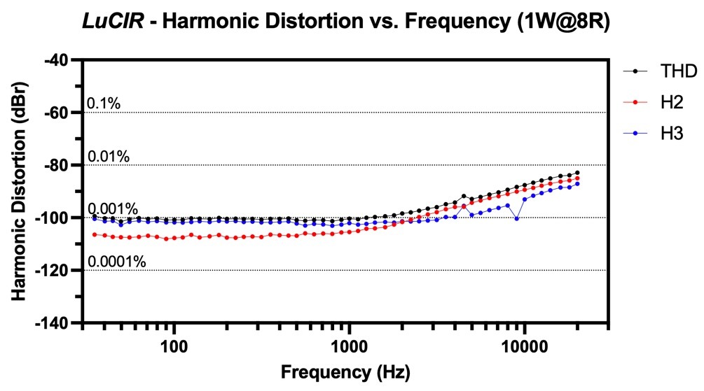

Here are a few additional measurements: THD versus power (4R and 8R) and THD versus frequency (8R). As expected, distortion slightly increases with higher power and frequency, but overall, it remains at a remarkably low level. The primary sources of distortion are H2 and H3, while higher-order harmonics have minimal impact.
It's important to note that this amplifier is not intended for individuals who are specifically concerned with "dominant negative phase H2" distortion. Instead, its strength lies in maintaining extremely low distortion across its entire operational range. This accomplishment is achieved by utilizing a minimal number of components, optimizing their performance, and operating the amplifier without global feedback.
