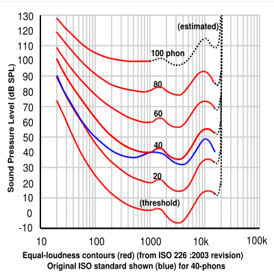

ISO 226 year 2003 revision is considered the most accurate loudness compensation curve.
Does anyone have the network modeling tools to come up with an opamp active compensation circuit that approximates ISO 226.2003?

I guess the next step would be to take the curve corresponding to the level the playback should sound like, and the curve corresponding to the actual playback level, normalise them and plot the difference.
Judging by sight, it appears that this would result primarily in a bass boost.

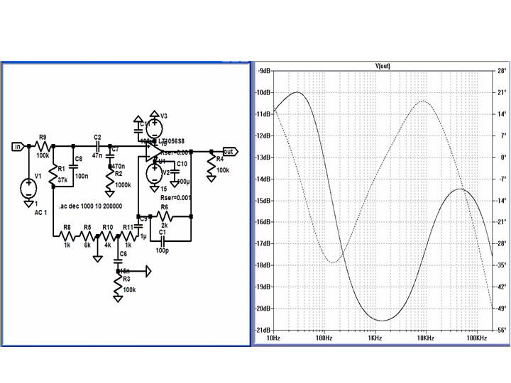

Thanks 2litre and LineSource for finding the plot.
I came fairly close by using a two-stage affair, i.e. a volume control with a 10% tap, and also another RC at the low end of the pot. That meant that the volume could not go to zero, but in practice it can be low enough.
For an effort at a close approximation I resorted to a multi contact switch - Elma makes them with 24 contacts, i.e. 47 positions counting the "short" between two contacts as an intermediate step. The steps are small enough not to be really noticable, and obviously one can design to any desired law. I ended with 4 poles in all, but impedances became difficult. I had to drive with 1K.ohm, and load with not less than 1 Meg. In the end I did not include treble compensation; it did not make an audible difference, what with room characteristics etc.
