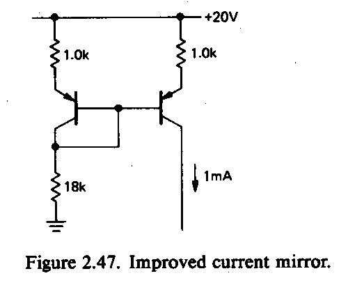

Attached are .gif images of schematics for various current mirrors including
a vacuum tube design.
CurrentMirror1 -- a bipolar current mirror with current gain of two, higher
current gain with use of more output transistors (or just use a physically
BIGGER trans. for output).

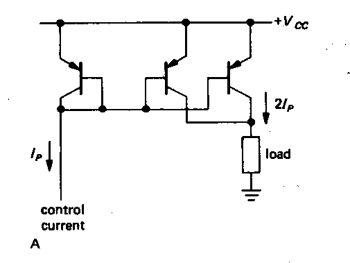

CurrentMirror2 -- bipolar current mirror, improved linearity via emitter
degeneration resistors.

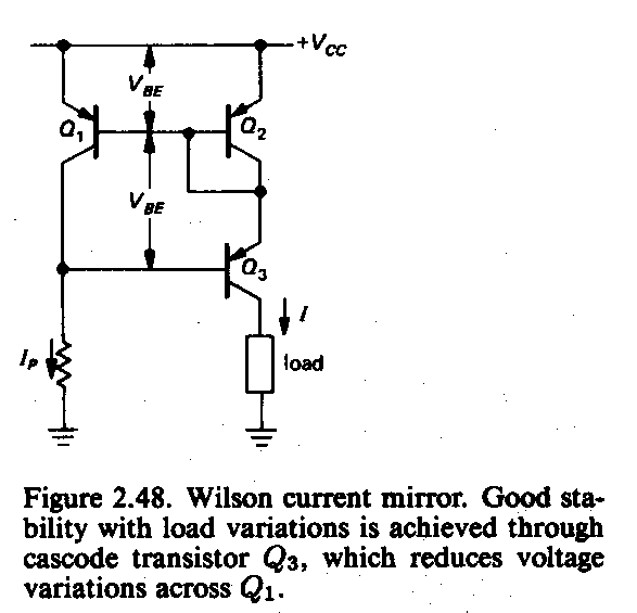

CurrentMirror3 -- The Wilson current mirror, one of many variations on the
basic current mirror to improve some characteristic or other.

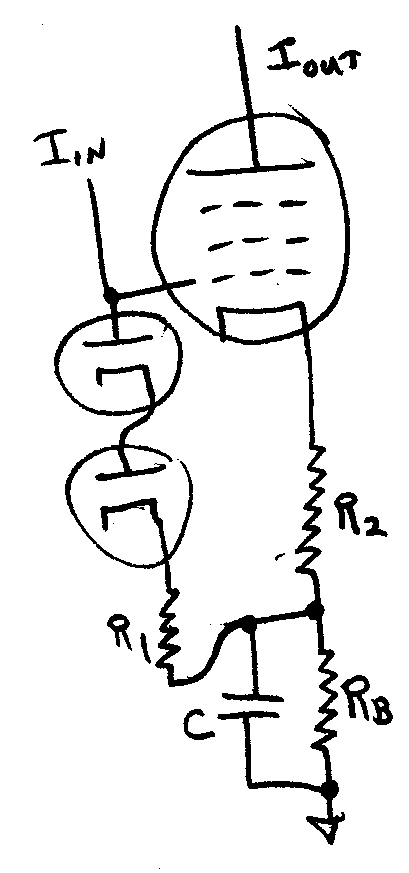

VTCurrentMirror -- the basic Vacuum Tube current mirror, the number of
diodes in series will vary depending on output tube geometry and diode
construction geometry (cathode area, and cathode to plate spacing are the
important parameters), R1 and R2 are optional for increased linearity, their
ratio must be in inverse accordance with the basic current gain ratio
produced by the diode/pentode so as to give equal voltage drops in
operation.

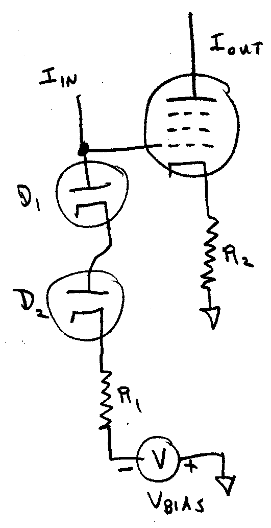

VTCurrentMirror2 -- just some biasing applied to the basic design
note: MosFets can be used in current mirrors also and their circuits are
similar in concept to the Vacuum Tube design
The basic VT Current Mirror operation is to use the diodes as a 2/3 power
non-linear resistor for input current to drive voltage conversion,
the pentode then does 3/2 power drive voltage to output current conversion,
with a net result of linear current gain. It looks simple in principle, but
a number of complexities come into play in practice. The current gain is
determined by geometric considerations between the construction of the
diodes and the pentode. Since 2/3 power and 3/2 power are non-linear
devices, they must also operate on corresponding identical (or inverse
actually) sections of their curves in order to correct each other. This
means not only the right bias points but the scaling of the two devices must
match. This scaling is determined geometrically, so not just any diode will
work with any pentode. In practice, this means stacking diodes in series to
get a close match of the geometric scaling for the pentode used. This can
require anywhere from one to a dozen or more diodes in series depending on
the tubes used. Considerable experimentation is mandatory, including a
variable bias supply and curve tracer or X-Y scope to look at current in
versus current out with a swept current input waveform. In addition, the
geometric spacing of diodes I have tried tend to be rather loosely
controlled in production, so just changing tubes with "identical" tubes can
change the number of series diodes required. A practical approach is to use
a few multi-diode tubes like 6JU8 and provide a jumper to select the number
of sections in series. Obviously, this will NEVER catch on for production
circuit designs, unless some special diodes are designed with strict control
of geometry. But for DIY, anything goes! By the way, using a diode
connected triode or pentode in place of the diodes would work in theory, and
even would allow convenient adjustment of the geometry factor by grid bias,
but in practice, the "inselbildung" or grid "island effect" ruins the
required curvature at small currents.

Yes, first off, one must get into the mindset of using current levels when using this circuit rather than voltage. Its not a suitable circuit for a high impedance voltage input stage, but more suited to intermediate or even output stages of an amplifier. So, first off, the input of an amplifier would be a voltage to current stage, at small input signal levels, before entering any current mirror stages.
The non-linear resistance on the input is not nearly as bad as the exponential non-linearity in SS current mirrors, so actual scope measurements on the input will show some voltage swing, in fact, this swing will obviously match the operating voltage swing of the pentode grid in a given design. The SS current mirrors are much more tricky to get accurate matching because of the exponential characteristic, so usually only appear in ICs where identical transistors are readily available. The V tube current mirror is actually more practical for discrete component design due to its more gradual 3/2 power law. (and a trimpot in the circuit to set grid bias level and a selectable number of diodes in series and a fair amount of patience on the designer's part!)
Since a constant current gain is enforced, the input current will be simply related to the output current by this gain factor.
I have gotten current gains up to around 97 using a 9KC6 pentode (+13V on G3, 100V on G2) and 6x series 6JU8 diode sections. Using 9006 diodes about doubles the gain yet versus the 6JU8 diodes. What voltage appears on the output of course depends on the load resistance (at least for a pentode with sufficiently high output resistance spec) times the current.
Higher current gain comes from using a smaller diode and higher gm pentode. Too small a diode however may get one into noise problems if the current draw is too small. The more series diodes one has to use to get the scaling correct, the higher the input (avg.) impedance will be and hence the input voltage swing for a given input current swing, but this is not a freely adjustable parameter.
When thinking in current gain mode, instead of voltage gain mode, one actually would prefer the input node to be low impedance so it doesn't swing around and affect the previous stage's output resistance. Only the last output stage reverts back to voltage swing into a load. So an "ideal" current mirror amplifier would see no voltage signals whatsoever internally (Notice that this KILLS Miller effects nicely!) , just on the output. Of course, having a pentode for output with very high output impedance is another problem, so usually one would put a cathode follower, or similar, on the output to lower output impedance or use negative feedback to lower Zout.
