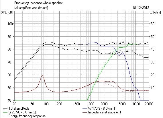

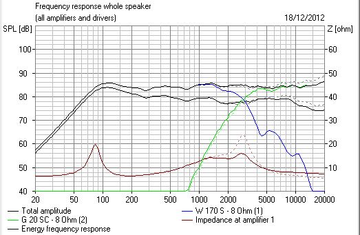

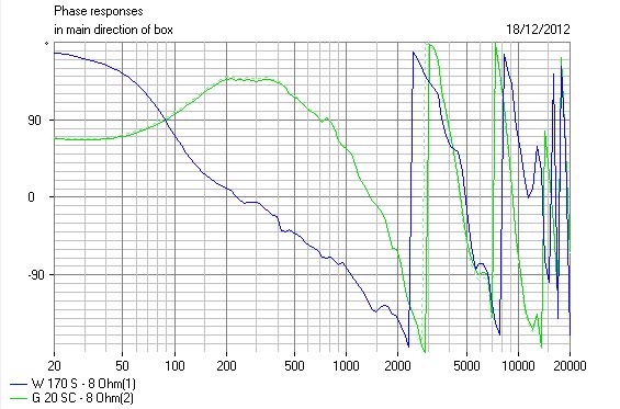

Let's reiterate why time-alignment is a GOOD THING. Just give me ten uninterrupted minutes to finish three easily-digested posts here, which will reinvigorate this topic I hope. 😎

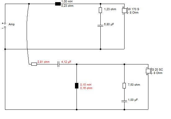

First a nice conventional crossover on 6" bass and fabric 1" tweeter. This sort of regular speaker roughly speaking. Good phase and frequency response and a lack of cone breakup thanks to a cunning notch on the woofer.

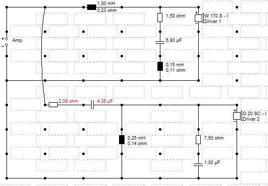

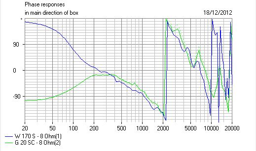

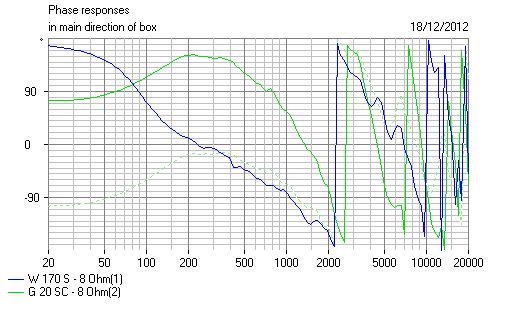

Now let's do something unexpected and neat and turn the speaker upside down. You also need to do something else. Which is wire the tweeter out of phase...
Here's the neat thing, because the crossover point is about 3kHz, you need to listen at a point above axis which effectively sets the tweeter back about 5cm, which corresponds to half a wavelength. You then get an interesting resolution of detail which sounds nice. This is simple time-alignment and you can try this at home.
Below is the new frequency response and phase. Quite acceptable, even if I like more tracking of phase.

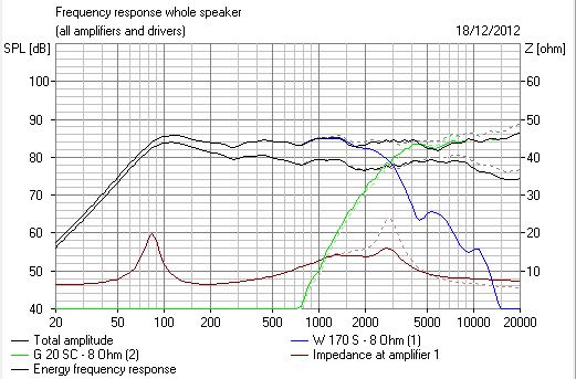

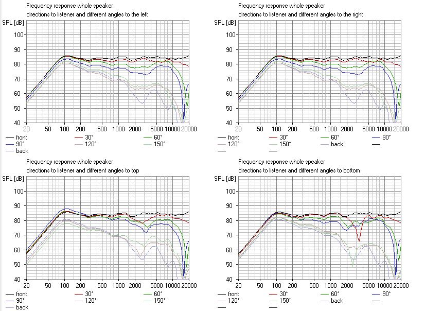

Now let's go the whole hog and design a speaker roughly like Joachim Gerhard's excellent Sonics Anima time-aligned speaker. I'll do this with a simpler filter and paper woofer and softdome tweeter.
Below is a much simpler circuit which really works best with well-behaved drivers like plastic polycones. It's roughly 4th order acoustic. Phase tracking is good. Time alignment is good. Frequency response good too. You could even try first order filters, which actually end up between 2nd or 3rd order acoustic. My only criticism is the higher woofer cone-breakup showing its face, hence I suggest a polycone is best for this sort of simple filter. It's your choice. But there IS something in it. 😎
The last image is lobing. You can see there is a sweet spot above axis.
