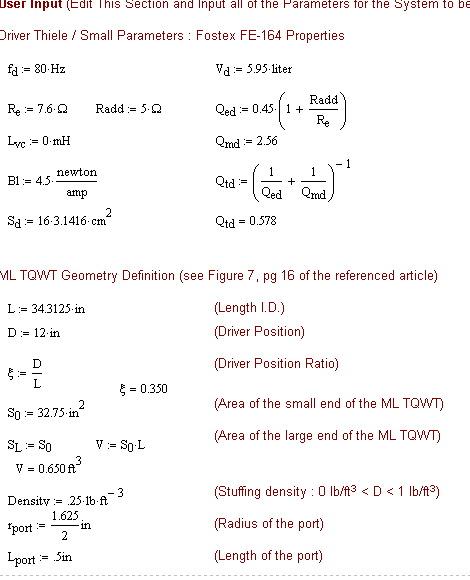

I did put an equation into the worksheet to re-calculate Qts, but I got a different number, so I'll check my formula.
[Added a few minutes later] Actually, I just copied the formula from a worksheet on Martin's web page. The worksheet is for the Fostex fe206e. (Of course I changed the original Q to the one for the fe107e.)
Here is the formula:
Qed' := Qed*(Re)*(Re-Rs)**-1
Is that right?

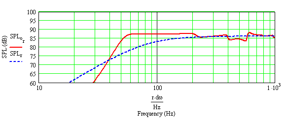

>I think I have the Qes figured right now, and I put in the numbers exactly as you said. Here's the function, assuming a total added resistance of 5 Ohms:
Hmm, don't know what you're doing, but you're not getting the right response. Notice that the IB response hasn't flattened out so it's not plotting the higher Qts response, ergo the higher Q vented response.

GM said:Hmm, don't know what you're doing, but you're not getting the right response. Notice that the IB response hasn't flattened out so it's not plotting the higher Qts response, ergo the higher Q vented response.
GM

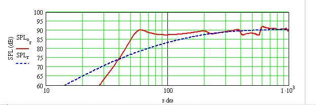

It actually is flattened out a little bit, but very little. I'm probably not calculating the new Qes correctly. See the attachment.
Yep, now it looks like mine. I have the same problem with Mathcad too, but I just assumed it was my machine since it's so outdated 'n slow.

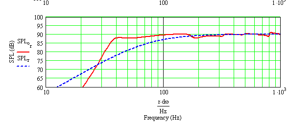

Rather than doing a stretch Locust 34 inches tall, it would make more sense to do an even taller floor-standing speaker using the fe127e. That one has a lower Fs, higher Qts, and bigger xmax.
GM, would you care to try your magic on that one?
I'll give you something to shoot at:
At a glance, I doubt I can improve on it without going large flared. I did an extended max flat alignment awhile back for someone that a false bottom filled with kitty litter/whatever can be added to get the driver up high enough, but AFAIK it wasn't built:

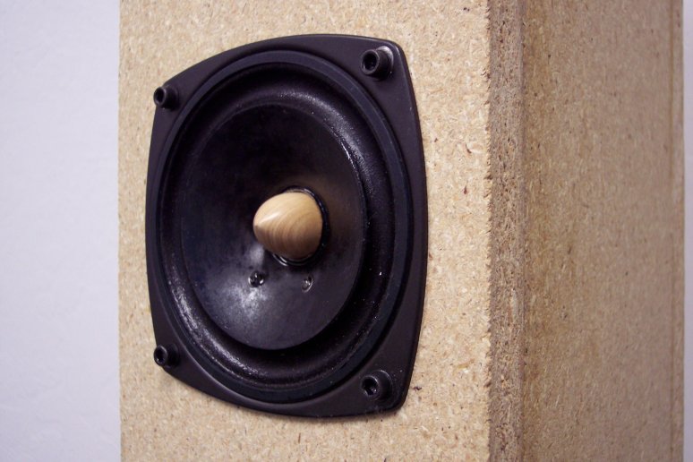

The phase plugs arrived and I installed them. I did one side first and listened A/B. The plugs made a very distinct improvement. Not only was the treble distortion almost completely gone, but even the bass seemed to be better defined. I did the other side, then listened to them a long time last night. I think these little things may be sounding about as good as the Ariels now.
