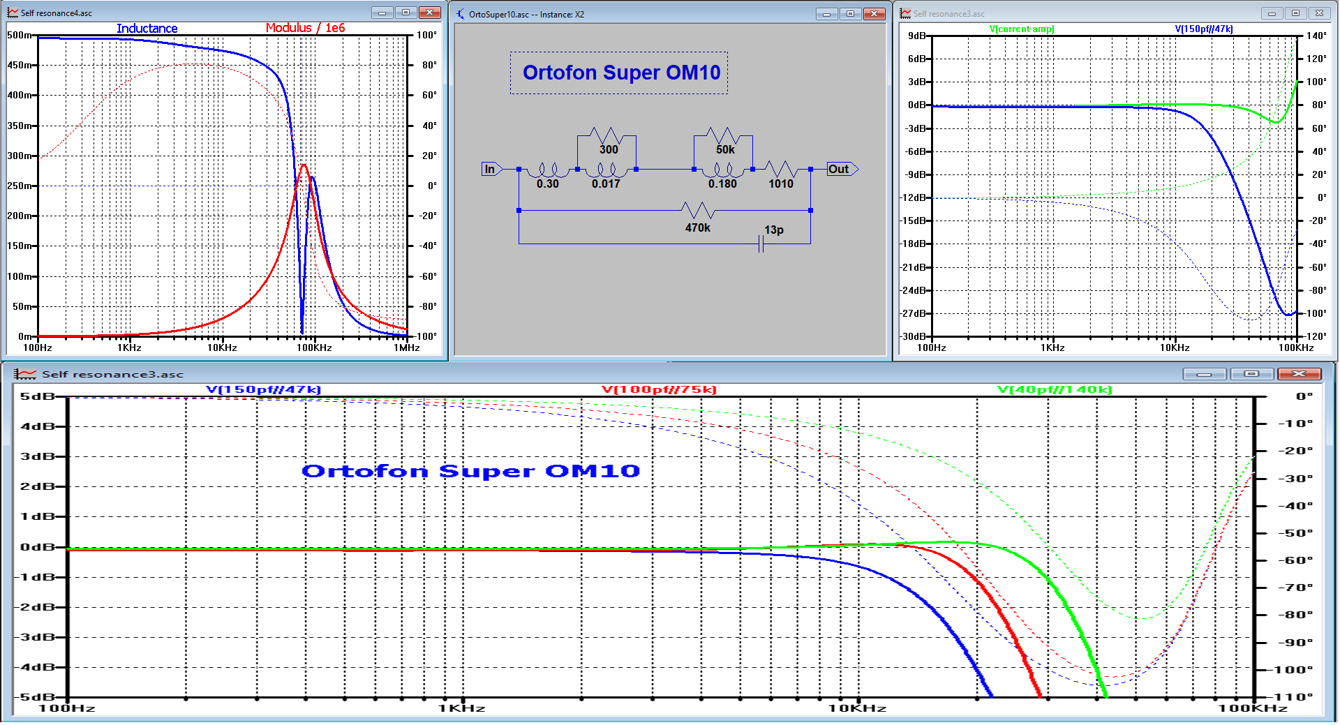

It is a shame you can't electronically brake a cartridge. Attached is one of Hans measurements from the cartridge dynamic behaviour thread. the first graph and the equivalent model are the interesting parts. This is for an Ortofon superOM as an example of a relatively well behaved generator.
I'm not talking about magnitudes either, I'm just taking the reciprocal of a complex number and then calculating the real part. Suppose B = -1 mS and G changes from 0 mS to 1 mS. G/(B^2 + G^2) then changes from 0 ohm to 500 ohm, so it doesn't get smaller at all. If you keep increasing G, eventually G/(B^2 + G^2) will tend to zero again, but we were discussing the effect of a parallel conductance with a finite value, not the limit for infinite parallel conductance.

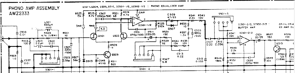

Other than headroom limitations, anyone want to comment on this design? using the LSK489 as the input in front of a LM4562?....
Many-many Japanese flagship Hi-Fis used essentially this plan, albeit with their own house devices.
OK, Pioneer A-757 by my side put the RIAA in the first loop, then rumble then a final fix-up stage.
Headroom is not an issue in the LSK-487 plan, it only takes flat-gain of 10 in front. There's not really over 100mV from any music in your grooves, and the opamps have near 20dB over that.
And a JFET frontend will tolerate that 0.1uFd input cap (which may be virgin parchment or other exotic). A BJT will rumble like a pack of B-17s with that much impedance in its Base loop. (I have seen BJT 1/f noise from too-small C1 trip woofer protection.)

Hello PRR
That's an interesting circuit snippet. It's obviously designed to handle both MC and MM inputs, hence the ingenious gain-switching as well as the FET input devices. I note that the RIAA upper roll-off is wholly passive. (R541, R543 and C515) I am however slightly puzzled by L501- it seems rather big for an EMC component.
I should have mentioned that. I once understood most of it, but rarely use it now, and only at MM-flat. It is VERY impressively built inside, and while I know form from function, I just accept that some Japanese Geeks sliced and diced every detail to their satisfaction (or budget limit).
I have seen a similar ploy, reduced to two 10-cent FETs and a 13-cent chip, in some very low-cost phono stages. It can give a published noise spec better than a 2-buck chip. That might swing a sale.
If you read a lot of schematics, you will find the composite amp plan used a lot.
I still like 2-transistor (no chip) RIAA (albeit with a Darlington in the 2nd stage) but that's just me.
