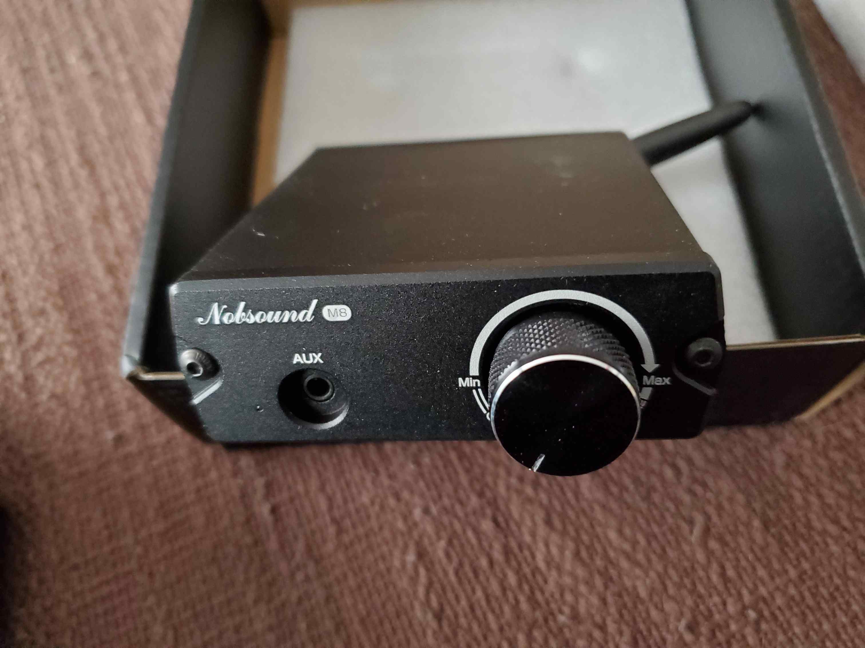

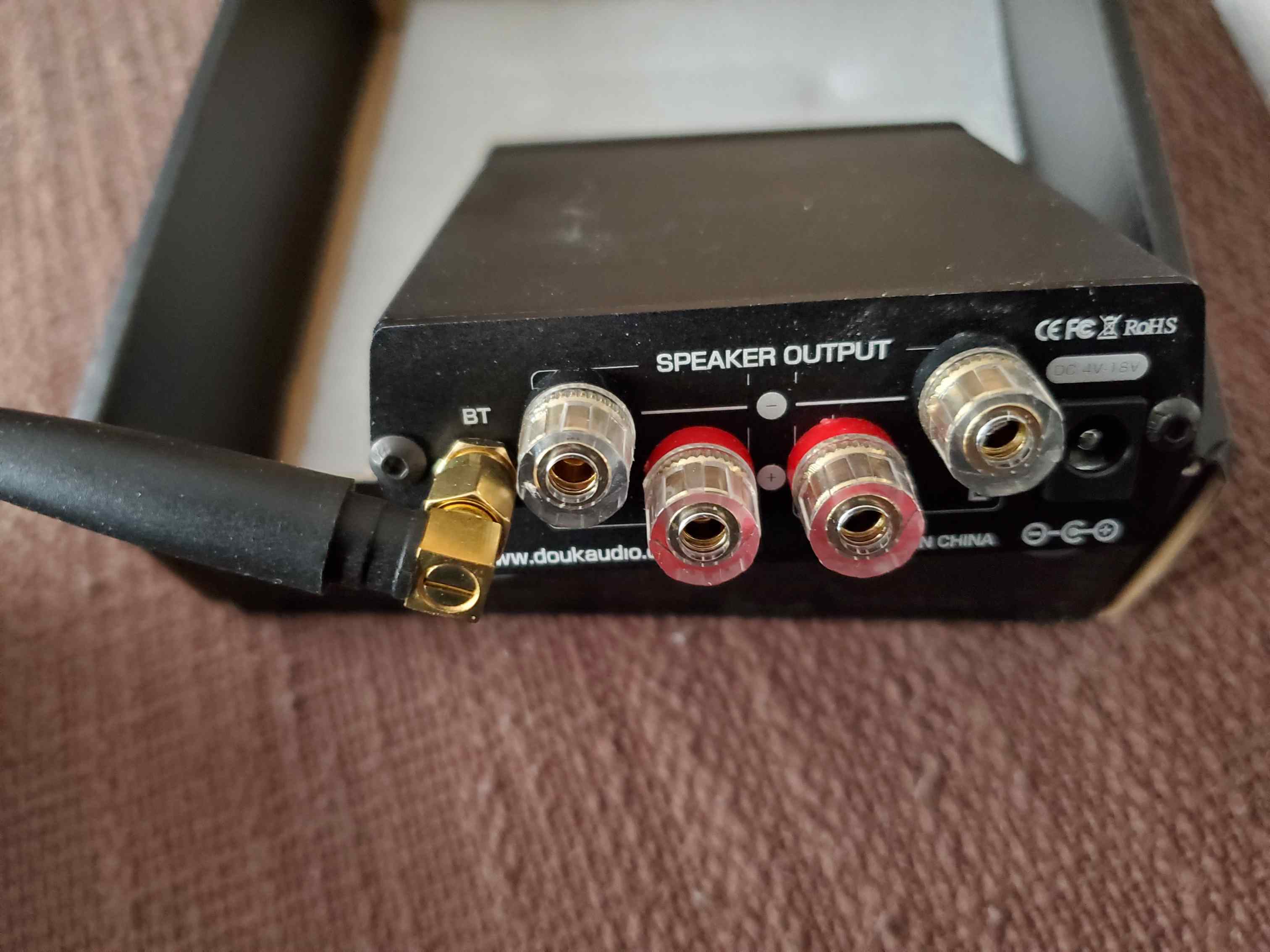

I bought the MA12040 version sold in an enclosure and connector in addition to bluetooth. This one comes from ebay and the seller Douk.

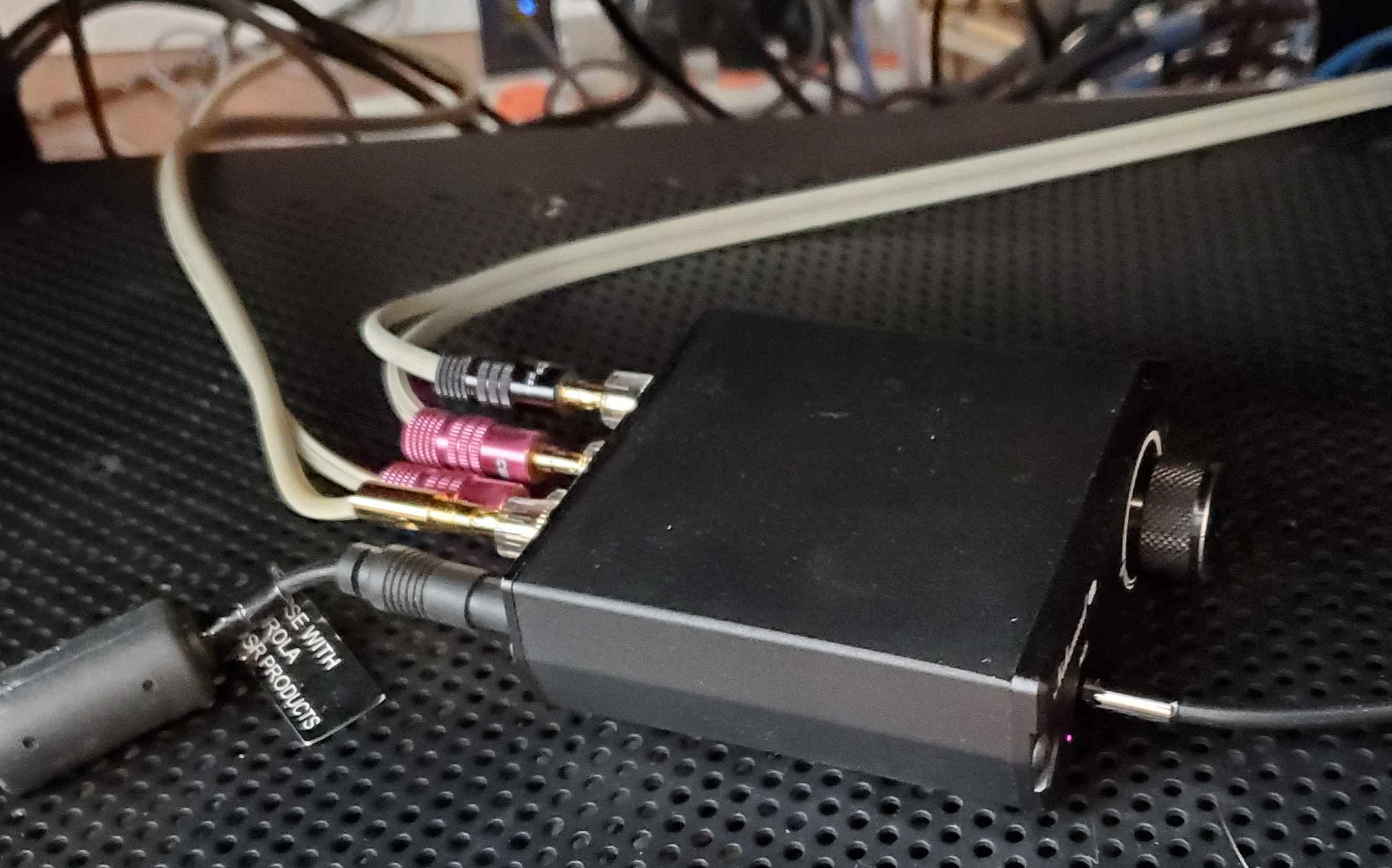

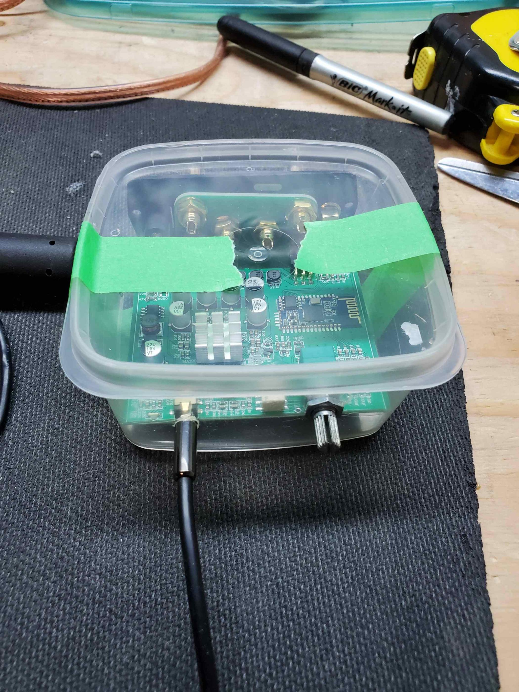

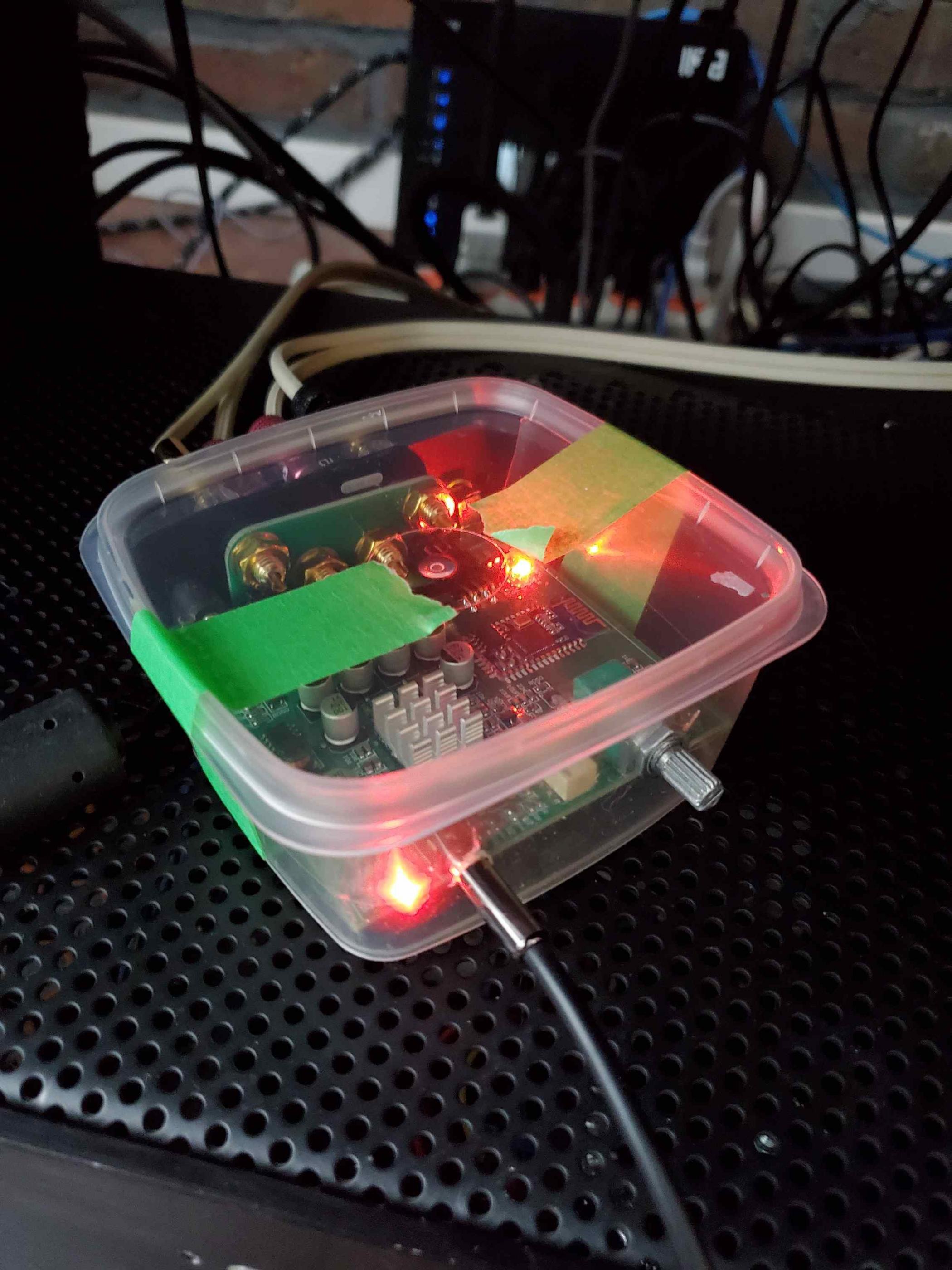

The plug is of 2.1 format and not 2.5mm.
I compared with DC sockets of the 2 models that I have in stock. The problem is the diameter of the case at the ground which is too small, so the DC sockets do not fit properly.
It's not the positive bar that's too big.
So I soldered the DC wire directly to the PCB, and installed in a new recycled plastic box. This is temporary for the time of testing.
Then I will connect in bi-amplification, if the sound is good, I will order the MA12070 PCB and put it in a real box.

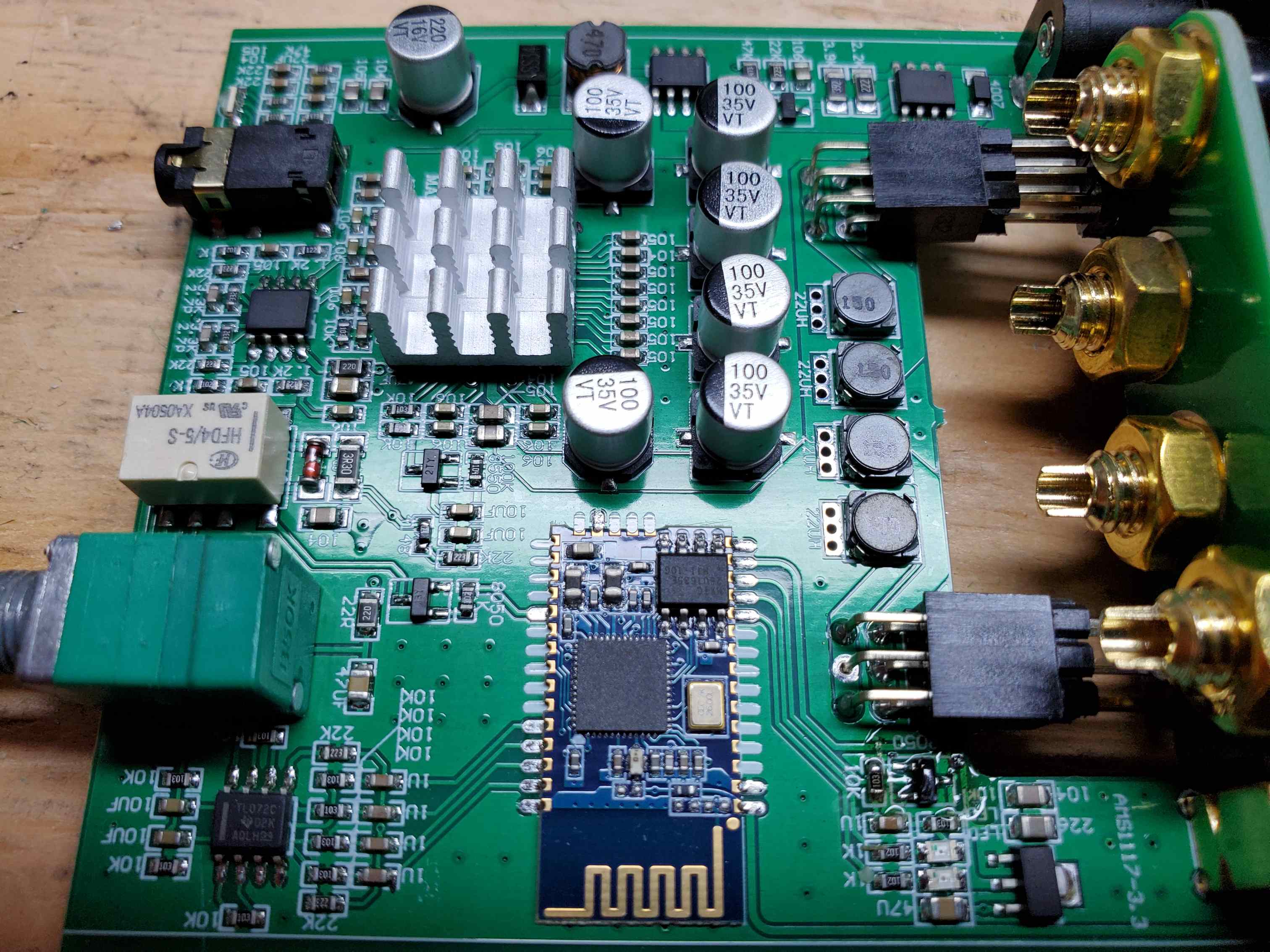

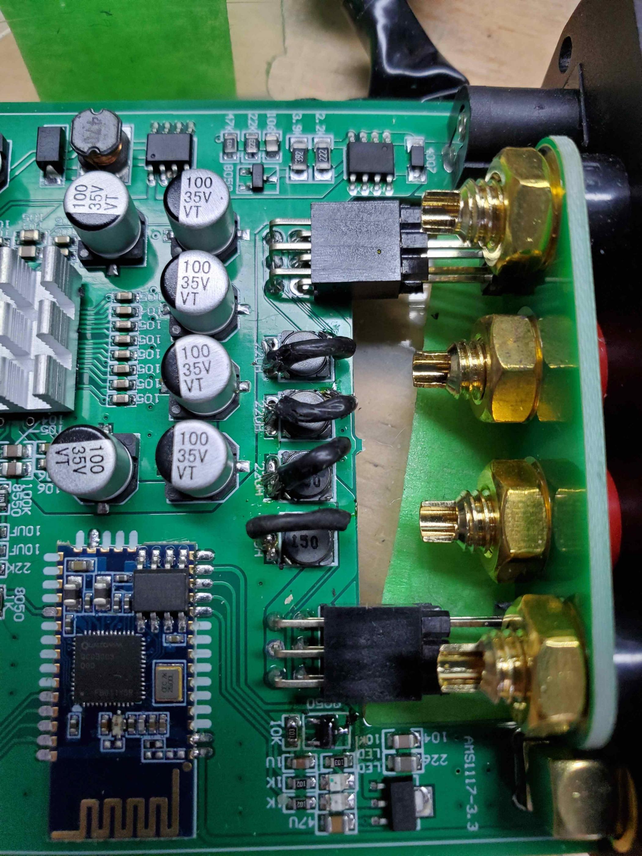

Hi everyone,
I wanted to start by changing the coils of the output filters to bigger ones. The ones I have have a resistance of 1.4ohms, while the ones on the pcb are smaller and make 2ohms. It is a 6db filter and not 12db as usual. But before changing them I decided to do a test and bypass them with a filter. So there was no EMI filter, on my system it seems ok and so far does not seem to interfere with other devices ..
I was shocked by the improvement made at all sound levels. My setup is simple, I did not use my DCB1 preamp, so the AK4497 DAC is plugged directly into the amplifier via the RCA outputs, the XLR outputs are plugged directly into my sub studio, I left unplugged for listening tests. Also I usually have a class AB amp on the woofers in a TL cut at 900hz and the MA12040 above 900hz. But for the comparison tests, there is no sub and no bi-amplification, so in fullrange.
The image has gained in depth, the dynamics are greater. There is more definition, the percussions slam like whips, the midrange and low midrange have gained in volume.
The soundstage is truly 3D, the musicality is warmer with several types of music.
Next test, I will change the coils for the air coils. I'll get back to you later.

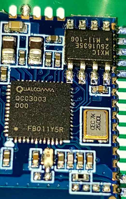

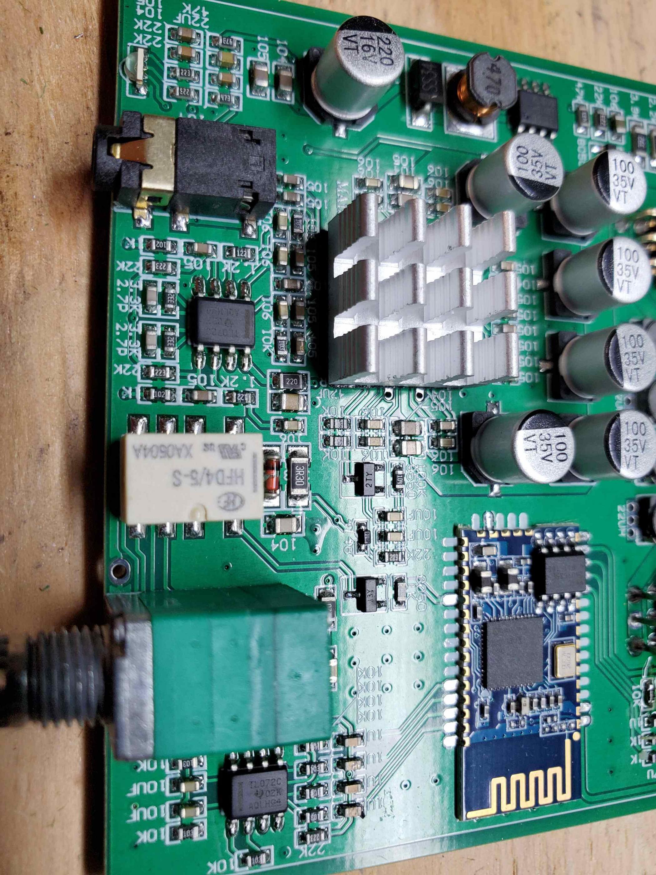

About the input OPs, there are 2, 1 for aux input and another for Bluetooth. The current dual OPs are TL072x in DIP8 format. I will install a support to switch from DIP to SOIC8, so I can put other OPs that I have in stock, I have several LME, OPA, MUSE ... etc.
I have a question for connoisseurs, for the change of the OP DUAL, are there any compatibility parameters or others that I have to take into account ??

From what I could see in the picture. It seems the filter is only a coil rather than the more common coil and inductor. Is that correct?
A torodial coil would help with EM reduction.

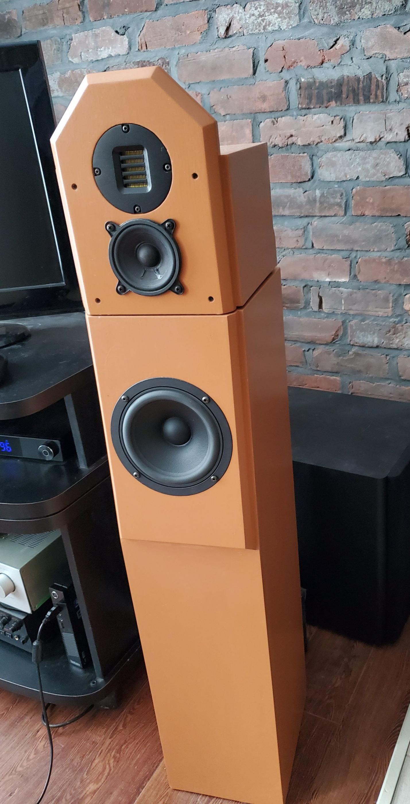

For my own sets, I have been using 3FE22 all the way to the top. And an additional tweeter to fire at the back.
Is your tweeter dipole?
Oon
Oon

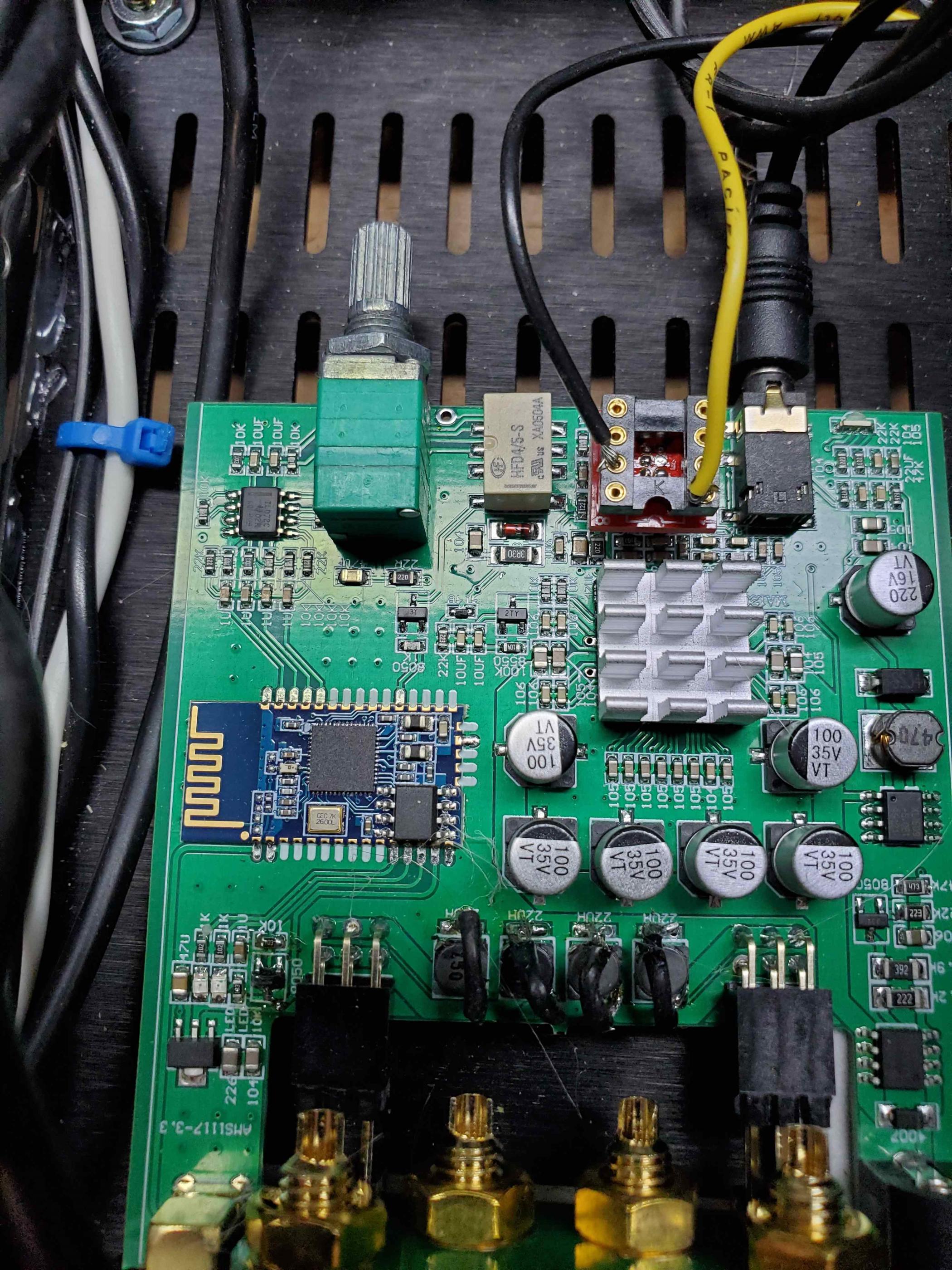

Yes it's just a coil, without capacitors in parallel on the ground. You can see it in the photo, I solder bypass wires on the coils. It is noted for toroidal.
I ordered an adapter from DIP8 to SOC 8.
The tweeter is not dipole, if I put a board that goes up it is to visually clear the speaker in height. The 3FE25 is installed, I had to make a good rear chamfer because of the larger of the magnet. The 3FE22 is better at this level ... rabbit ears and the space around it is not famous, it is designed to be screwed from the inside ... but not too serious a blow installed.
Denis
Denis

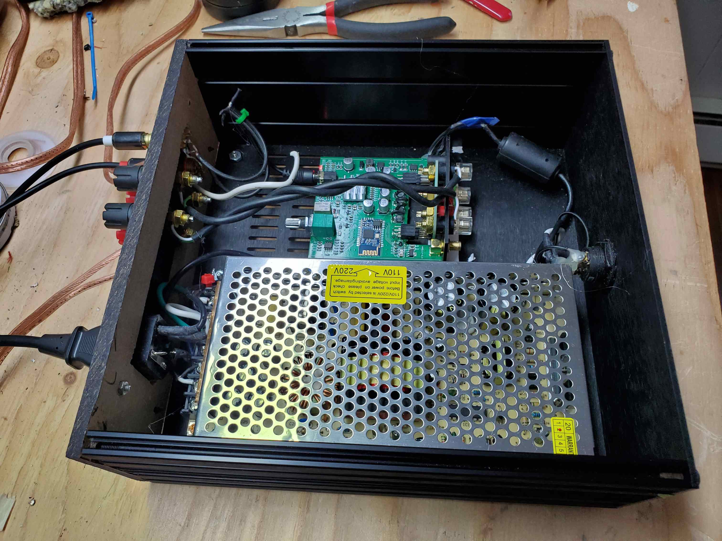

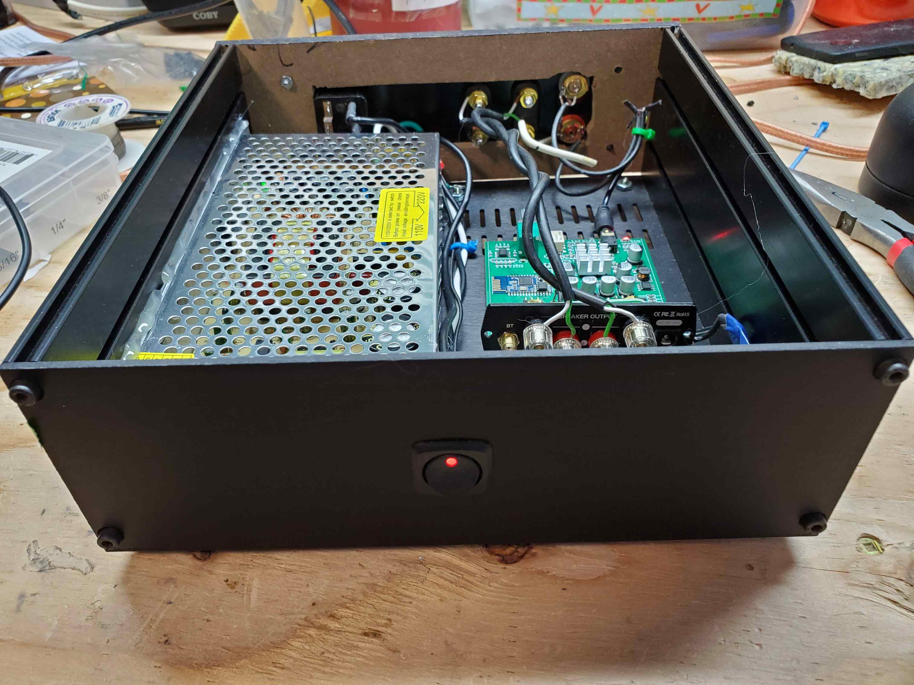

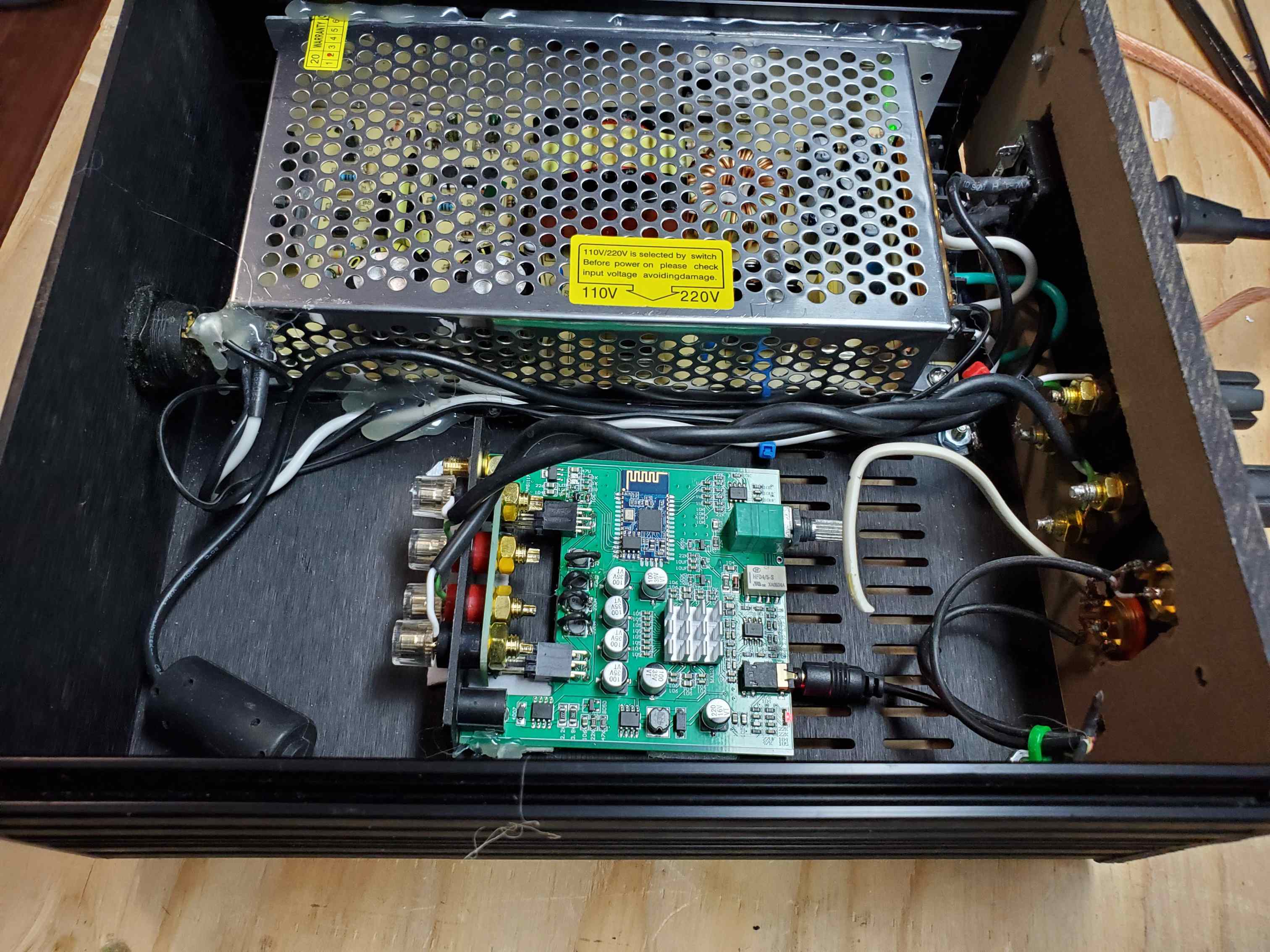

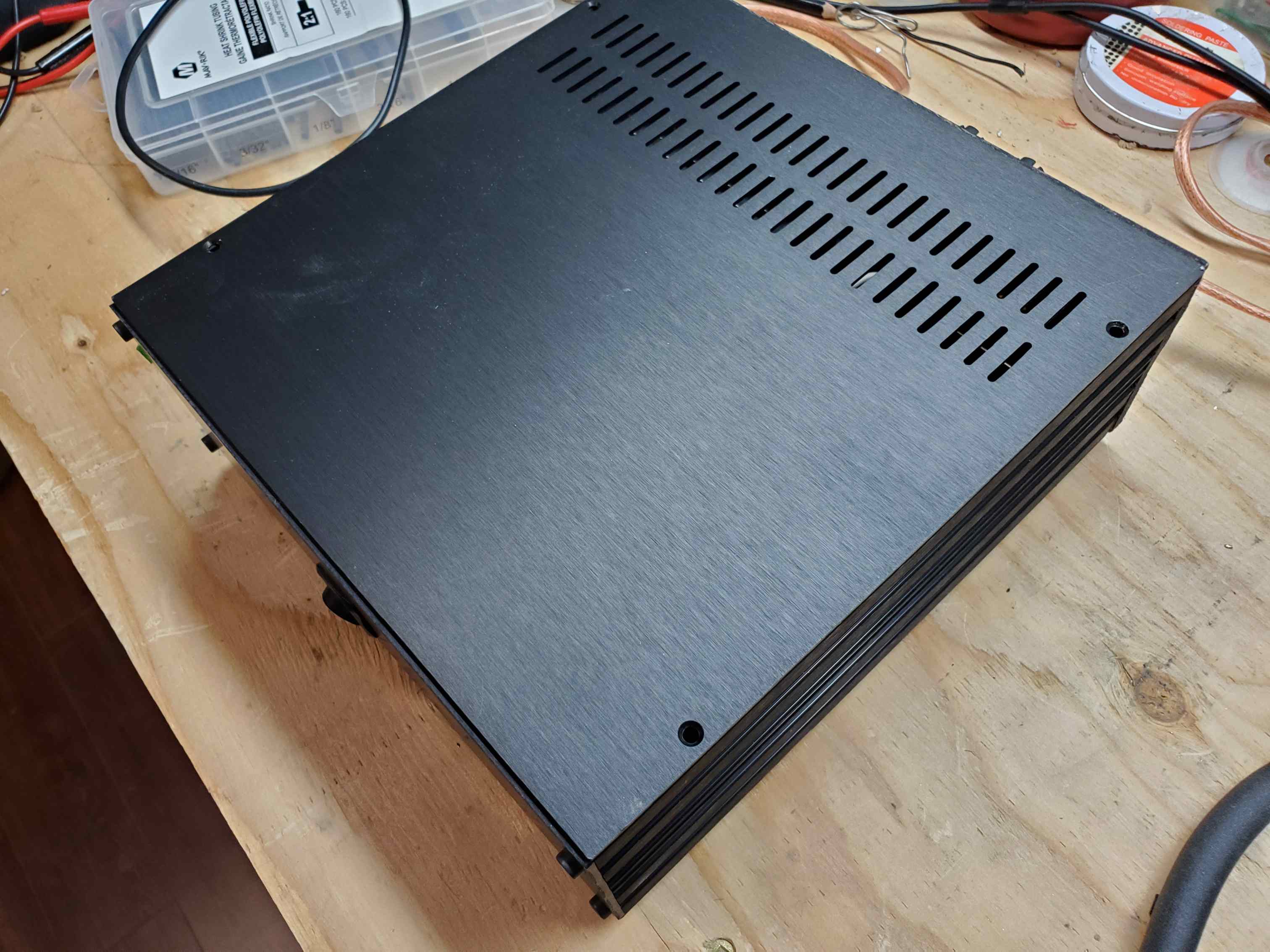

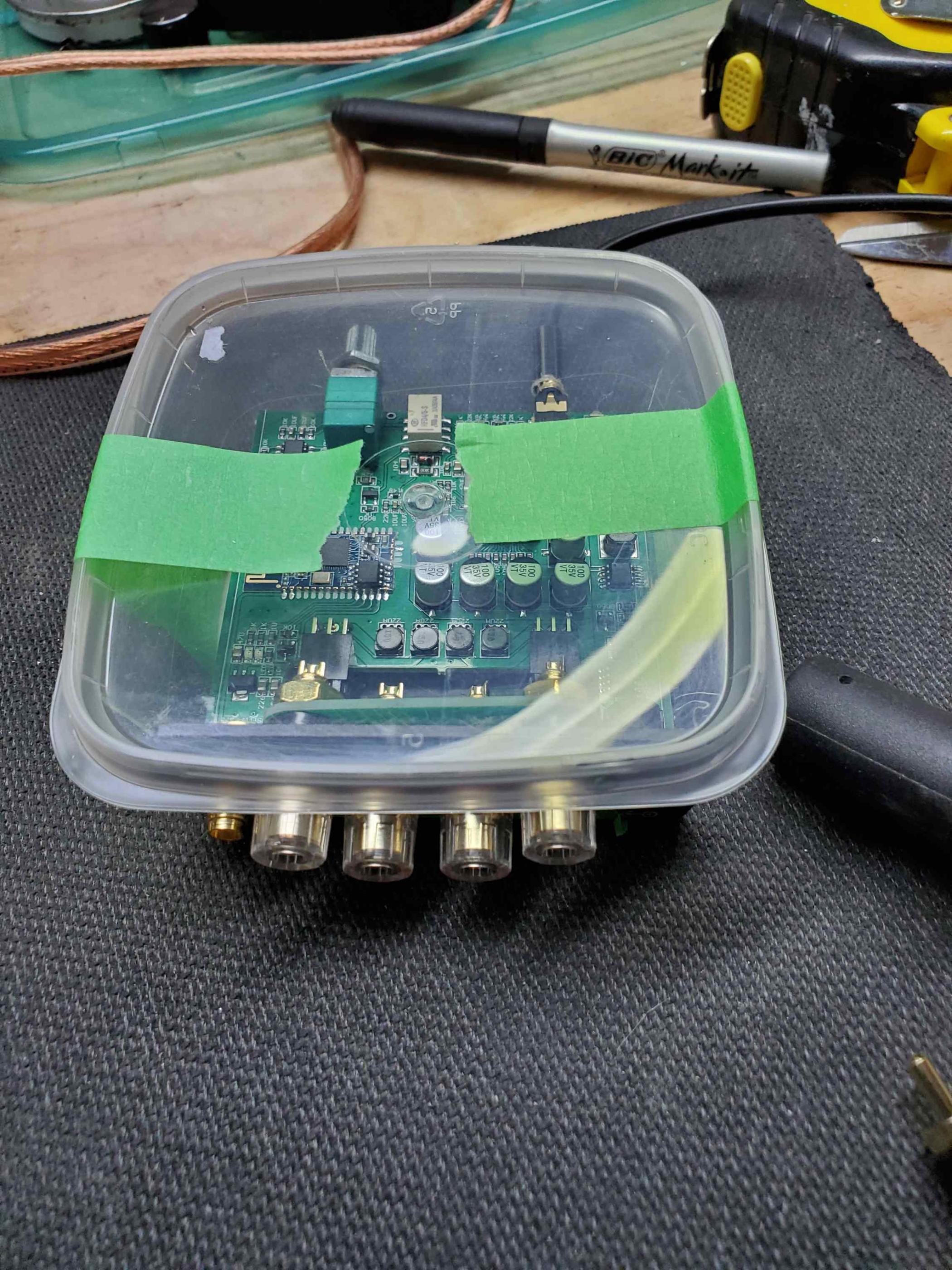

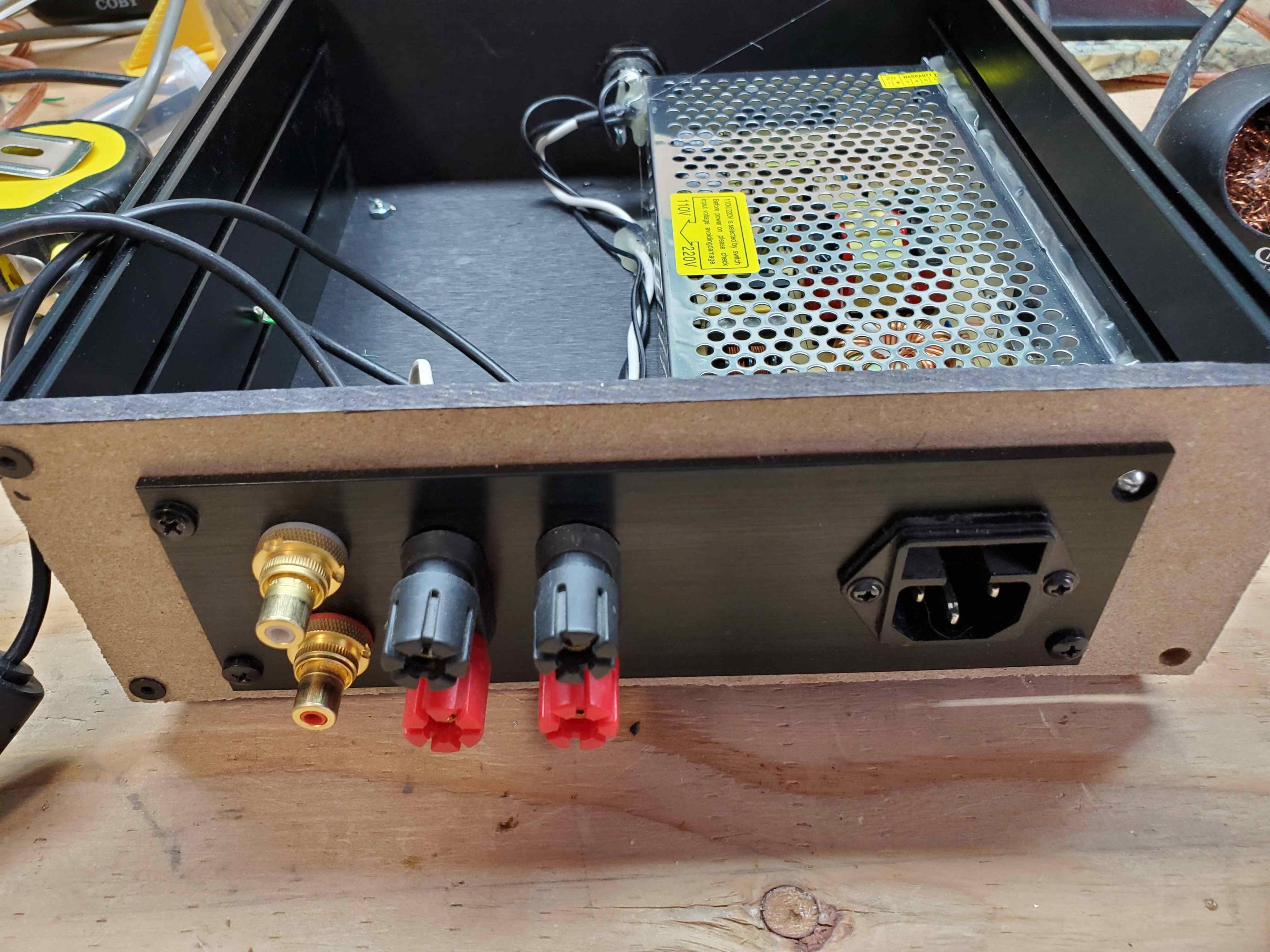

Hi everyone,
I have assembled the case with a new 18vdc 90w SMPS. I adjusted the voltage to 17.5vdc.
I used a box that was given to me, but without the metal backplate, so I used a plate with connectors from another amplifier (with a board of MDF).
The SMPS entered fair enough. I am waiting for the adapters for the OPs.
I put Velcro underneath the PXB for the modifications
Here are some photos.
Denis
Denis

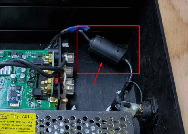

It's a ferrite core.
You use it usually to filter and damp a little bit the high-frequency noise which is thrown from the amplifier switching back into power-supply cable to keep EMI under control.

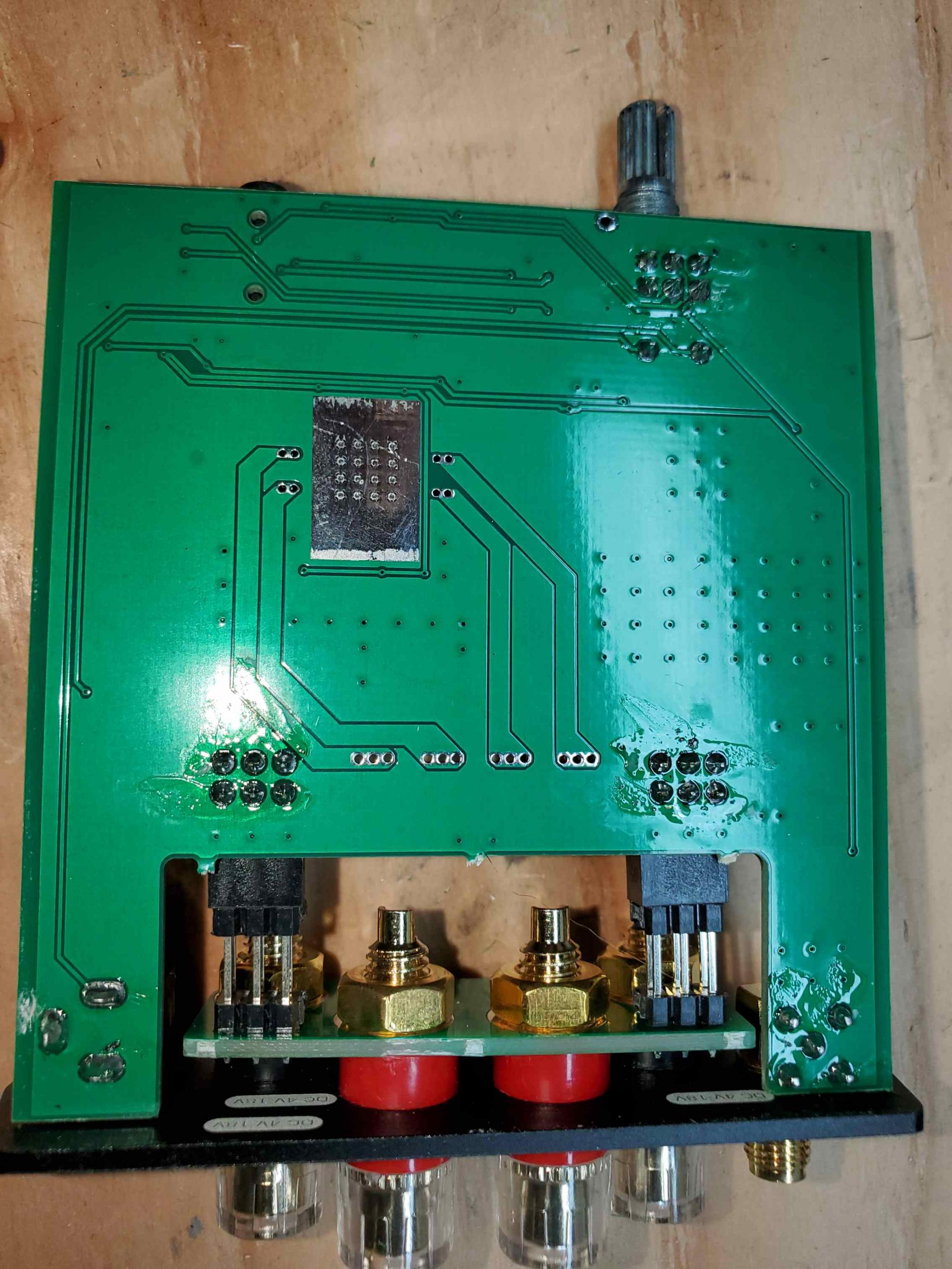

Hi, little update.
I replaced the OP with a stand, but it was not a good fit and my eyesight is not very good, so I am waiting for a new one with slightly wider legs.
I took the opportunity to connect the signal wires directly to the output of the OP via the support.
The sound is even more dynamic and transparent, and the bass is more powerful. The soundstage is even higher and the musicality has gone up a notch.
The lower midrange has more body. Usually I put in bi-amplification, but for now it's perfect
