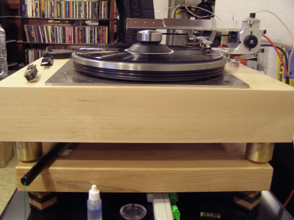

Very cool. Give us some detailed description now that you have posted the pictures. 😀
The arm looks very interesting and the whole thing looks like it was executed with a high degree of care.
Appears your tone arm has an air bearing?

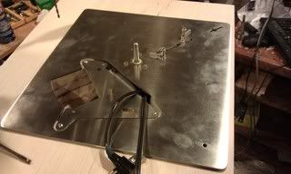

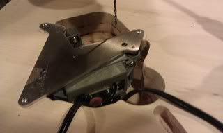

A friend had a Lenco L75 which had been unused for decades. I bought it and held on to it for a couple of years while I plotted what to do. Lenco Heaven was my major resource. I reasoned that if I purchased the top plate from Peter Reinders, I would be able to dispense with the laminated plinth, which would simplify construction and possibly yield a better result. I like maple, so I purchased a 4" thick maple block from Timbernation. I milled it out on my drill press using forstner bits. I did a lot of soul searching about what arm to get and decided on the Trans Fi Terminator, which is a linear tracking air bearing arm.
I was very fortunate that the idler wheel had no flat spots nor had the rubber gone wonky, and the motor was dead silent. So, once I got the motor springs and wiring sorted out, no noise. It's a wonderful turntable.
Lencos have an unusual drive system. All aspects of it need to be correct. The geometry of the idler wheel is crucial. If not tangent in both vertical and horizontal planes, it emits a scrubbing noise which will be clearly audible. Mine was way off! It is very easy to remedy, however. The motor springs cannot be bound up, and the motor power wires must not be pinched between the motor and the plinth. Once those issues were successfully dealt with, no noise from the motor.
