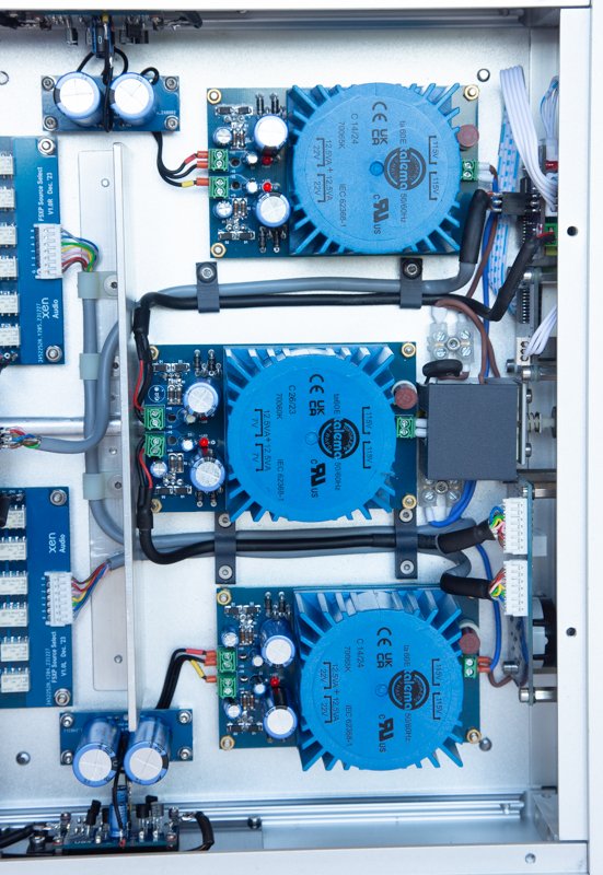

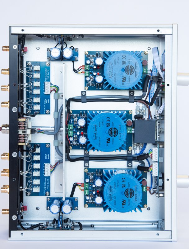

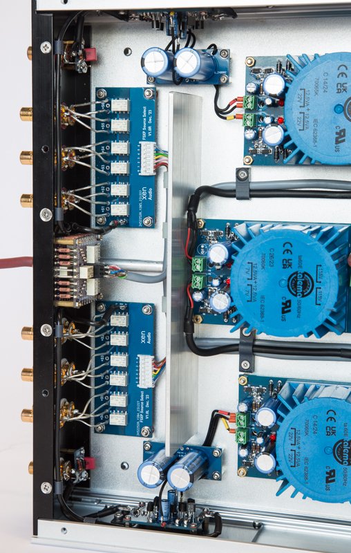

This lovely preamp is currently sitting in my system here, with a planned audition with some friends tomorrow.
I thought some internal pictures might be of interest.
As outlined earlier in the thread, there are independent power supplies for each channel, and then a third PSU board provides for the source select and attenuator. All signal paths are kept as short as possible, and as far away as is practical from the AC side of power supplies. Control cables for attenuation and source select run from the front panel to the respective boards towards the rear of the amp which also helps with keeping cable runs short.

Actually the basic layout is the same as the F5 Preamp :
www.diyaudio.com/community/threads/the-f5-preamp-2024.419289/
And very similar to our Preamp for Le Monstre :
www.diyaudio.com/community/threads/preamp-for-hiraga-le-monstr-2024.421562/
The difference is that while the F5 Preamp uses a custom-designed Chasing-LED indicator for volume settings, the Kaneda 168 has a much simpler 3-digit 7-segment LED display.
This is made much easier for people without access to milling machines by the BZ3207 case.
We only need to design PCBs to match the front panel.
