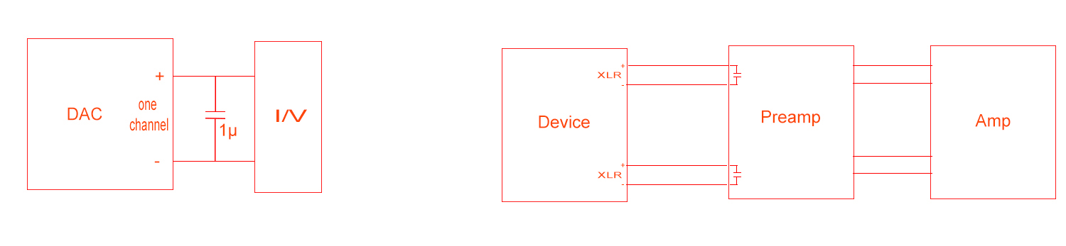

This is the schematic for placement of this cap in two different situations. If used in the both positions in the same chain, it seems to improve the effect even more, and it allow somehow to control the soundstage space, or "shape", or so (see my first post for descriptions).
For me it works in a appropriate way, on DAC using this 1µ cap. Just pure and simple placed so over the +/- lines. In preamp is a different C value, but identical and similar placed for both channels.
The cap value is to be experimental established, because is function of the device configuration, as many other variables from case to case.
On DAC I could detect this effect when using very different values, started with few hundreds pF, and ended with this 1µ, which I appreciate it as giving me a right space/effect on the soundscene.
One may note that the presence of this cap it have not so ever influence on the signal`s high fidelity, but the only audible effect is when about the soundscene, and the precision of the sound elements positions in it. While without this cap in place the positions of the sound elements can be located on the two speakers locations, in centre and quite difuse in between centre and one or another of the speakers, with this cap in place, the locations of the sound elements become more accurate, precise and even better placed in space (far/near). Just amazing it become this soundscene when it consist of moving sound elements.

Coris, can you measure (and compare) frequency response when effect is established by cap in DAC and when it is done in preamp? How many dB down you get at 20kHz in both cases?
Well, not just easy task to do it in my particular case, but I will try it one day...
The DAC I use this effect for is included in a whole device, difficult enough to isolate it and measure it in details.
In my experiments I have measured the DAC device XLR outputs levels in two situations, using two cap values on the DAC output channels: 1µ, and 2µ.
Here are the results:
C1µ
1khz - 6,11Vpp
20Khz - 4,90Vpp
40khz - 4,94Vpp
80khz - 5,35Vpp
C2µ
1khz - 6,11Vpp
20khz - 4,90Vpp
40khz - 5,11Vpp
80khz - 6,03Vpp
