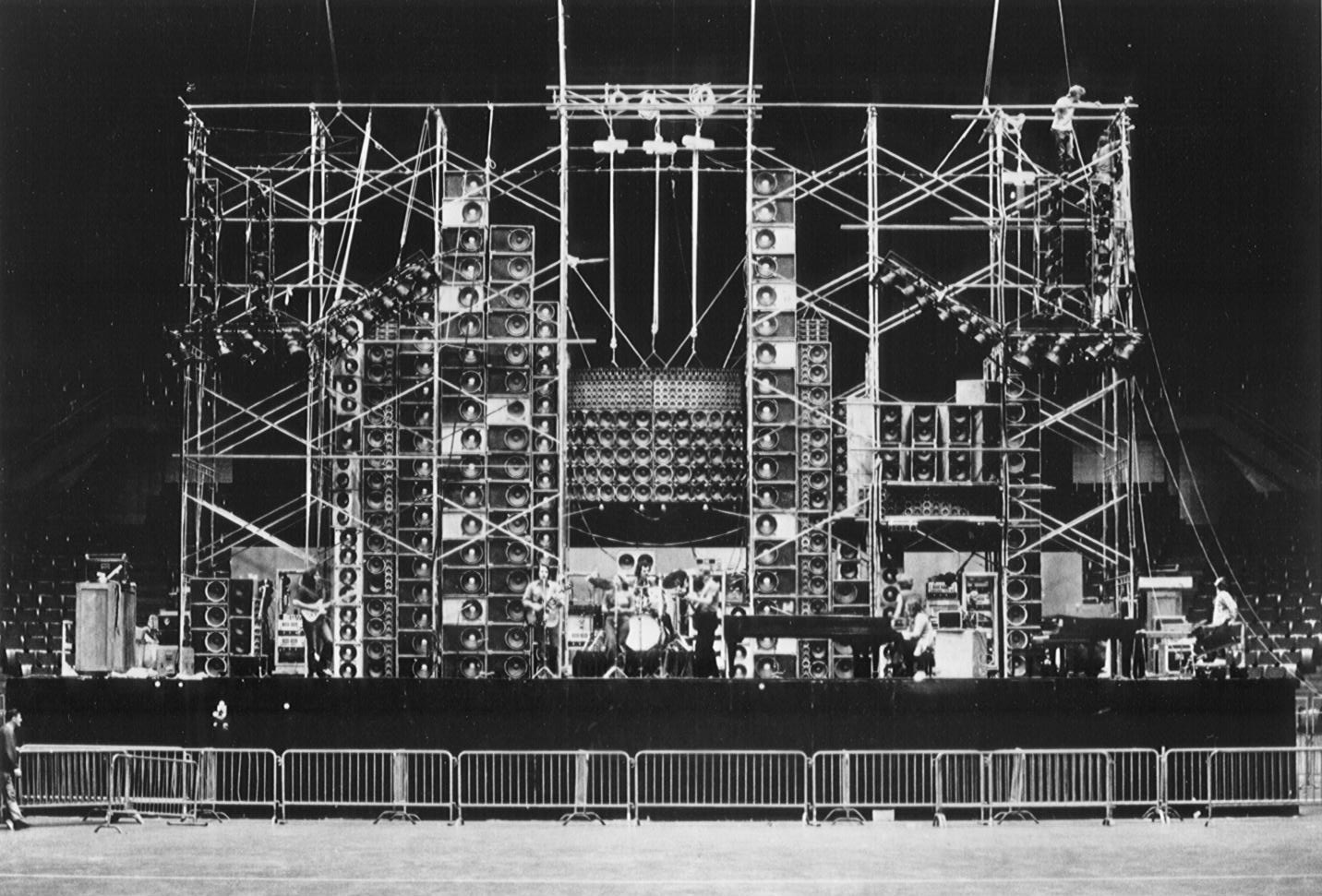

Ron Wickersham, Bear and I had the responsibility for the components of the system. There were others as well. Jon Meyer was a personal friend to me, but he did not work with this system. Later, Jon Meyer and I went to Switzerland to work on another project, and this system was completed by Ron Wickersham.
Another small fact. The circuit that we were originally talking about on this thread that came from the JC-2, was originally designed for the big 'Wall of Sound' system used by the Grateful Dead. Mark adopted it for the JC-2 because of its success with the Grateful Dead in sounding better than selected existing op-amps.

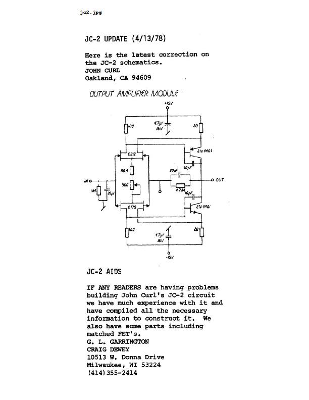

The marlev.com guy got the scans from me several years ago, but he never published John Curl's correction labeled "JC-2 UPDATE" in The Audio Amateur.
Long discussions have been had, and much water has ran into the sea, but here it is attached.

The JC-2 preamp Sch is on the famouse unoffical website of Mark Levinson
http://marklev.com/
After altering by another man from China,I just found the wrong in the ouput module sch.
http://www.hifidiy.com/dispbbs.asp?boardID=13&RootID=68247&ID=68247&skin=0
In the ouput module(=line stage),the phase polarity of - input is same as the output.In the words,the feedback of this module is postive not negative,the output module is an OSC not a NFB amp.
To correct it,IMO,the base pin of 2N4401/2N4402 should be exchanged with the emitter pin.I wonder if anyone had rebuilded the JC-2 according to the marklev.com schematic.
😎 Rolv-Karsten Rønningstad
Thanks for the input. R-K. I always get the leads confused, myself. However, what I first published was drawn up first at Mark Levenson, the company, and I didn't catch the error at first. Still, miss it today, if I don't look carefully. The correction came in a following issue of 'The Audio Amateur' and many people missed it, and still overlook it, even today.
You're welcome, John!
I got these as copies of copies in the early 80ties. Your preamp was the Holy Grail, you know! So I built a copy, paid dearly for matched JFETs! But, I also had the Update, so my copies were correct. I even have the second one to this day. And also a ML-1, and in use.

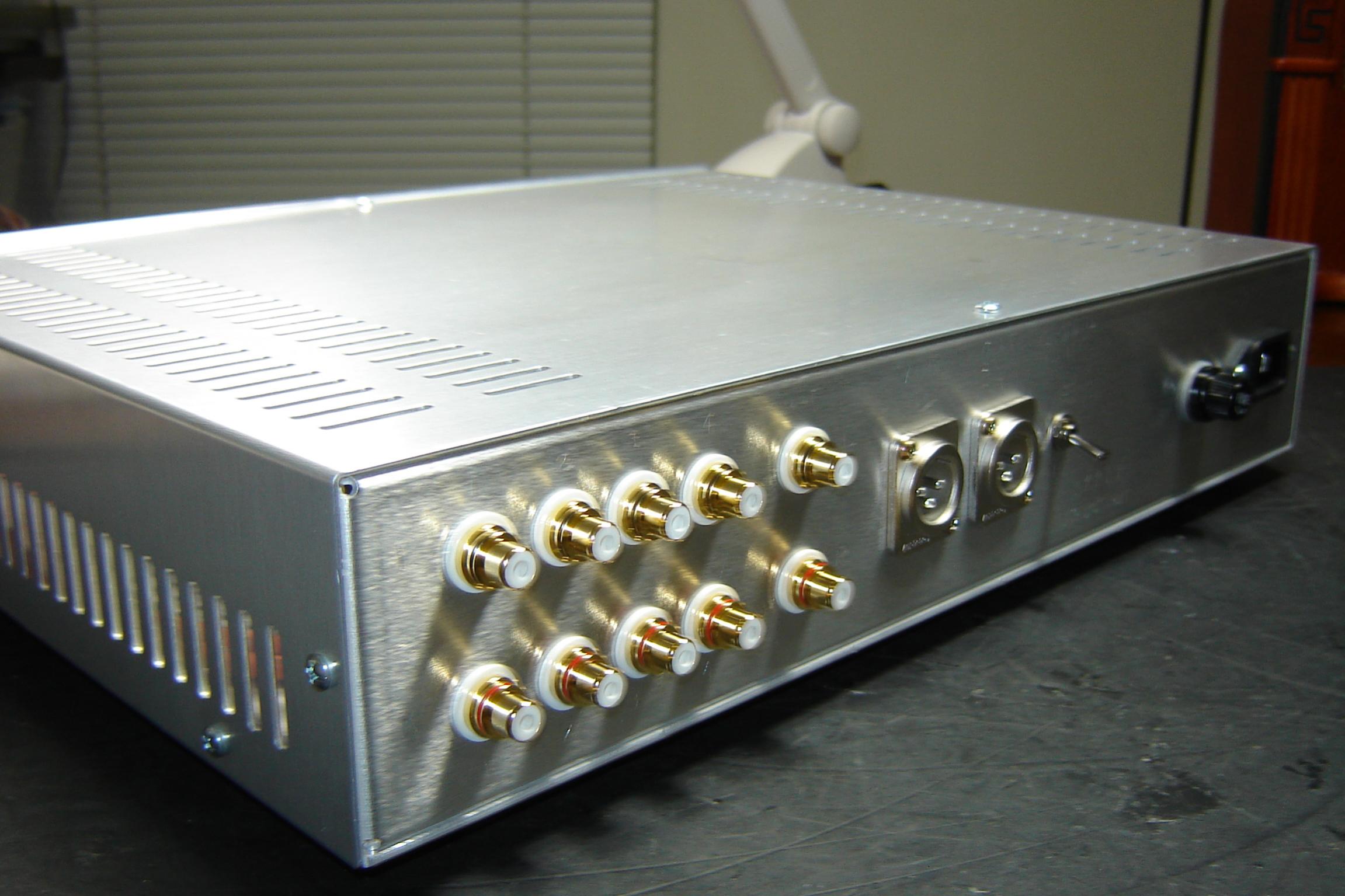

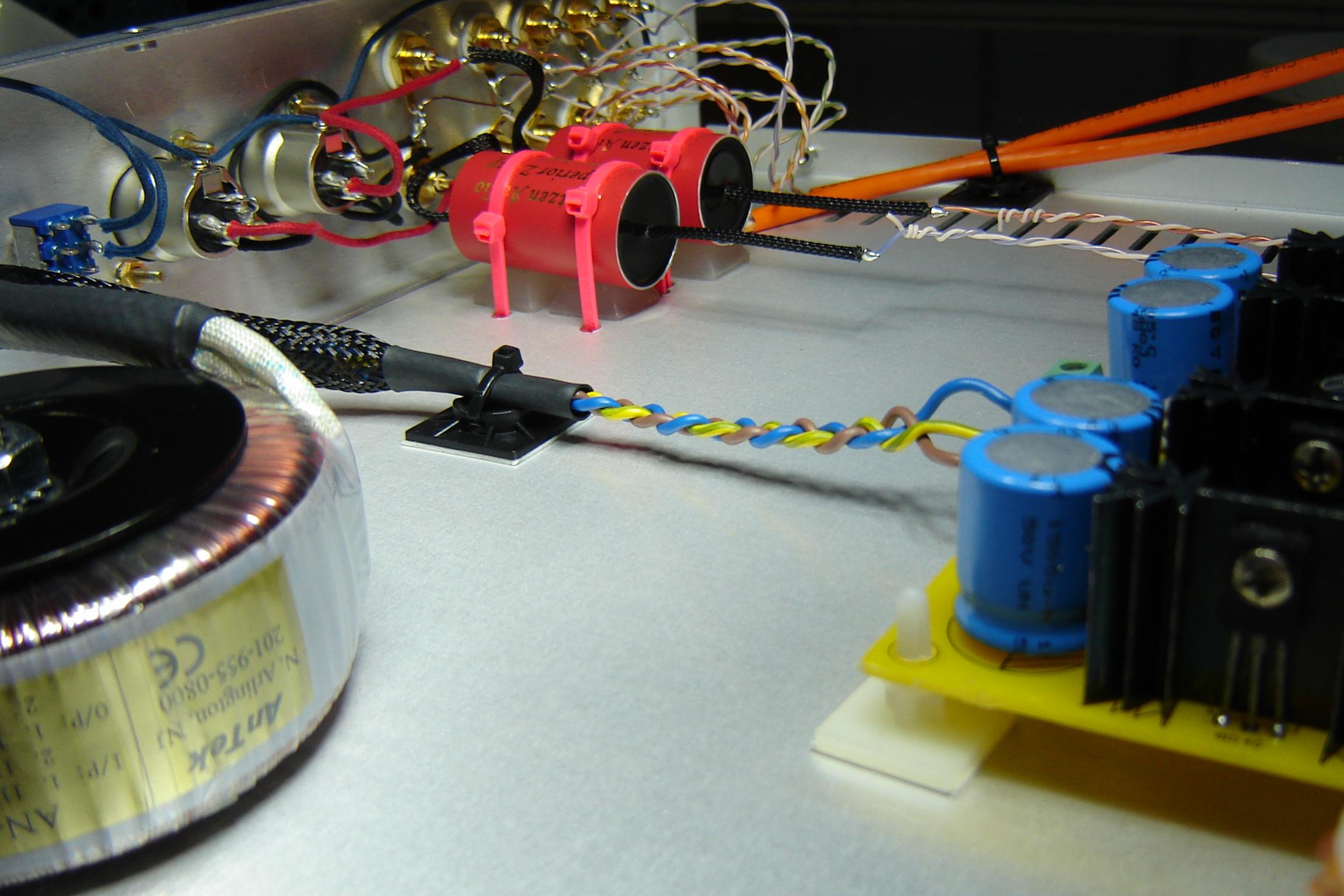

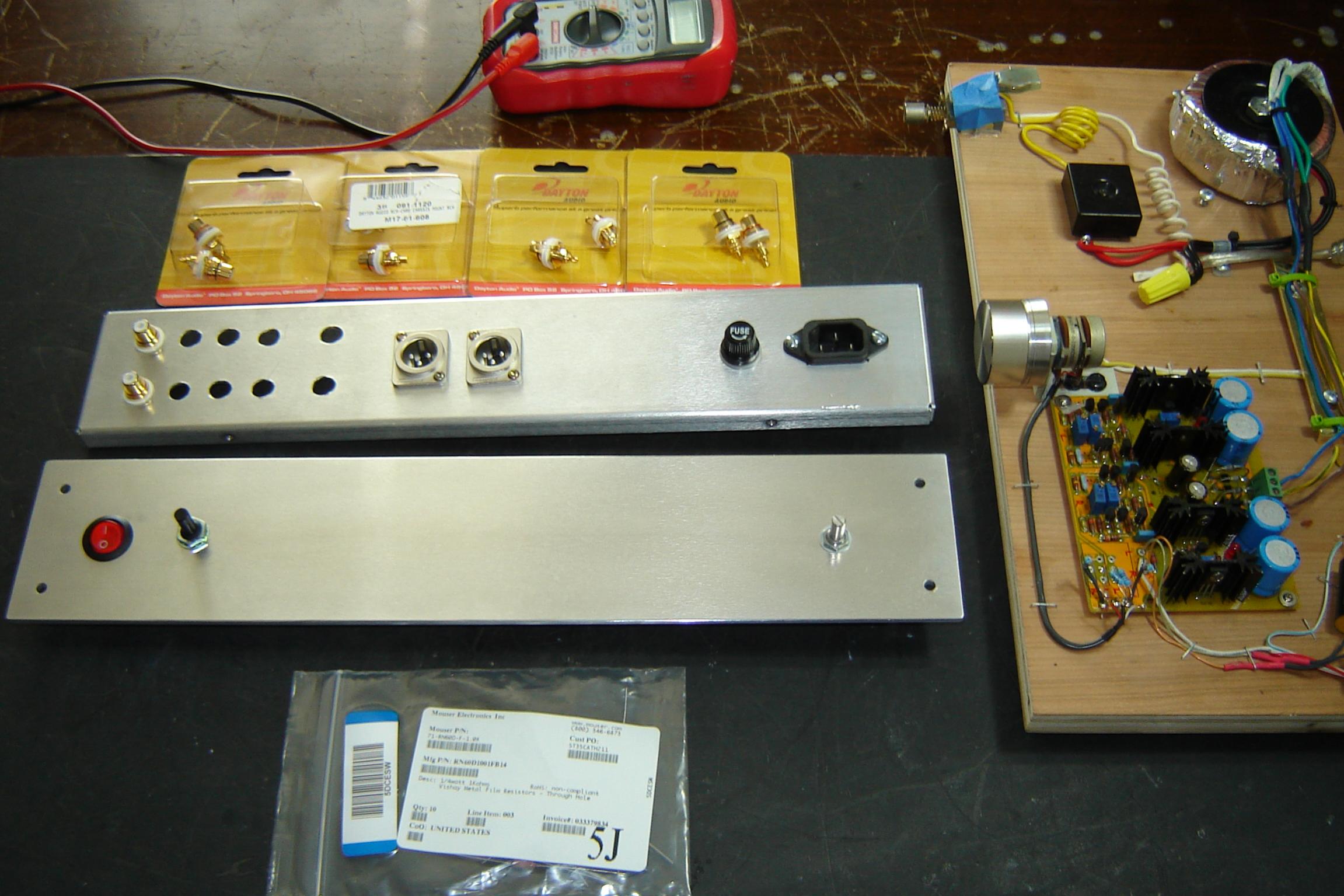

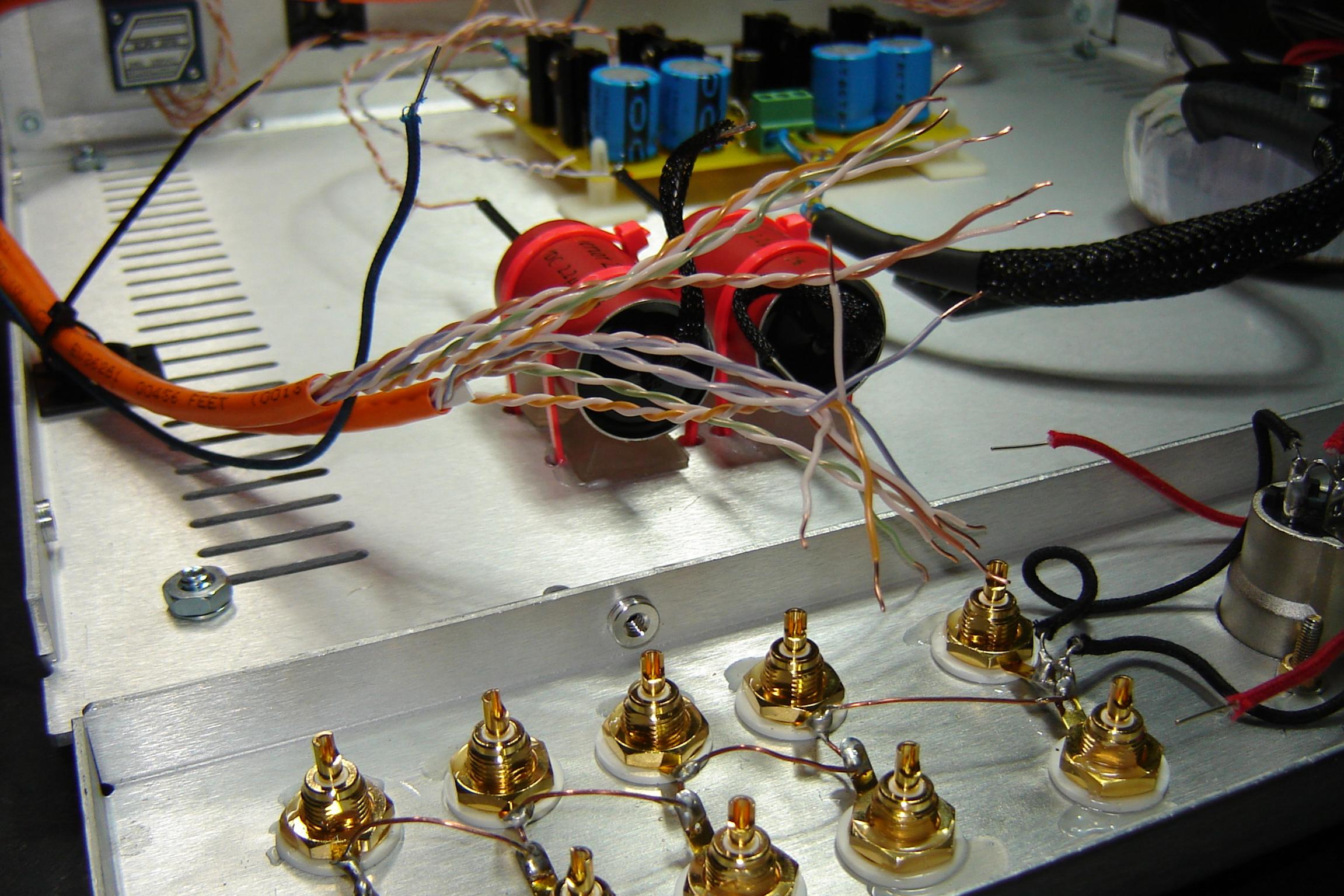

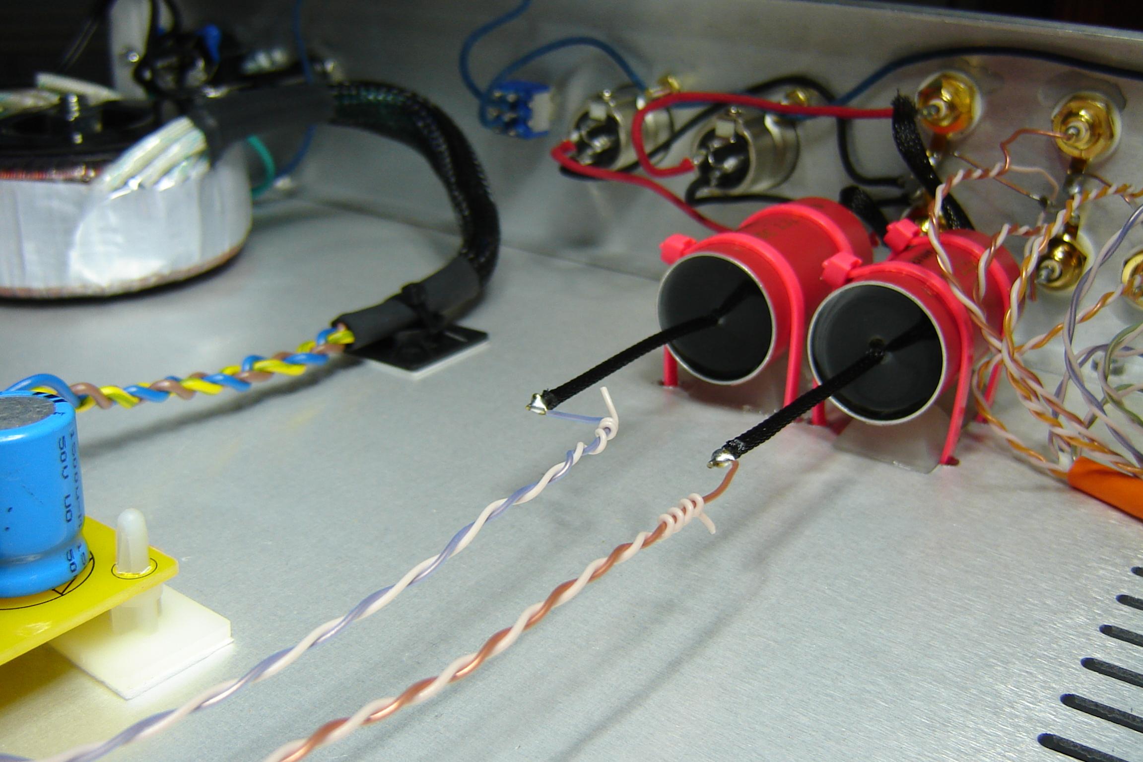

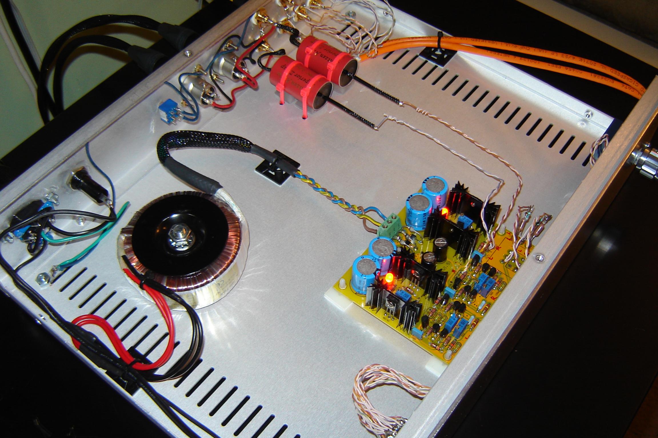

It is almost Halloween here in the US, so I don't feel too bad about reviving this zombie/old thread 😀
Here is a JC-2 pre I just built with balanced XLR and RCA outputs. I call it the Cathedral 2-Eleven (I am not sure it will be a good idea to get to 7
