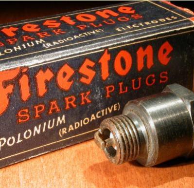

This spark plug tease, reminds me of when I was a young boy about 12-13, and I had a neighbor who owned the orchard surrounding my house.
We became causual friends, and one day he complained loudly how autos had switched from 6V batteries to 12V batteries. He claimed it was a conspiracy to save copper. He could think of no other reason. Years later, reading auto engine design textbooks, like many of you probably have done, I was shown the ADVANTAGE of 12V coils, instead of 6V coils. See, it wasn't a real conspiracy after all, to cheat the public, although the 12V battery's extra complexity and therefore cost, might have been offset by the reduced copper (wire) to the lamps, and the starter motor, at the inception.
When you think spark plugs, keep an open mind, for the same reasons.
