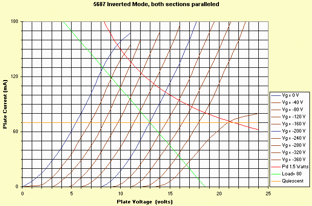

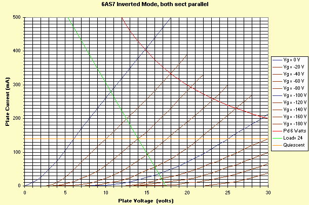

The inverted triode grid-plate curves are from the work of Steve Bench,
part of his look at grids driving the load, While the plates input the audio.

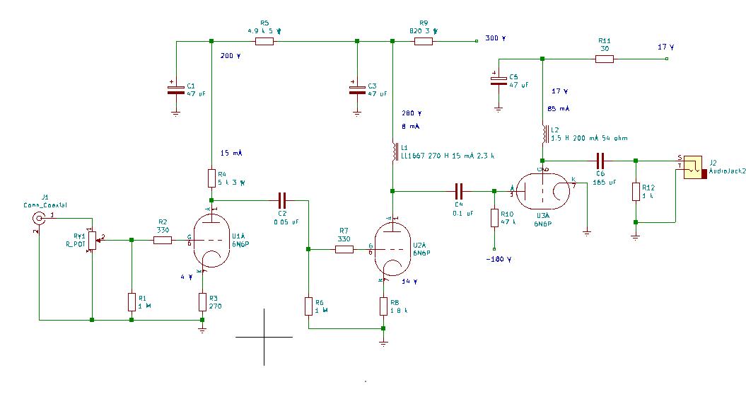

After reading Stevie Bench's article, I built a headphone amplifier with inverted triodes in the output. It sounds great - my best effort so far for headphone amplifiers. But, it is a real beast with chokes and double power supply.
