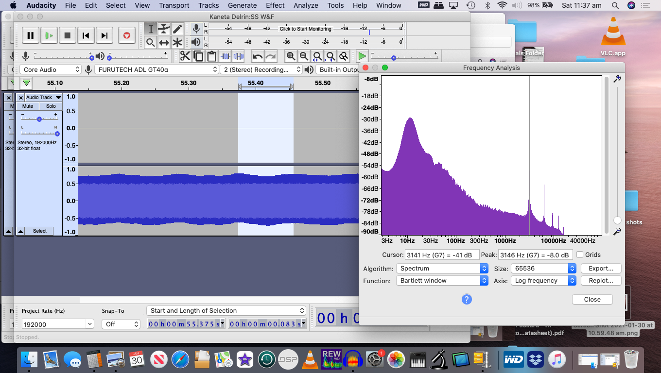

My experience is different. Regardless, if we can get some proper measurements it can be proven out, one way or the other.
Sadly, the Ultimate Analogue Test LP never misses a chance to disappoint.
I reported my previous disappointment in the Ultimate Analogue Test LP four years ago. It really is not fit for purpose in so many regards
https://www.diyaudio.com/forums/ana...-test-lp-aapt-1-vs-hfn-001-a.html#post4971923.
However it is all I have available for W&F testing.
Regardless, the Delrin/SS sample shows a lot of AM in the recording, and though due to the test record used no conclusions can be drawn, I see indications of very uneven rotation in the polar plot, around 40deg to 95deg.
Image order is Delrin/SS, 10R, and my 10R for reference.
I would expect my stock 10R performs very close to yours.
This was the reason I included it. The fact that it does not points the finger clearly at the test LP. Arguably the W&F results for my 10R are as bad as the Delrin/SS which is unlikely.
The AM modulation is clearly apparent in the polar plots. I count approximately 21 peaks in the polar plot which corresponds to an AM frequency of 11.7 Hz, close to the cartridge/tonearm lateral resonance modulation frequency I reported from post #1713. The tonearm can be clearly seen swinging laterally during the tests because of the off centre LP. This will excite the lateral AM modulation seen in the plots.
I don't see how an off-centre LP is going to excite an 11Hz cartridge resonance, and it wouldn't manifest so drastically. Seems little point in trying to draw any conclusions at all until a good W&F track is used and the test files are of a reasonable sample rate as there could be artifacts from that conversion.

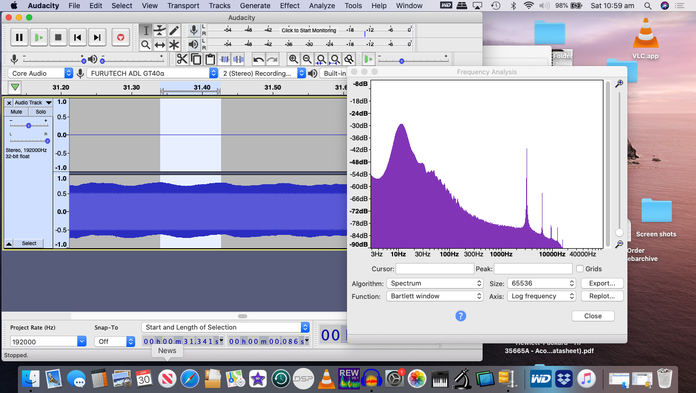

I repeated the Kaneta plinth W&F tests with the Delrin/SS platter and also the OEM platter, despite the misgivings about the Ultimate Analogue Test LP. The plots are First Delrin/SS, second OEM. The same AM is evident, which shows the artefact is not caused by the Delrin/SS platter.
I suspect that the polar plots will be similar as well, which if true, would be more evidence against the test LP's usefulness.
@ JPI suspect that the polar plots will be similar as well ...
You are correct, the polar plots do not show not AM. I misspoke. The Audacity plots do.
