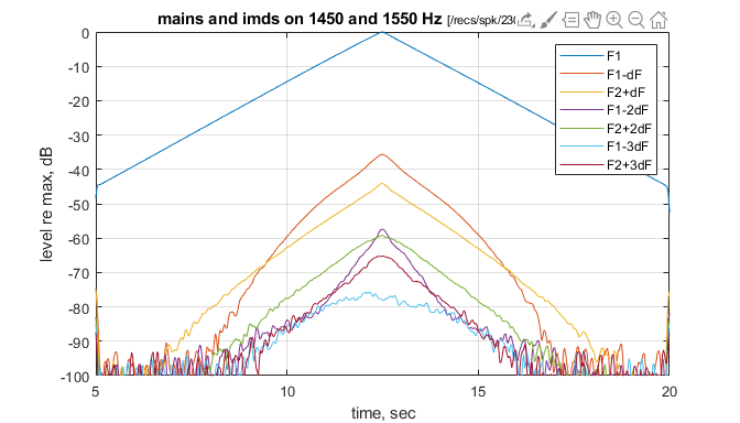

Here you are...
I did, quite a few times. The reality is : IMD on Vifa/Peerless TC9, 1450 & 1550, sweeping up from ~55 dB SPL to 100 dB SPL and back.
Go figure out how to explain it🙂

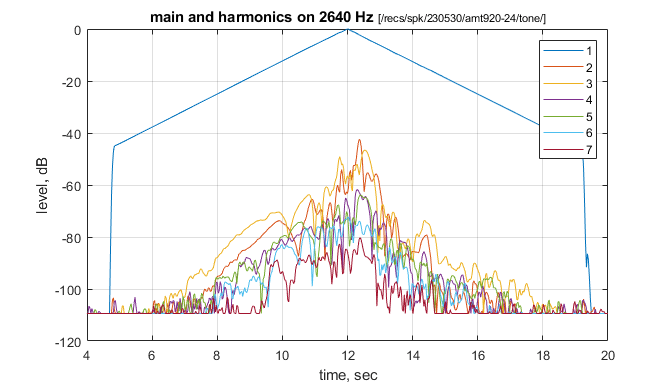

Symmetry between up and down slopes re max SPL line. It is not always the case, especially with planar drivers. Sounderlink AMT-920 as an example (0 dB level -> 100dB SPL):
i'd think that thermal tau is obnoxiously low. You can use planars in an array, they should sound ok for low SPL - but that's about it.

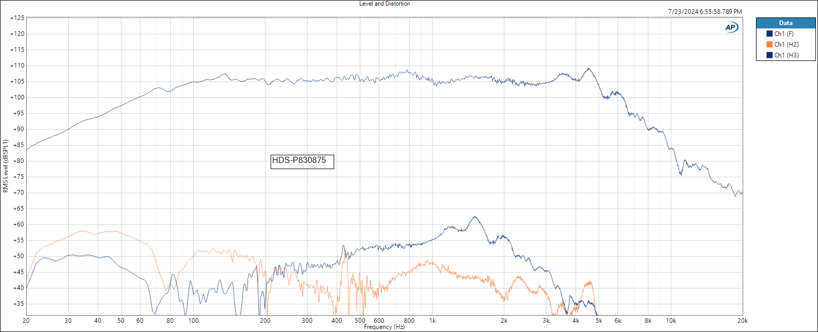

Hello All,

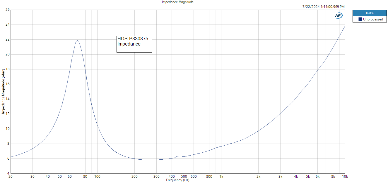

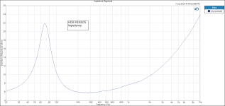

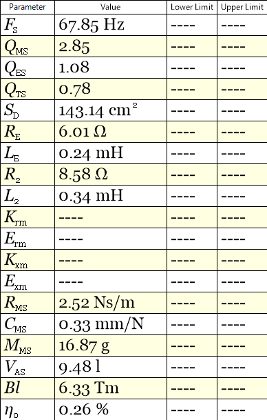

I connected one of the speakers on my bench to the analyzer.
The driver is a Scanspeak HDS-P830875. I have owned it for 12 ish years and not likely anyone's favorite driver and hopefully I will not be hurting anyone's feelings while testing it.
The driver is in a ~15 liter sealed enclosure. The sealed enclosure adds a little stiffness or air suspension. I have the impression that the added air suspension is more linear than the existing mechanical suspension.
Measuring these sealed enclosures I have noted that the resonate frequency increases and that the cone excursion at the lower frequencies is reduced.
See the link to the data sheet and impedance plot and in box parameters. Note the increased Qts.
Thanks DT
https://www.falconacoustics.co.uk/downloads/Peerless/830875.pdf

The 'in-box Qts' is actually the Qtc. What's new about this?See the link to the data sheet and impedance plot and in box parameters. Note the increased Qts.
There is nothing new about this.

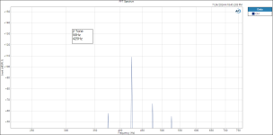

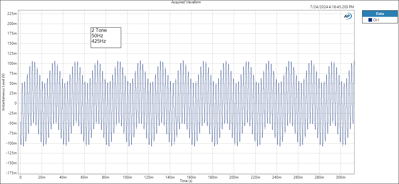

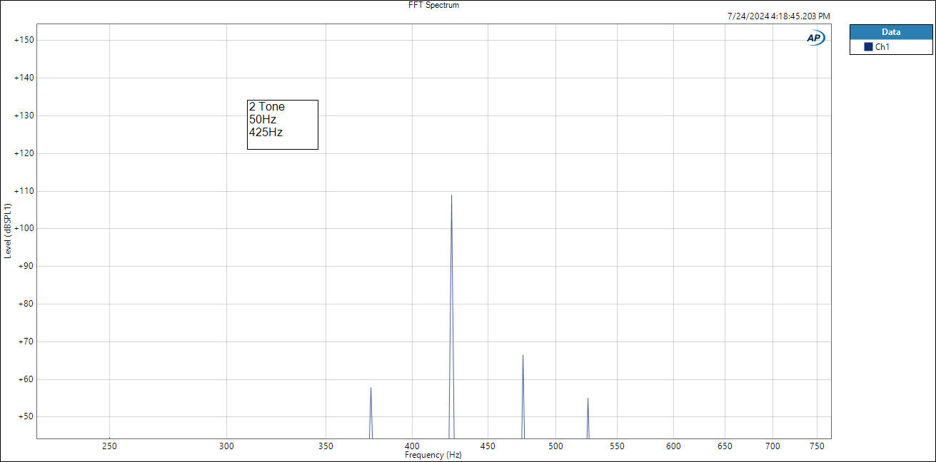

Hello All,
This is 2 Tone Amplitude Modulation HDS-P830875 at 4.0 volts, microphone about 6 inches away from driver.
The acquired waveform plot really shows the Amplitude Modulation.
I think that the air compression of the sealed enclosure limits the excursion of the voice coil.
Note: the side bands are even, the type of AM you would expect from Sd(x)
Thanks DT

That there is some kind of modulation going on, is from a physics point of view not saying much at all.
Again, the only important question here is how significant that contribution is.
And, no, this is not evident, since that contribution is already very heavily dependent on the surface area.
I am not talking about the relationship with cone excursion in that case, but the fact that the Sd of a surround (and therefor its change) is relatively bigger for small woofers compared to bigger woofers.
So again, the fact that there is AM is not what we are looking for, that was obvious from the beginning, we need to see numbers to get a sense of its significance.

Hello,
Amplitude Modulation caused by Force Factor Modulation shows up as f2 +/- 2f1 or odd AM side bands. The side bands in the plots above are even as in f2 +/- f1.
The AM in the above plots is clearly not caused by Force Factor Modulation.

Are you sure it is AM modulation and not another kind of IMD ? If proper AM then the sidebands would be at the same level but they differ by about a factor of three.

Hello Charles,
Quite sure.
We are looking at a real speaker with real measurement tools not a simulation.
If the B field and Voice Coil were completely symmetrical perhaps the side bands would be closer to the same magnitude but not in the real world.
If you like take a look at the IMD AM side bands in this Purifi data sheet.
Thanks DT
https://ptt.purifi-audio.com/document/share/28/04d9e1fb-782d-43e6-a181-7d67ed1066a7
Could it be the sideband a-symmetry stems more from spider plus surround a-symmetry than Bl(x) a-s, or is that a plain wrong assumption?
it’s evident from the time domain plot that it’s dominated by AM and not FM. Any modulation spectrum can be decomposed into its AM and FM components. Doppler distortion is a source for FM but Bl(x), Sd(x) and Bl(i) all predominantly produce AMAre you sure it is AM modulation and not another kind of IMD ? If proper AM then the sidebands would be at the same level but they differ by about a factor of three.
