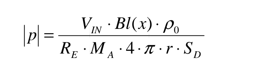

Again, compliance isn't relevant in IMD as already being explained and shown earlier, as well as can be seen in the formula here.

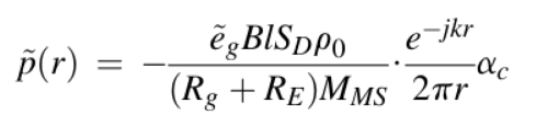

Equation: Sd should be in the numerator and not in the denominator. acts the same way as Bl.
You are correct, don't know why this went wrong. The SPL goes up with higher Sd.
Copied directly this from a paper I was reading.

I think this is a more correct way, although I bet that the format being used will really confuse people;Equation: Sd should be in the numerator and not in the denominator. acts the same way as Bl.
From; Acoustics: Sound Fields and Transducers, by Beranek and Mellow, page 253

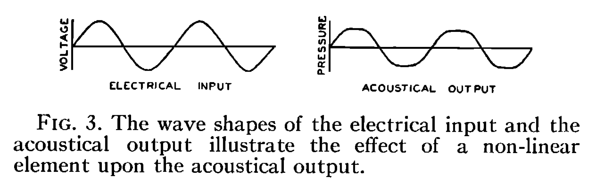

Back in 1944, Olson was studying the effects of nonlinearity in loudspeaker suspensions. He published this figure in a paper titled "The Action of a Direct Radiator Loudspeaker with a Non-Linear Cone Suspension System".
nice. that is pretty early. We also read a paper by Cunningham from 1949 that analyses many of the later known nonlinearities including the Bl(i) modulation which is set by L’(x)Back in 1944, Olson was studying the effects of nonlinearity in loudspeaker suspensions. He published this figure in a paper titled "The Action of a Direct Radiator Loudspeaker with a Non-Linear Cone Suspension System".
note also that as the Thorborg 1995 paper shows we have Mms(x) modualtion too. They speculated that Mms(x) would change in tandem with Sd(x) which could compensate for the Sd(x) variation. However, requires a certain thickness and sensitive of the cone and surround to workI think this is a more correct way, although I bet that the format being used will really confuse people;

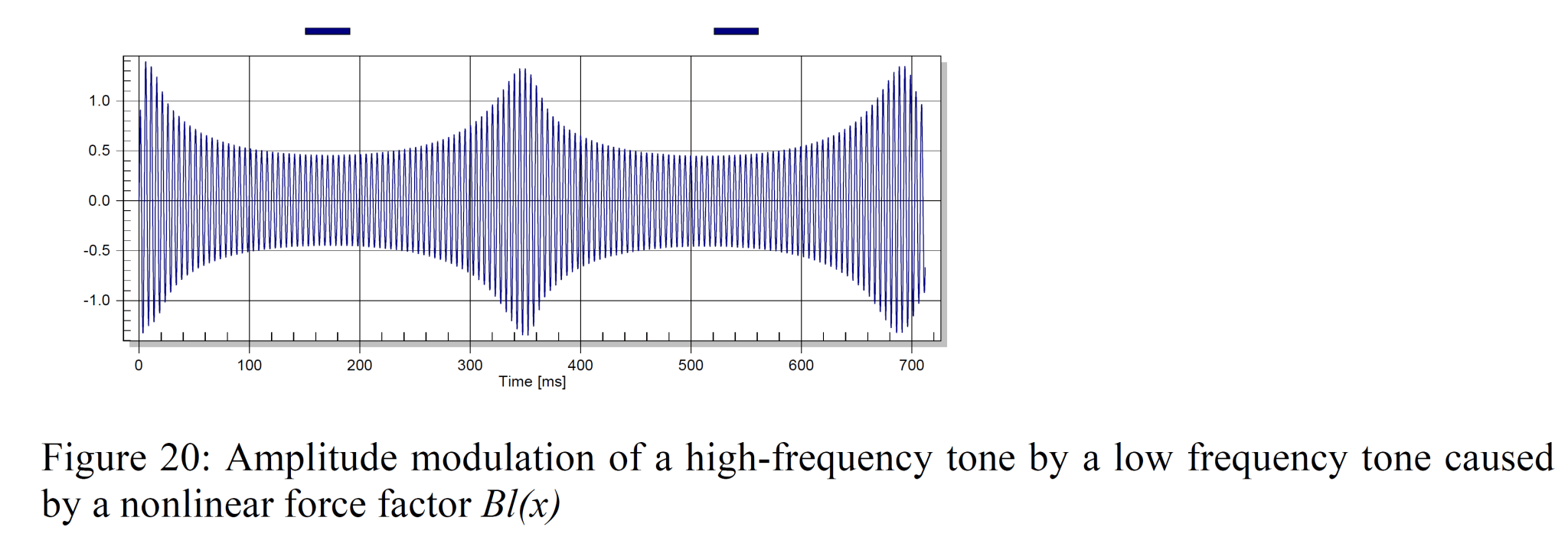

I would recommend reading a couple of pages back, this has already been addressed, incl the same source/reference.Klippel has published a paper in 2006 titled "Loudspeaker Nonlinearities – Causes, Parameters, Symptoms". It is available on the Klippel website here. It has a lot of different examples. One of them describes what happens as a result of nonlinearities in Bl(x):
edit; let me be not "that lazy guy", sending you into the woods;
https://www.diyaudio.com/community/...l-x-for-mid-ranges.376164/page-7#post-7703832
In that example I am using efficiency instead of sound pressure, but it basically shows the same thing.
