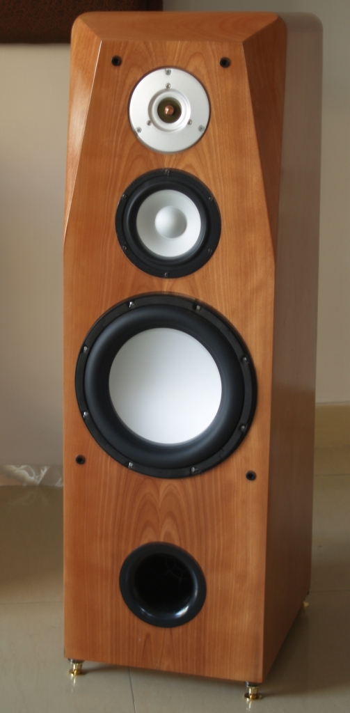

so build a good 2-Way and a well integrated sub...
How can we do this? How can we make a well integrated sub?
If the two way is a ported design with BSC, how can we make the subwoofer to click/integrate well with the midwoofer? Will the midwoofer be filtered electronically? Or only working out the subwoofer filter? Will you need an RTA to tell you how to set the subwoofer?
What if the 2-way is a transmission line?
I can make a 3-way, but I have never had a success adding a subwoofer to a working 2-way. And I don't like to redesign the already working 2-way into 3-way. So these are questions I'm looking the answer for...
First, by watching the various behaviours of the Subwoofer, so that we can match group-delay and transient behaviour etc. with the mains. Means we need what is often called a "fast" subwoofer, meaning low group-delay, minimal transient overswing, an amplifier with crossovers that have the appropriate slope and so on.
Few if any commercial Subwoofers and few any so-called "subwoofer" drivers need apply.
Probably not at all.
BSC causes a 6dB rise in LF in the power-response (in room response) over a neutral response...
This lifted "mid-bass" can subjectively compensate for a lack of really low bass, but if we add a matched and integrated sub this fallacy becomes painfully obvious with a completely unbalanced, overcooked, overbearing bass response. If we turn the subwoofer down enough it will sound as if it is not there or at least does very little.
Probably what you call a "working 2-way" was not actually really "working" in the literal, technical sense of the word, even though it probably sounded fine, subjectively.
Try using the midwoofer in a maximally flat sealed enclosure without BSC, use a sealed woofer with a 15 - 18" Pro Driver equalised for flat LF and make sure to use a 2nd order LPF...

Some suggestions with respect to crossover points and subwoofer integration:
Maybe just use wide baffles
This is what I have in mind. I already prepared the walnut enclosure. 15" wide. But I haven't calculated what cut-off frequency is in effect by such baffle. Just an experiment.
Well, try a decent 18" Pro Driver, fairly long throw, middeling efficiency and lowish Fs, if the Seas goes low enough to integrate with it.
Which model Excel is it?
W15CY. 18" is too big. Overseas purchase can be too expensive. Local drivers are cheap (and with no measurement data).
Now I'm starting to give high value on TL design....

If your baffle is 15" wide and no more than around 1.5 to 2 times the width from the rear room wall you need not worry much.
With a W15 I would not remotely attempt to push it below around 200Hz, it is just too much of a toy driver. It is okay as midrange for 3-Way, but I would not attempt to even let it handle upper bass...
18" is not too big. You can sucessfully do a 2-Way with around 1KHz crossover using a good 18"...
But given your main driver I think 3Way is the only viable option. And at the minimum you will need 3rd order (acoustic) slopes on the Midrange.
You may find my current speakers at home slightly interesting.
They use a 15cm Metal Cone fullrange driver as midrange, circular ribbon tweeter and a 28cm Metal Cone bass.
The Bass is set to 28Hz in a MLTL tuned quite low, more for reducing LF excursion than for extra SPL.
The crossover is electrical first order series with NO BSC, crossover points at 300Hz and 3KHz (forced by the drivers). As a result the acoustic slopes on both midrange and tweeter highpass are 3rd order, while the woofer and midrange lowpass slopes are 1st order, so the acoustic crossover is asymmetric (works very well in practice, actually)...
There is no magic in TL's and they do not offer any actual improvement on suitably designed reflex box. And they cannot make a small driver big, or make it go low and loud, either solution...

I was refering to the fact that in my setup at least the acoustic slopes for the highpass on the midrange and tweeter are 3rd order acoustic, as they combine the first order electrical slope with a 2nd order acoustic slope.
Meanwhile the lowpasses on the Woofer and Midrange are pretty much textbook 1st order (at least up to where the drivers linear operating range reaches, two octaves+ or so).
So the acoustic crossover (which is after all the one that matters) is asymmetric. As a result my 1st order series crossover is not really textbook either, if it was I'd get a 3-humped response and not a flat one.
Actually, making this kind of crossover work is pretty darn hard, because I decided to limit myself strictly to two caps and two inductors with only an RC to equalise and level match the tweeter (a circular magnetostat of somewhat difficult to employ frequency response, but exceptionally good sounding if it works). It would have been much easier with the addition of extra impedance equaliser circuits and such.
But this way I was able to use tinfoil Cap's for the tweeter and midrange, copperfoil chokes all around and filmcaps for the bass.
Enclosure BTW is 20mm stone lined 18mm MDF, avalonish style... Midrange has "hard ceramic non-regular spheroid" rear enclosure. Well, okay. It is a ceramic flowerpot (one has to be inventitive in one-offs/diy).
The colourations from these are not quite as low as the commercial all Alu speakers I designed a while back, but they do not give up a lot either...
