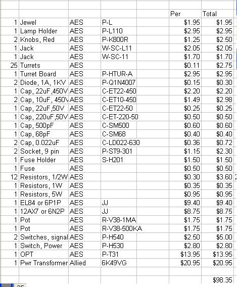

I'm using minimum order pricing for all components. If I ordered 100 resistors I could get them cheaper but I'm going on the assumption that someone may want to build an amp that does not plan on using the remaining 99 resistors just to get them cheaper. Same for tubes, one each, etc.
Price came in at almost $100 if I buy all the parts from AES except the power transformer from Allied.
Next I'll see what I could do by purchasing from several sources, and use the Chinese or Russian tubes.
I could probably leave out the lamp as well. It is a frill but does not add to the tone unless I use the more expensive purple lense.

I got the cost down to $83.02 by switching to the 6P1P, 6N2P, and a couple more vendors. I gave up looking, but I'm sure there is room to shave another dollar or two out of it with enough effort.
Mouser almost always beats AES on small stuff like caps and resistors, especially Xicon branded parts. There is no reason you can't quote the Mouser price if the SAME part is available from Mouser even if you bought it from AES.

Thanks Pete, missed those although I got the fuse and holder.
I know I've seen the receptacles for $.95 and the local electronics shop has the cord for $1.35. The funny thing is that right next to it is a cord with flying leads for $1.95! Buy the IEC cable and cut it off!
I found a IEC receptacle with 5X20mm fuse holder for $1.85, that would actually reduce the overall cost compared to the current fuse holder plus a socket.
I'll check Allied for Resistors and Caps.

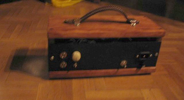

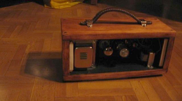

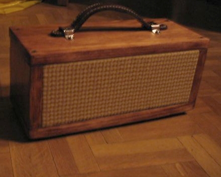

I built this 5F1 Champ for around 150$. "Chassis" not included. The leather handle was an "expensive" extra. The OPT is a Hammond 125CSE. BTW, the Hammond 125ESE sounds noticeably better in this amp. I reckon I could have saved 50$ using cheaper parts if I wanted to.
