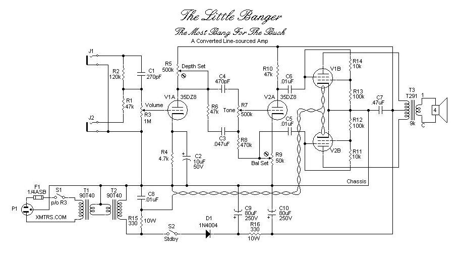

What is so hard to understand about 'No Non-Isolated Design'? If you have a direct connection to the line and some idiot wired your outlet wrong you are at line potential when you touch your guitar strings even if your chassis is unexposed.

... some idiot wired your outlet wrong ...
Well, that's all very true... there is no accounting for the actions of some idiots... which is why the kids' amp has included a GFCI 3-prong plug and Line-Fault Indicator for years.

It was a hideous idea sixty years ago, and it hasn't improved with age. How many sound cards, CD players, etc will survive 120Vrms? I'm sure a 1 : 1 PTX is a helluvalot cheaper. Even if you have to get two filament xfmrs and connect them back-to-back isn't so expensive.
We feel that safety should be inherent and not something you should test for.Well, that's all very true... there is no accounting for the actions of some idiots... which is why the kids' amp has included a GFCI 3-prong plug and Line-Fault Indicator for years.

OK, no line-sourcing... I get it, "We" don't do line-sourcing. So, if I am building to our Hundred Buck specifications, for the most bang for the buck I would convert that simple string-filament design with a pair of $8 "Isolation" Class-2 HVAC Transformers, added to that exquisite pair of $3 tubes and the $18 one-size-fits-all 8W iron... and it's still under a Benjamin.

So why go the back to back transformer rout with its voltage loss when you can get a good 120V to 120V transformer for $12? Also where do I get the 35DZ8's for $3?
35DZ8 List Price as of last check: AES $2.10, ESRC Vacuumtubes $3, Ebay $3.50, Vacuumtubes.net $4...etc not including shipping of course. Transformer-Pair was a left-handed suggestion in an earlier post ... but then I couldn't find a "good" 30VA+ 120:120 under $34 (which would likely move the cost est just too close to a C-Note) so I included the idea (tongue-in-cheek) in the line-source conversion. Anyway, with B+ at 90V or so, and driving deep (R5) into AB2, PO can top 5W. Also note conversion typos: C9 & C10 are 20uF & 40uF respectively, sorry for missing that... I'm old and only have one good eye left.

You can get a 50VA Triad N-68X isolation transformer from Mouser, and probably from other suppliers, for less than 12 USD ( but this does not include postage ).
