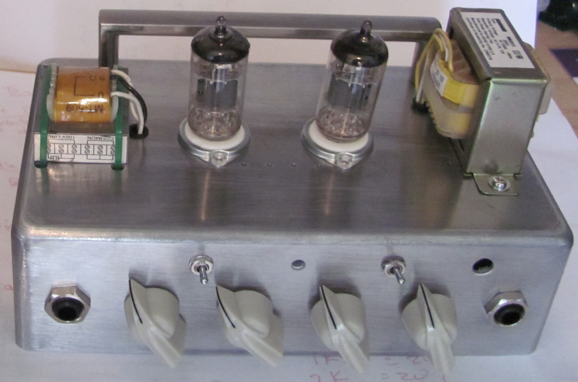

2x 6BL8 1/4 watt se amp
2x switches
- triode/pentode
- tone mid contour
4x knobs
- tremelo speed
- tremelo depth
- drive
- tone
2x outputs
- 8R speaker out (on back)
- Instrument level out
Powered by 12vac 1 amp wall wart
Very cool..

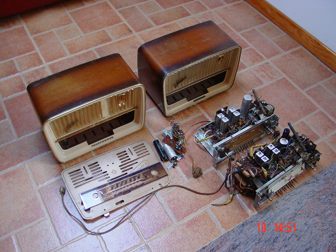

OK, the reason of my post is that I bought two old tube radios a week ago, Telefunken's, and today I opened the package and ....what a shocker.....it turns out the OT'S fit into my chassis. I thought finding another OT this size was next to impossible. I love all this strange coincidences, the amp was in the death row but now it gets an extension. Not dead yet.
Oh, and don't forget to learn from my failure - if you're going to use a cheap OT do a push pull amp!
