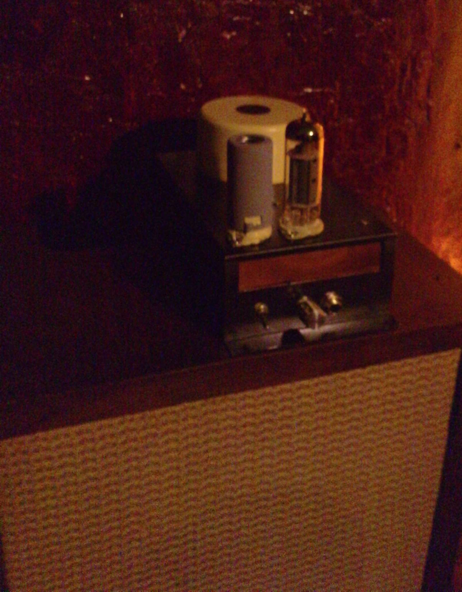

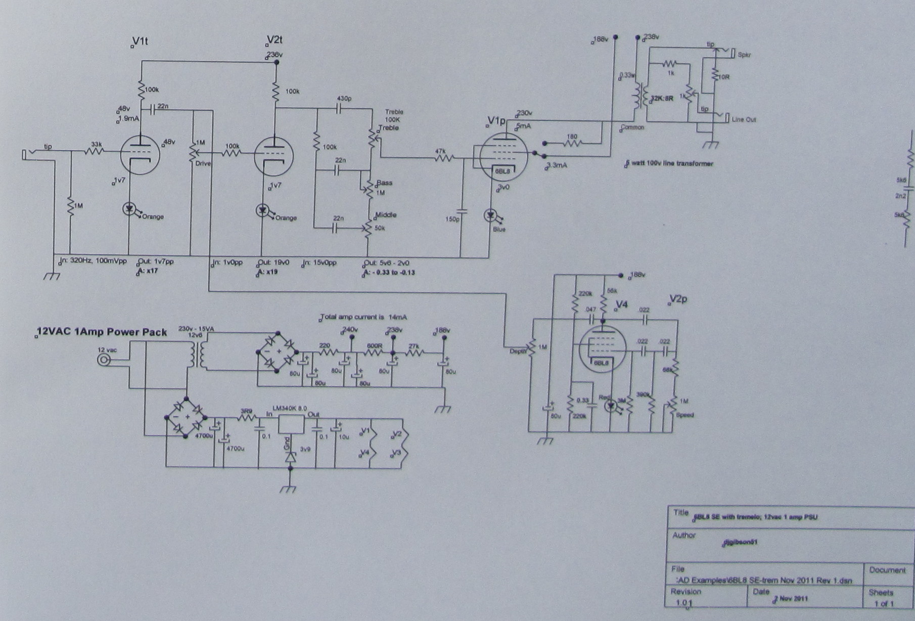

Simple bedroom amp
12 vac wall wart, two tubes, 5w line transformer, (too many knobs 🙁)
It sounds good - gonna make some for Christmas pressies 😀

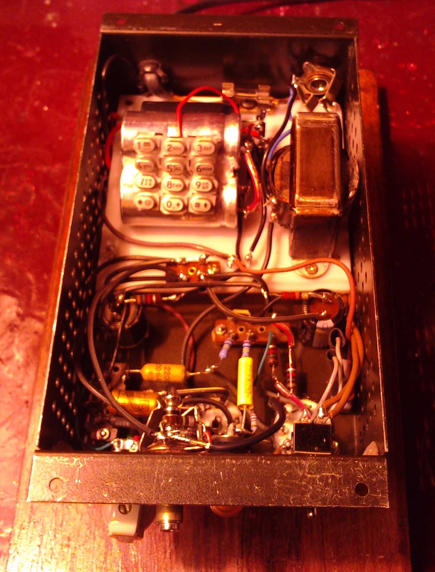

Hehe. The guitar is still on my lap as I write this. Just tested my little creature... Well, what can I say? It sounds like a Champ, that is until it gets into distortion territory (unknown to the Fender Champ), and when it does I'm rewarded with farty distortion and some oscillation too. Hehe, maybe it should stay inside Champ's territory after all. Or maybe some work still to do.... The thing I'm really surprised about is the lack of hum. This is to date my first SE amp with no audible hum. I can't hear nothing (98dB speaker) and the filaments are AC heated (in series). More to come.
Another set of excellent pictures.
Hmm, I'm having a hard time coming up with a suitable name for this offspring of mine. Maybe Blown Fingers or perhaps Detonator.

Good question. Kids like explosions so it shouldn't have worked but it did. Maybe this boy is a little bit girly, or maybe not masculine enough or maybe he's just obedient or perhaps just a little shy. After all maybe he's just dumb. Who knows, too early to tell.

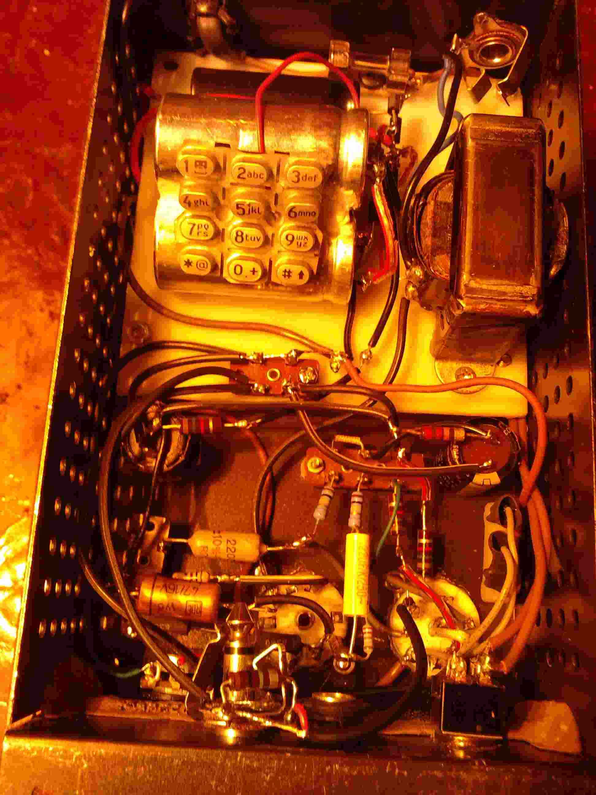

My amp's ready.
Oscillation and farty distortion are gone now. Changed the layout a little.
More than once, as I was building this, I felt I was losing my time, thinking this will turn out to be a toy or a joke of an amp. Well, I was WRONG. Two big surprises: first one was the absence of hum (dead quiet); second one has been the sound....it sounds pretty,pretty good. And it is loud, I reckon too loud for bedroom use. All in all, pretty happy here about this one and I've learn a few lessons too: this amp has taught me something that I'm yet to fully comprehend.
Now it comes the boring part (drawing out the schematic) and the nightmare part (the recording). Not sure about the BOM, a friend of mine gave me 4 6N2N's, I have no idea how much it cost one of these. Nor do I now what would be the normal price for the transformers and chassis ( Toroidal PT and chassis two euros and OT from some 60's junk reel to reel which only cost me the effort to take it home).
I keep trying to post a decent picture but to no avail.

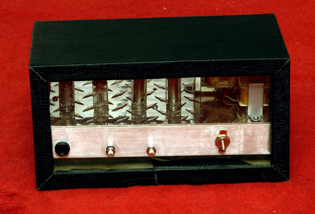

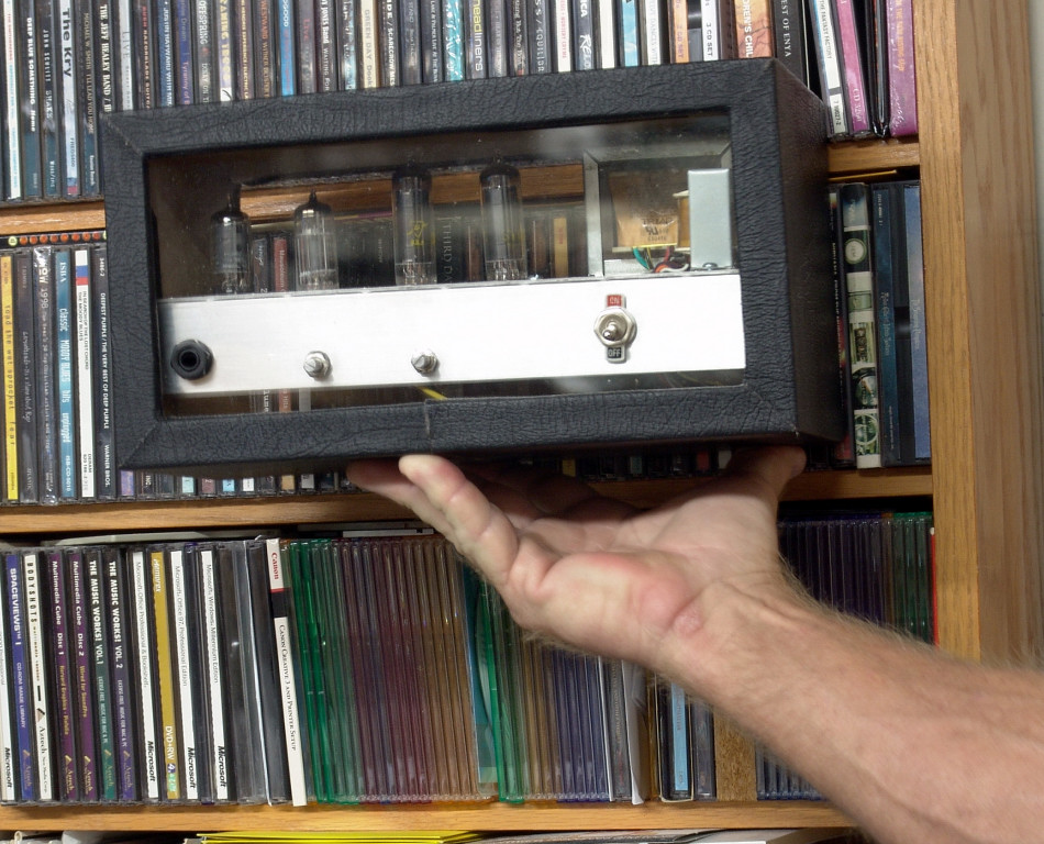

It's safe to assume from many of the comments that we have all learned something here. I have always known that for me at least, the construction and implementation of a project are always far more challenging than designing it and making it work. This project has taught me at least a dozen things that don't fit together. One is this amplifier. Right now the chassis is kind of stuck inside the cabinet where I placed it about 2 weeks ago. It doesn't want to come out peacefully either.
The electronics are alive and well and have not changed since I posted the schematic in post #1021. This unit is just the head unit. I have dubbed it "Little Big Head". The speaker cabinet is the one seen in several posts with a Jensen Alnico 8 inch speaker in it. It still looks the same, unfinished.
The front panel escuteon is still missing. It covers up the aluminum where the pots are and extends down to the bottom of the Lexan front (it doesn't fit). The back panel isn't even made yet.
Speaking of deadlines, I have a major project at work that was to be done by Thanskgiving. My wife, Sherri has been away for most of this year but I found some reasonable plane tickets and she flies in next Sunday. So I will be working non stop to finish my project early so that I can take the following week off. I was at work for most of yesterday. This means that I doubt much more will be done on these amps for a while.
Total parts cost for the electronics is about $45. (Within $2). The tubes are 18FW6 input pentode (like a 6AU6) 18FY6 second gain stage (1/2 12AX7) 32ET5 self split output stage. All tubes are $1 each at ESRC with over 1000 of each in stock. They are also available at AES. The power transformer is the Triad N-68X and the OPT is a 300-040 70 volt matching transformer from parts express. The amp delivers about 1.5 watts of clean power (3% dist) and about 2 watts when dimed.
Amp 2.2 is still in pieces. The electronics work fine, the other stuff still doesn't fit together. There are 2 12 inch cabinets for it and it goes to 20 watts with the attenuator off and just fits in the $100 budget.

I like good pictures (see my avatar) that's why I hate these goddamn phones. Again, will have to take the amp upstairs and blah,blah,blah. All this effort to get no votes I'm afraid, maybe Jazbo8's if he's kind enough. Please Jazbo8, I hate zeros and the pro guys really don't need another vote, pleeeeease.
Well you certainly get my vote for creativity with the keypad😀 Love to hear some clips, we are all waiting...
Jaz

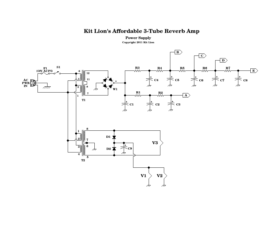

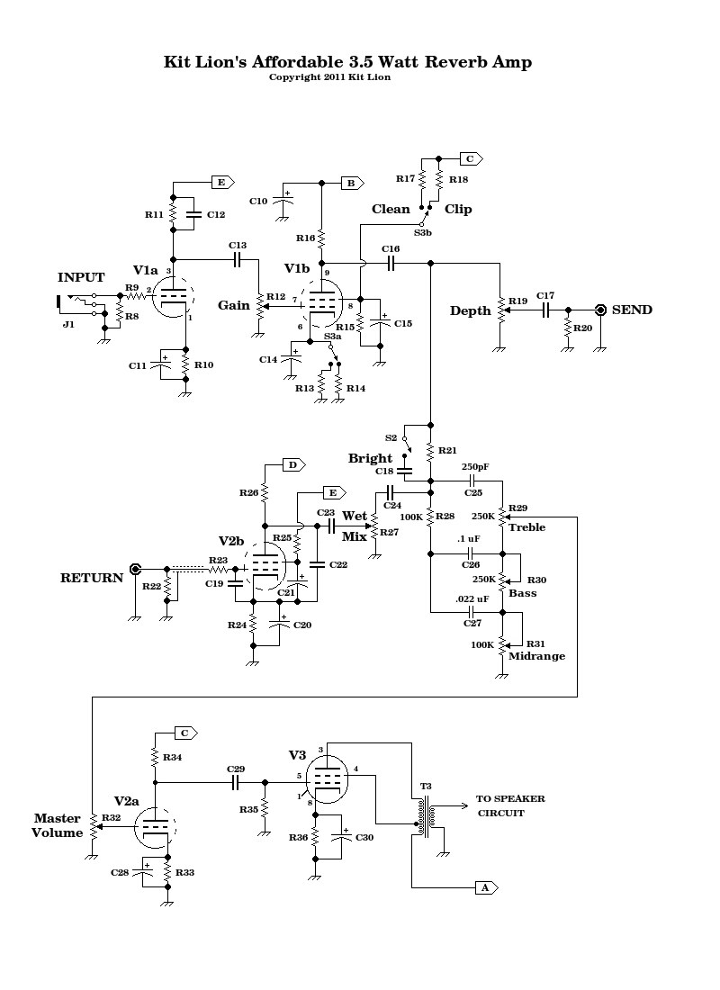

Down to the wire . . . (A little solder helps, too.)
"Let's imagine Tubekit is the only one to show up on time with all his papers in order"
Okay. Let's do that.
Actually, it's still a tossup. Here's the basic circuit and psu. Working on the BOM. Made some recordings today, but not the best. Still need to edit them and turn them into MP3s. But there are still a few hours left in November 15, 2011. We'll see.
Got a decent batch of recordings of the five-tube unit the other day, but I doubt it will meet the price target.
