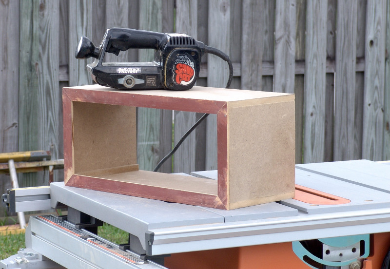

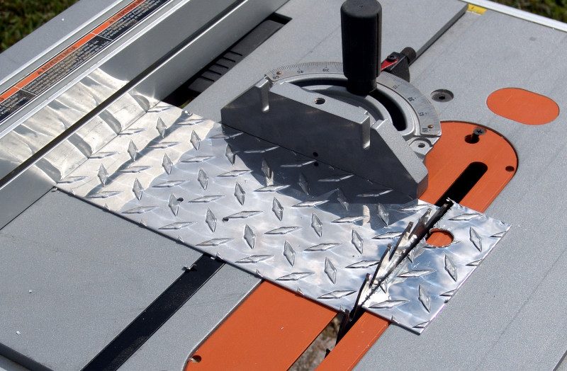

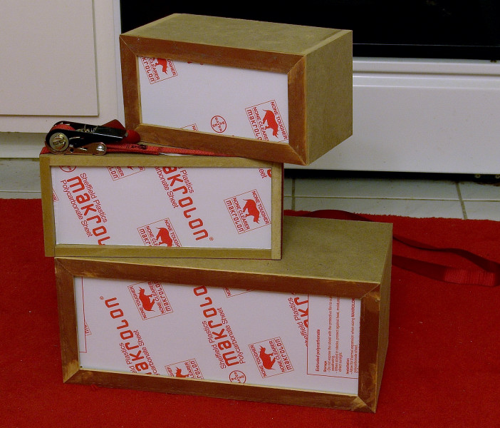

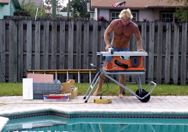

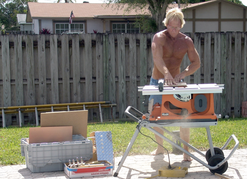

Working out the layout. Did a half baked version last night just to show the build is not that scary. The software I used did not have a four pole three position switch so I sort of made my own. I threw in a tube rectifier for the heck of it. Left out the NFB and changed the grid stopper values to 68k. Also left out the master volume and cathode capacitor and switch. Changed the pots to 1M and also the tone caps.
I got home last weekend just in time for some of the worst weather we have seen in a while. I planned to work on my amp cabinets last weekend, but it wasn't happening.
Florida is famous for hurricanes, but Florida also gets more tornados than any other state. Fortunately they are almost always weak and more of a nusiance than a real threat. The warnings were on the TV Sunday, Monday and Tuesday night. As usual, I ignored them. I got annoyed because the weather guy kept interrupting NCIS and NCIS-LA Tuesday yelling about SEVERE tornados. Ditto on the station 50 miles north of here. Well when I got to work on Wednesday I found out that an F2 tornado had touched down less than a mile from here destroying the homes of three coworkers. These are concrete block homes built to the strongest standards in the country.
Fortunately this weekend was nice. It was about 20 degrees warmer than I would like, but you can't have everything. I got the table saw out and set up the "Back Yard Amp Shop".
I made a chassis for Amp2.2 out of leftover pieces of aluminum. I started on one for Amp1.1 but didn't finish it yet. I started a cabinet for Amp2.2 out of a leftover piece of MDF. It is patterned after a Kustom K-200 that I took apart back in 1970. They are pretty easy to make. I made several like this back in the 70's but haven't made one since, so I had to change my mind 3 times and start over once. I couldn't remember how to make it.
I wasn't smart enough to think about where the exhaust from the table saw was pointing, so tomorrow I get to clean the MDF out of the pool filter. I might have time to cover the cabinet tonight, no tuck and roll like the old Kustoms, just black Tolex.
I know the deadline is approaching fast. I don't know if either amp will be finished in time. I could just slap something together just to be done in time, but I would rather make what I want. So keep watching, both of these guys will get built, and then I will make something BIG and LOUD!
Picture 1 - Setting up the Back Yard Amp Shop. Last spring is was the Back Yard Speaker Lab. I made two sets of high efficiency horns. It's just too hot for me to work outside in the summer. The chassis containing Amp2.2 is on the far left. Amp1.1's PC board is sticking out of the Office Depot box.
Picture 2 - Sawdust is flying......right into the pool.
Picture 3 - The semi - finished cabinet with the amp chassis inside. I haven't made the front panel yet.
If the weather permits, tomorrow I'll cut the front panel for amp 2.2 and start on Amp1.1.

George, it looks like you are having a tough time there by the pool working on those cabs (they really look nice). I bet it is rough work which requires a dip afterwards, but I'm sure you are up to it.
You know it. I only got wet 3 times yesterday. It is rare that I don't go in the pool all year round, although I don't stay in very long when the water temp is 60 degrees, or the air is in the 30's.

First picture: The Sand Cat (small belt sander) claws and scratches her way through my bad joints.

Third picture: The box is now ready for Tolex.

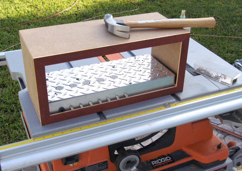

I realized that I had a few short minutes of dim daylight left, so I took the small box outside for some time with the Cat.
#1) Then There Were Three (where have I heard that before) The middle one is strapped together and missing its fascia (the red parts) The fascia is made out of a piece of trim that was ripped off my house during a hurricane. It has been in my garage for about 5 years, so I cut it up. Don't have enough for the third box.

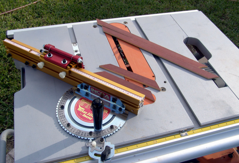

#2) The Incra is a cool tool for cutting any angle and making exact duplicates of a given length.
#3) I have been told not to cut aluminum on a table saw. I found that the brittle stuff cuts OK if you raise the blade so that the angle of attack is nearly perpendicular. Clean the aluminum out of each tooth of the balde after cutting with an Xacto knife.
