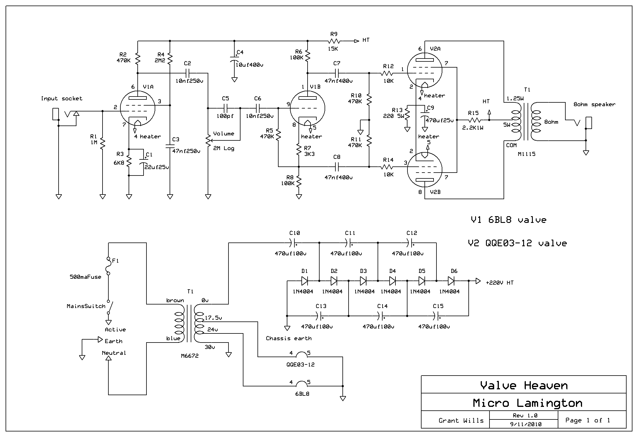

Some time ago, I set myself a AU$100 challenge - to build a 6W amp with speaker for less than $100 Australian. As some of you would be aware, transformers are a challenge here in Aust so I used a voltage multiplier and speaker line transformer. The schematic is attached, and the meandering thread descibing the process can be found here: And now for something completely different!!
