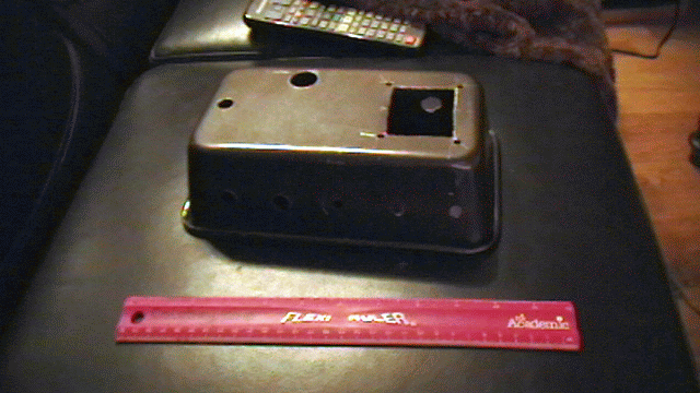

I am looking for the best amp that can be made for $99.99999 for THIS challenge. It is coming along slowly. New power transformers arrived today since the old one didn't like feeding 45 VA through 8 diodes. I did the proper Tubelab thing and got a bigger transformer.
While waiting for the new transformers for Amp 2.1, I decided to take the dead remains of AMP 1.0, resurrect it from the dead, and summons up the spirit of Mad Man Muntz to rid the carcass of all unnecesary components. The 5 tube amp (AMP 1.1) now has 3 tubes, makes 2 big watts of power when fully saturated and does a little over a watt cleanly. It does not slam into saturation but transitions into distortion gently and doesn't sound nasty when fully cranked. It is a big step above a "MINIMALLY USEABLE TUBE GUITAR PRACTICE AMP" and the total parts cost WITH a PC board is under $45. About $40 if PTP wired. ALL parts prices are from Mouser, Digikey, AES or ESRC.
Here is my chassis, about $5 in Ross...

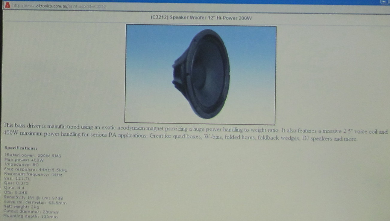

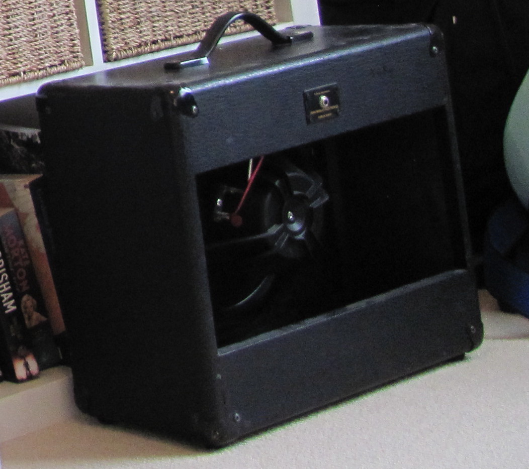

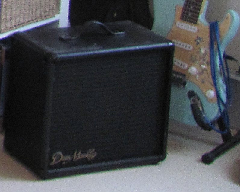

Spkr Cabs
My speaker cab and driver for prototyping amps is ;
Dean Markley 10" cab
with C3212 12" driver with neodymium magnet from Altronics.
The 97dB sensitivity means it works even for 1/2 watt amps.
They are on special every so often for $99
Slowly replacing all my guitar and bass amp drivers with this model.
Nice clear sound - easy to monitor tweak of amp circuit - and the weight saving is significant.
Cheers
JimG

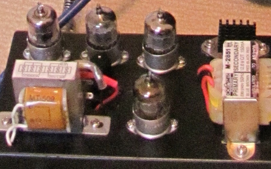

Igor: It lives...
6AK5 preamp, 6AK5 triode cathodyne, 2x 6AK5 pp output.
Newbie safe power supply from 9vac 1amp wall wart ($20) thro 12v6/240 transformer ($10).
0.33-5watt 100 volt line tfmr for output ($9.50).
Output 2v5 pp clean - 5v0 pp harmonically enriched (distorted ) - into 8 ohms.
Loud enough for the bedroom thro my 12'' speaker (see previous post).
Money left for a nice bottle of red.
Now for the tone tweaking. :note:
JimG

Igor?
This started out as an exercise using small signal tubes as output tubes - as per the Firefly clones - combined with inexpensive PA transformers.
I looked at self split initially but needed all the nudge (no grunt in these tubes 😛) available so added a cathodyne using Merlin's book :up: for guidance.
I have a bucket full of free 6AK5 tubes under the bed, and picked up 24x 100 volt line transformers for 10c each on ebay.
This is progress to date.
Suggestions and feedback appreciated.
Cheers
JimG
Cheers
JimG
