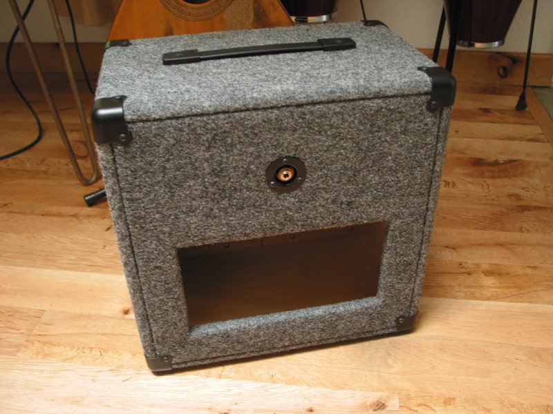

If the back opening of the cabinet is large enough vs it's internal volume to place the Helmholz resonance well below the lowest notes, then the enclosure should act like an open baffle and would be analyzed as such. There can be a lot of coloration depending on the 1/2 wave distance around the edge of the baffle. I would expect that and the driver characteristics to define the basic "sound" of the cabinet.
Actually I meant to say when the opening large enough to minimize the Helmholtz effect the enclosure acts as an open baffle.

Larger hole = higher tuning

My little 12 cabinet tunes below 200 Hz, but the effect is not huge for an opening this size.
The 1/2 wave baffle step is above 200 Hz...
This seems to work well with a stiff cone speaker like the C12R I have in there.

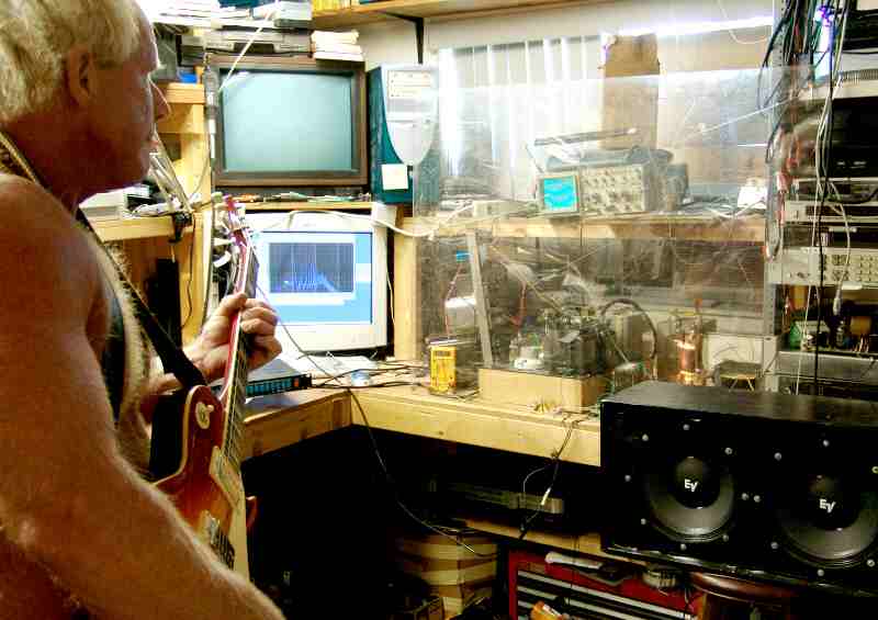

Just as a fiddle player in a bluegrass band wouldn't use a Stradivarius, my cabinets may be of no use to others, and as yet I have no sound samples, but I can share my designs. So far I have one complete guitar cabinet I made over 10 years ago. It can be seen in the lower right of the photo.
The speakers are Electro-Voice 10 inch guitar speakers which were obtained for $69 each at the grand opening sale of the now defunct Mars Music. I don't think they are made any more. These speakers can eat lotsawatts and were designed for a sealed box. I slapped this box together from 1/2 inch MDF. The inside dimensions are 24 inches by 12 inches by 8 inches deep. It likes big power and is seen here eating everything that my Uber Champ test amp running an 833A in SE on 1500 volts could dish out. Over 200 watts. Note the glowing 833A just above the left side of the speaker behind the blast shield. This cabinet sounds best doing a Jimi imitation at ear bleeding volume levels, so may not work for this challenge but I will try it.
I have another cabinet I made in wood shop class, but I still haven't put a speaker in it yet since I have no working amp yet. I went to Home Depot and bought a stack of pine and collected about 10 assorted budget speakers from 6 to 12 inches......stay tuned.

I need to make something that works first. Then maybe find a real guitar player for a demo. My left hand has become rather stiff and arthritic, goes numb a lot. Don't play guitar anymore.
5 years ago I could find a dozen good players at work. Most were laid off, and half of the building is now off limits. The metal shreader next door moved away and so did my daughters band mates. That is why I haven't done guitar amps in a long time.

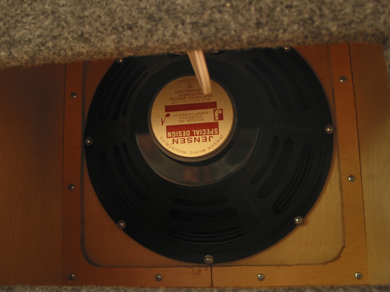

Nice cab, but how do you hold the front panel in?
Blind screws extending through the front panel before covering?
Yes.
The idea is tee-nuts inserted into counter-bored recesses before mounting the grille cloth. The speaker mounting screws thread into these as do the front panel mounting screws. The prototype here just uses sheet metal screws...

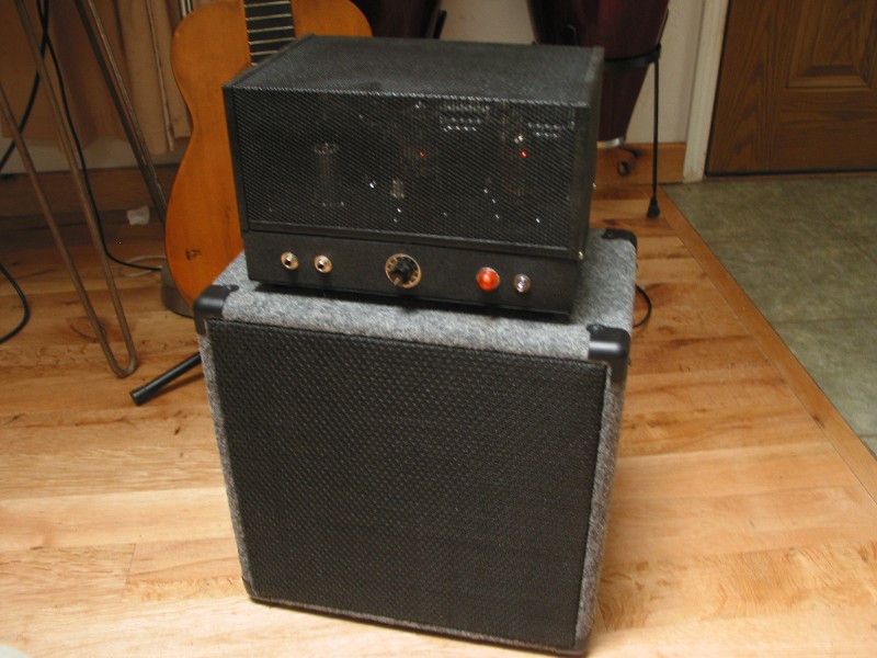

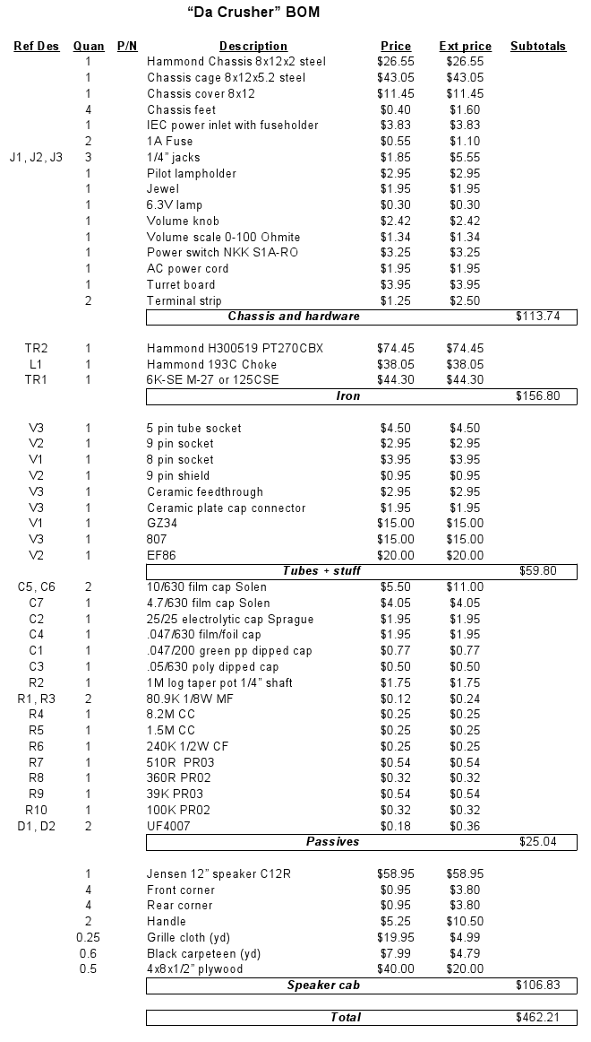

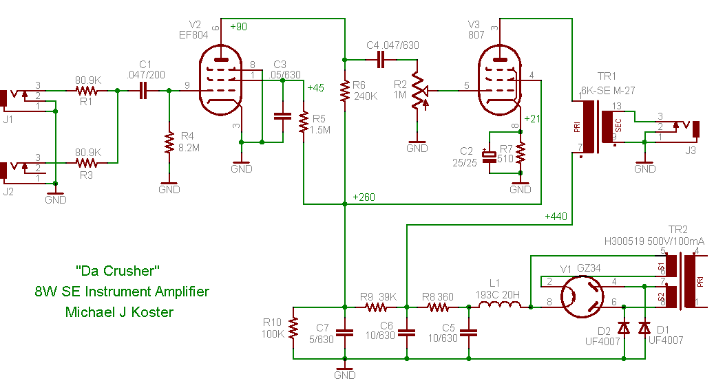

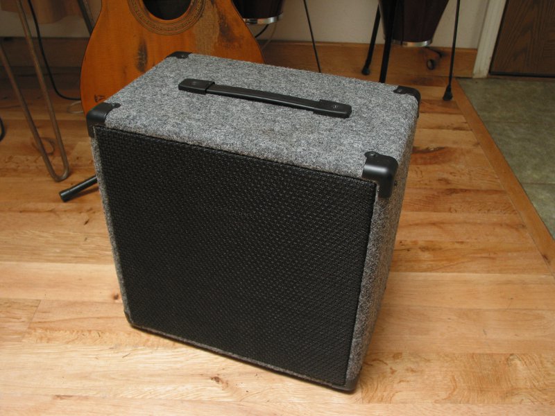

Here's my low cost DIY amp. It did go a little over the $100 budget at $469.66 but I priced in use a lot of parts I already had. It includes a 12" cabinet. I may have spent about $100 in additional parts. The parts are all off the shelf available in small quantities to DIY builders, e.g. uses a Hammond chassis, cover, and cage.
I'm still tweaking the voicing, however it's pretty usable as is. The cabinet is made from 2 layers of 1/2" Russian birch laminated together. The baffle is one thickness but is hardly more than a mounting ring.
The circuit is like the Fender Champ but adapted for the 807. It has a mostly clean tone with a nice smooth crunch coming on when digging in. The distortion comes mostly from the first stage as it's somewhat independent of the volume setting.
