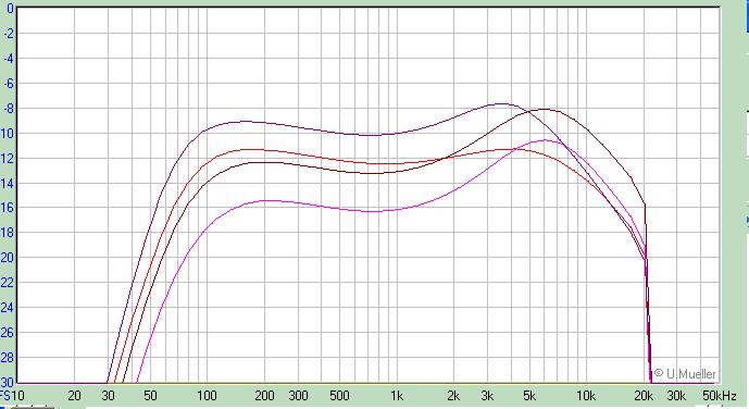

I keep my upper frequency -3dB limit below 10KHz for my guitar amps.
I suggest reducing you coupling cap values.
Coupling caps alter the low end and I suggest increasing them to reach the lowest note on a standard tuned 6 string of the low 80s or the low 40s if the plan is for a bass amp. Drop tunings are popular with lead guitar so 60 Hz might be a good compromise. I've simulated several popular guitar amps and most have a LF rolloff at ten Hz that compares to his 100 Hz referring to the curve in post #480.
HF rolloff is usually accomplished in guitar amps with the 68K grid stopper at the input jack forming a LP filter with the first tube's Miller capacitance. All the grid stoppers contribute to the HF rolloff.

What does it SOUND like? Not many people could figure out the sound from your graph. I think it measures the wrong thing

I don't think the spectra of a 1K signal says anything at all about a guitar amp. 1K is not realistic. try a sweep of the four octave sweep from 80Hz up. That is the range that is used. No point is showing those higher harmonics either as a typical guitar speaker has very little output above about 5KHz
