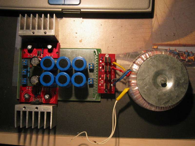

finally got round to doing it myself. It should look something like in the pic attached.
psu consists mainly of parts-bin stuff; 3x4700 40V BC components caps, 1x 1000uF Panasonic FC and a few 100 - 220 nF bipolar film caps (no brand?)
To complete this project i had to dismantle an older brianGT pcb-based clone.
Now all i have to do is find another enclosure, which is always the hardest part of building clones... 😉

matjans said:Now all i have to do is find another enclosure, which is always the hardest part of building clones... 😉
matjans, forget the enclosure for now, listen to the amp.
It will work without the enclosure.😀

matjans said:finally got round to doing it myself. It should look something like in the pic attached.
I need to implement this strategy with a very recent Brian GC kit (3875) I built. I got crappy results driving my bass bins with the kit as supplied. My setup looks exactly like what you have in your pic. Do you have a marked up schemo of what you did to Brian's kit? Or maybe I could just email and get some help. I can build the PS from Carlos's schemo but I'm a little sketchy of how to sync up Brian's wiring configuration from the PS board to the chip board.
What chip are you using?
Jim D.
if you mean subwoofers, the lm3875 probably can't deliver enough power. try using 3886's or something else like opa549's.
i've only replaced the 'original' 1000uF caps with 100uF's bypassed with 220nF bipolars on brian's board.

matjans said:if you mean subwoofers, the lm3875 probably can't deliver enough power. try using 3886's or something else like opa549's.
