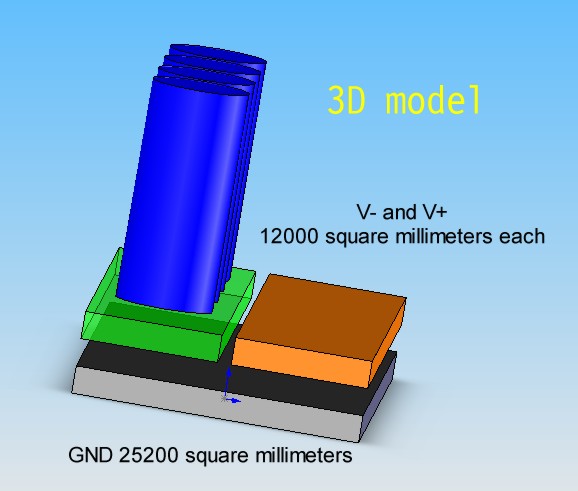

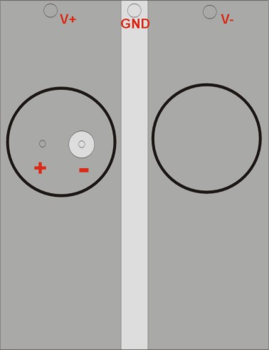

I am finishing my PSU.
I will use an two layer PCB. Top layer for V+ and V- and bottom layer for GND.
I think this way the PCB will make a small capacitor between the top layer and the bottom one.
The picture is just an example for 1 cap in each V+ and V- side.
I will use 6x 6,800uF per rail. I hope this solution will lower the ESR 😉

Can I test it in the output for the speaker ? (like it was for an Super Tweeter)

nina said:
IMHO, I'd go for no PCB instead. Using a think hard-wired solid copper wire connect the Caps's pin directly might be better -- unless your PCB have very "thick (+width)" copper trace.
I think the PCB is very width and I will choose the most thickness.
See the picture, I made a 3D Model with the two layers 😉
( V+ and V- on top and GND in the bottom)
I think this way the top layer will make a small capacitor with the bottom layer that could improve the PSU and the sound 🙂
I hope to be right. I will test it soon, than I will make a report. 😉
homer09 said:
Like a battery, a capacitor has two terminals. Inside the capacitor, the terminals connect to two metal plates separated by a dielectric. The dielectric can be air, paper, plastic or anything else that does not conduct electricity and keeps the plates from touching each other.
Copy paste from ---> http://electronics.howstuffworks.com/capacitor1.htm
The idea is to use the PCB as a capacitor and circuit. 😎
From what I normally see here, you only use de PCB as a circuit.
I understood how your PCB would act as a low capacitance capacitor, what i was asking is why do you think this will improve the sound or even have an effect on it?
For example,
When you use a Snubber the ringing is almost completely damped out except for the initial pulse.
When you use a small capacitor like 100nF the ringing doesn’t disappear but, the frequency is much lower.
(this is based in a PDF by Jim Hagerman and some carlosfm post’s)
I think this PCB design will act like a small capacitor and filter high frequencys.
I also want to try this PSU with the snubber and see( ear ) the results.
You will find out that the snubber is much more effective.
You can bypass as you want, parallel caps as you want, the result will not vary much.
