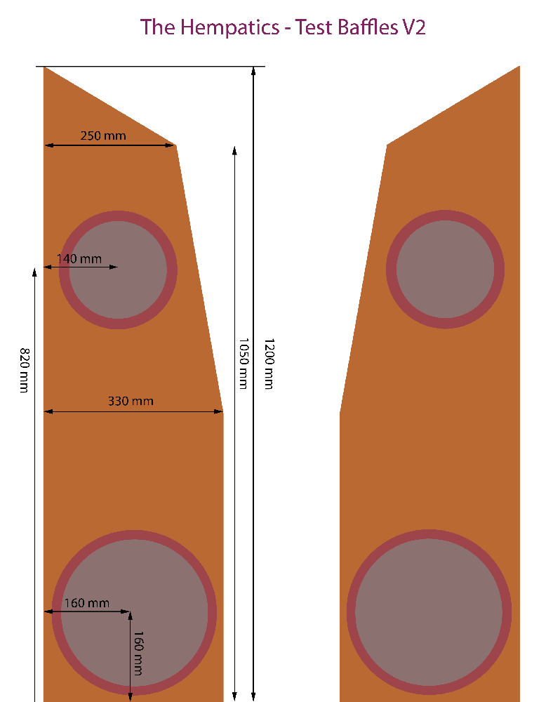

Test baffle v2
Here are the schemes and the simulation (for the FR) of the design v2 of my test baffles, with measures.
They will be in 18mm plywood. There will be wings for the woofers, with composite panels to allow me to try (and measure) the following configurations:
1. front woofer, wing L 33cm, wing R 14cm
2. front woofer, wing L 14cm, wing R 14cm
3. front woofer, wing L 33cm, wing R 28cm
4. side woofer (external), wing front 33cm (this is the front baffle, that u see in the picture), wing back 14cm
5. side woofer (external), wing front 33cm, wing back 28cm
6. side woofer (internal), wing front 33cm (this is the front baffle, that u see in the picture), wing back 14cm
7. side woofer (internal), wing front 33cm, wing back 28cm
I dont think that firing the woofers in the center of the scene is the best idea. I havent seen it realized anywhere. But for the sake of curiosity I will try it.
I may not try all seven setups, if one appears particularly bad, making the wings shorter or longer wont change much - the numbers are small.
Thanks to Rudolf's help, I decifrated MJK formula to calcolate the U-frame resonance. I dont have a top panel, but with the shorter wings i can also lie over the short panel and see if imroves things. My guts tells me that I'm better off a top panel for the u-frame, so I dint order those panels.
Because of this air, the resonance will be very weak probably to the point that I wont need to damp or equalize at all.
The crossover point is estimated at 200hz. It is obvious that up to 300hz the FR drivers will need some boost and i'll do that in digital.
Another thing about woofers is that I'm going to get a couple of absorbing panels to put on the back walls from 0 to 60cm. Because they sell a box of 8 panels and I need only two, I'm looking for a group buy.

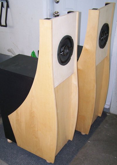

baffle v2 impressions
Lets start from the facts.
After two weeks during which I tinted the several little pieces of plywood, sanded and finally lacquered, 3 days ago I finally mounted the drivers in the baffles v2.
The panels were made exactly as designed by a very capable carpenter, which is now "my carpenter". As a first I put the longer wings, which are 33cm long, exactly as the front. Two of them (visible on the left speaker) have holes, which are filled by discs, taped in the inside. They were made this way to allow me to mount the woofers on the side.
But after I powered the speakers, the bass was so overwhelming and "right" that I'm not going to try a side-mounting. The issues of the back wall are way less than i have been told. Distance is only 70cm and CANNOT be more due to room furniture and listening position (center sear of a couch, at 1,9m).
At the same time, I cleared all the space behind the speakers. The Linns are in the right corner, which is a bit resonant area, and I think they help a bit like a bass trap.
Anyway measurements are still on the way: I tuned the speakers ALL by ear.
Below you see the picture of the current setup.
So, how they sound? Did the baffles v2 improved the Hemps?
You bet!
Let's start from the fullrange. The distortion is way lower. The ones who said that the pressed cardboard was culprit of most of it was right. Also, the EQ that i based on some measurements posted by a guy on diyaudio, NOW sounds right and they seem to fix most of the inherent non-linearities of the hemps.
I'm still considering finding better drivers for the task, but I dont feel the urge to anymore.
Now, the most amazing surprise. The bass. FANTASTIC. Much, much more that I expected. I started with the longer wings. Maybe I shouldnt have. I had to immediately reduce 8db on all the range (20-300hz) covered by the Beymas. Then, I also had to reduce the lowshelf @20hz of 10db to 8db. Whoever said that bass doesnt work in open baffle is an idiot.
I'm sure that my room compensate for most of the OB rolloff from 60 to 150hz and beyond. With the XTZ amp, i will probably not need any bass boost via software. Or i'll use just the latter, whichever sounds best.
Drivers on the floor play much softer, it is obvious, but the change has been dramatic also on the quality, the fullness. You need to look beyond the speakers to notice that there is no (closed) box. The bass is tight, fast, tuneful, as you would expect from the best speakers you can find.
Lastly, the blend between woofers and FR also improved from the positioning. The XO point remained at 300hz and I do not really feel a solution of continuity. A friend of mine told me that after I measure many things will change and the sound will improve. Curious to see which mistakes my ears have done 😉
