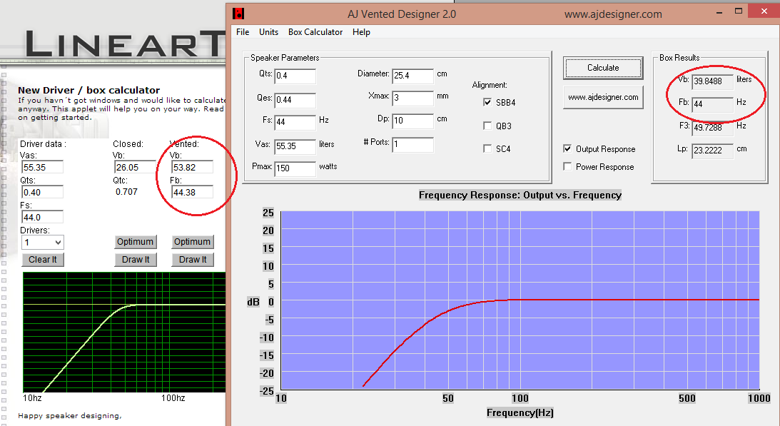

I really tried to construct it as well as I could (l am new to this, and trying to learn). I put the speakers into WinISD, and it said the tuning should be around 49hz. And that gave me the volume of a vented box at 107L for 2x HP 10W.
WinISD online I pressume. You should note it has a bug and calculates all cabinet volumes wrong. And thereby also all tuning frequencies and so on.
Could you please give some background information to that statement?
You can just check yourself against the actual formulas (or against any other online calculator).
It's only WinISD online that has the problem though. Download either of the full programs and numbers are correct.
I did actually use the downloaded version of it. I have also checked it with other

Haven't used WinISD in ages. Maybe the error from the online version has been implemented in the download version. I don't know, and I really don't care too much. I mostly calculate it with pen and paper anyways.
Here's a quick pic to illustrate the problem. Note that I didn't bother to plot in the Fs and left it at 44hz instead of 48.43hz. It makes no difference to the cabinet volume what the Fs is so I ignored it.
Btw, I can add that the correct result is neither of the two results from the calculators.
