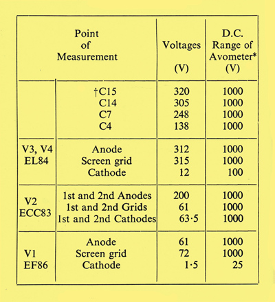

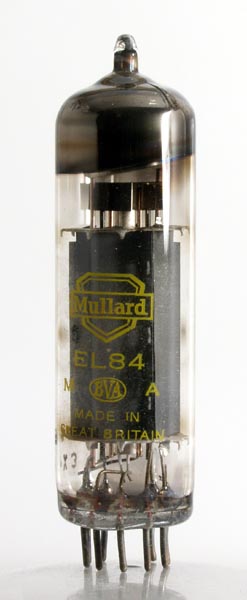

According to most data sheets I've seen the EL84/6BQ5 is only good for 300 V on the plates and screens. The schematic for the AA-151 here shows 355 V on the plates, and 360 V on the screens - Yikes! All I can figure is either the plate current is low, or those poor tubes are being beat to death!
Am I missing something here?
Hi Mr. Zenith
I seem to remember a comment by someone I used to work with years ago suggesting that the EL84 could be pushed way beyond it's usual operating parameters.
Have enclosed the 1961 & 1964 Mullard datasheets here.
They present operating graphs for both 250v & 300v.
So 355-360v is a bit above their expected application levels.
They also state the limiting value for the EL84 as 550v.
So maybe my old work mate was right. This is a very robust tube for it's size.
Looks like there's a fair amount of headroom here.
Maybe this has something to do with how good it sounds at an average level.
The EL84's in the amps I have here do get fairly hot at the 315v of Mullard's own design.

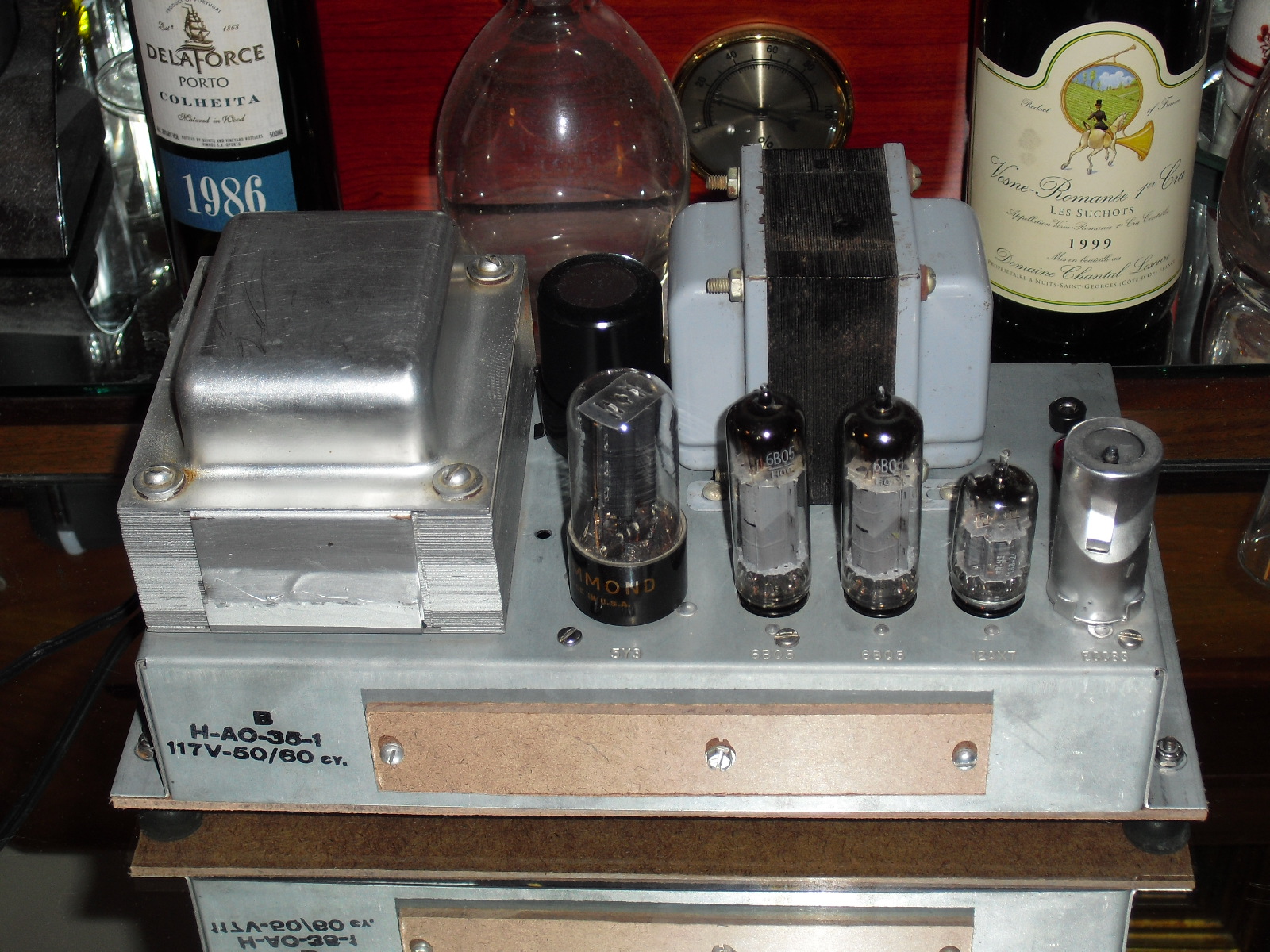

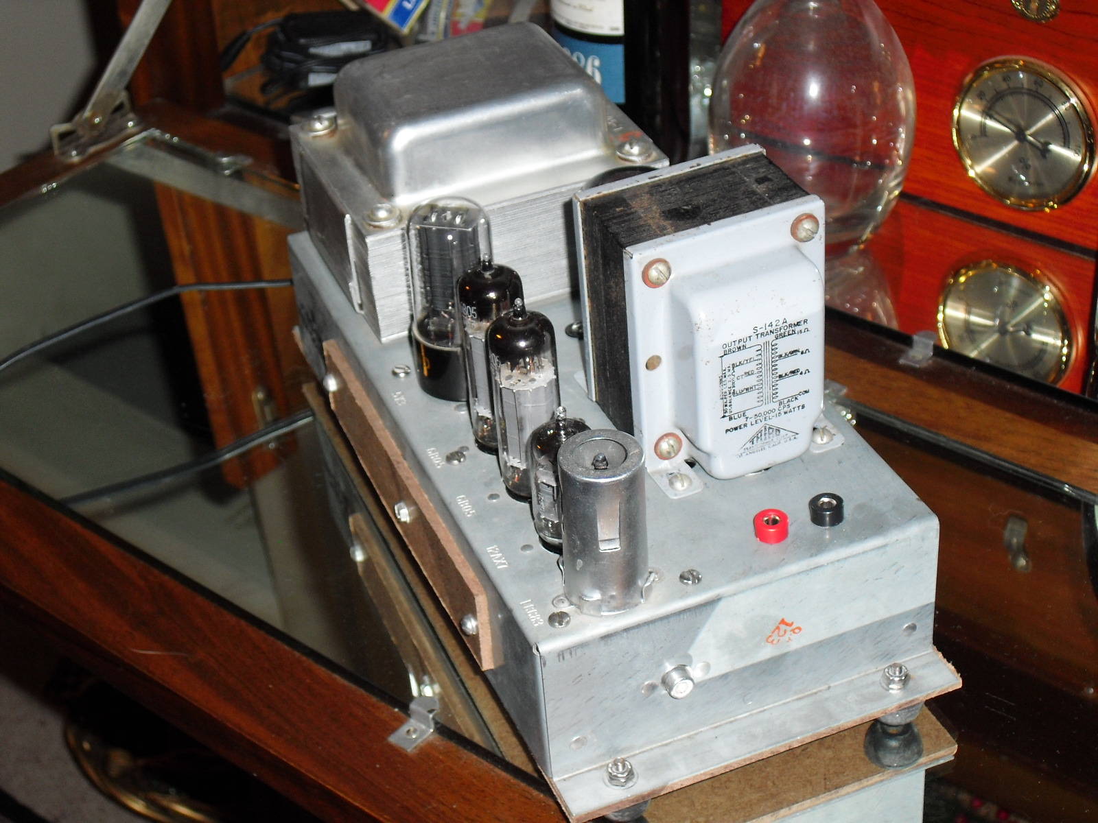

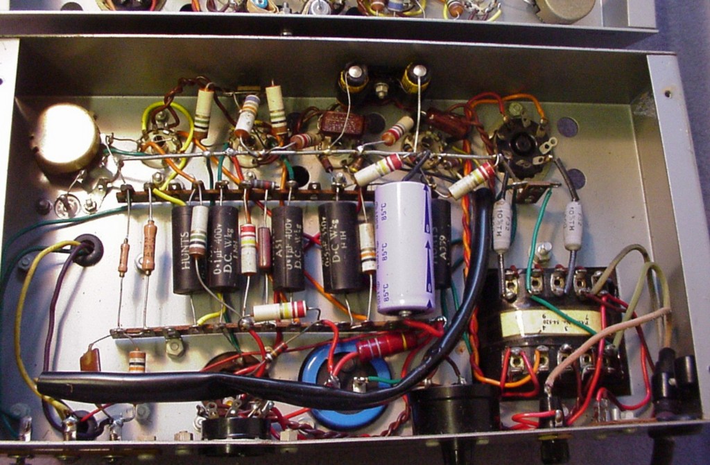

Thanks for pointing this out, as the user of the re-boxed AA-151 (photos earlier in this thread) seems delighted with the sound of it and seems to love the EL84 in general.
I assume their amp is running 360v from the original Heathkit transformer.
Might be worth checking out what VOX did and cranking it up a bit on my refurb.
I will certainly be fitting 450v components just in case.

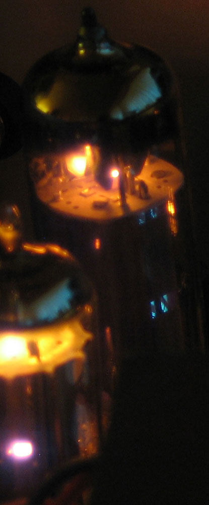

The EL84 glows BLUE when operating.
Those clever boffins at Mullard predated the trendy blue LED by 50 years !

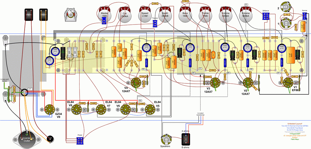

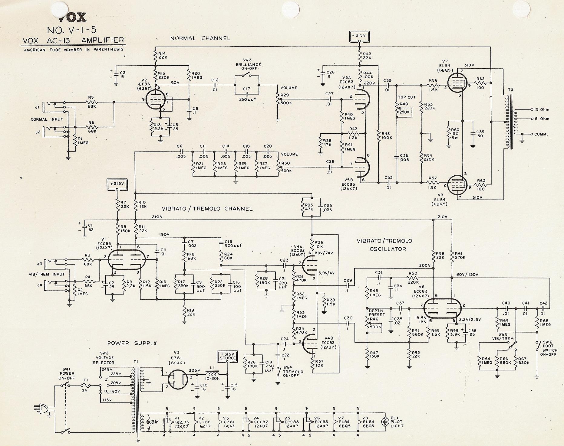

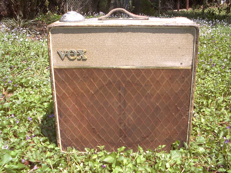

Two EL84's in the VOX AC-15 amplifier.
Thanks Mr. Zenith
Your comments on the EL84's driven to the max, reminded me of the VOX EL84 amps.
Did a bit of research today on 'The Jennings Organ Co' VOX AC-15.
2x EL84's with EF86 input tube, and an ECC83 thrown in as well, Great !
VOX seem to be stateing their output at 15w, 5w higher than the Mullard 5-10, and 3w higher than the Heathkit MA-12.
No transformer feedback on the VOX AC-15 either.
Do you have any favorite EL84 amps Mr. Zenith ?
Cheers...Simon...😀

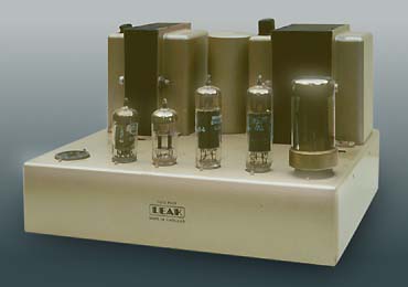

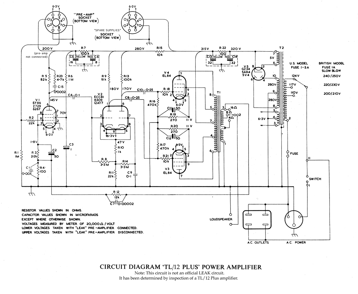

Another 2x EL84 Amp - The Leak TL/20 Plus.
The Leak 'TL/20 Plus', another nice little EL84 amplifier made in West London in the swinging sixties.

RE: #62
312 plate minus 12 cathode is 300V. Where is the overspec?
Excatly how (Cathode or GND) and which amp did you measure 360V?
Specs. are what one makes of them ?

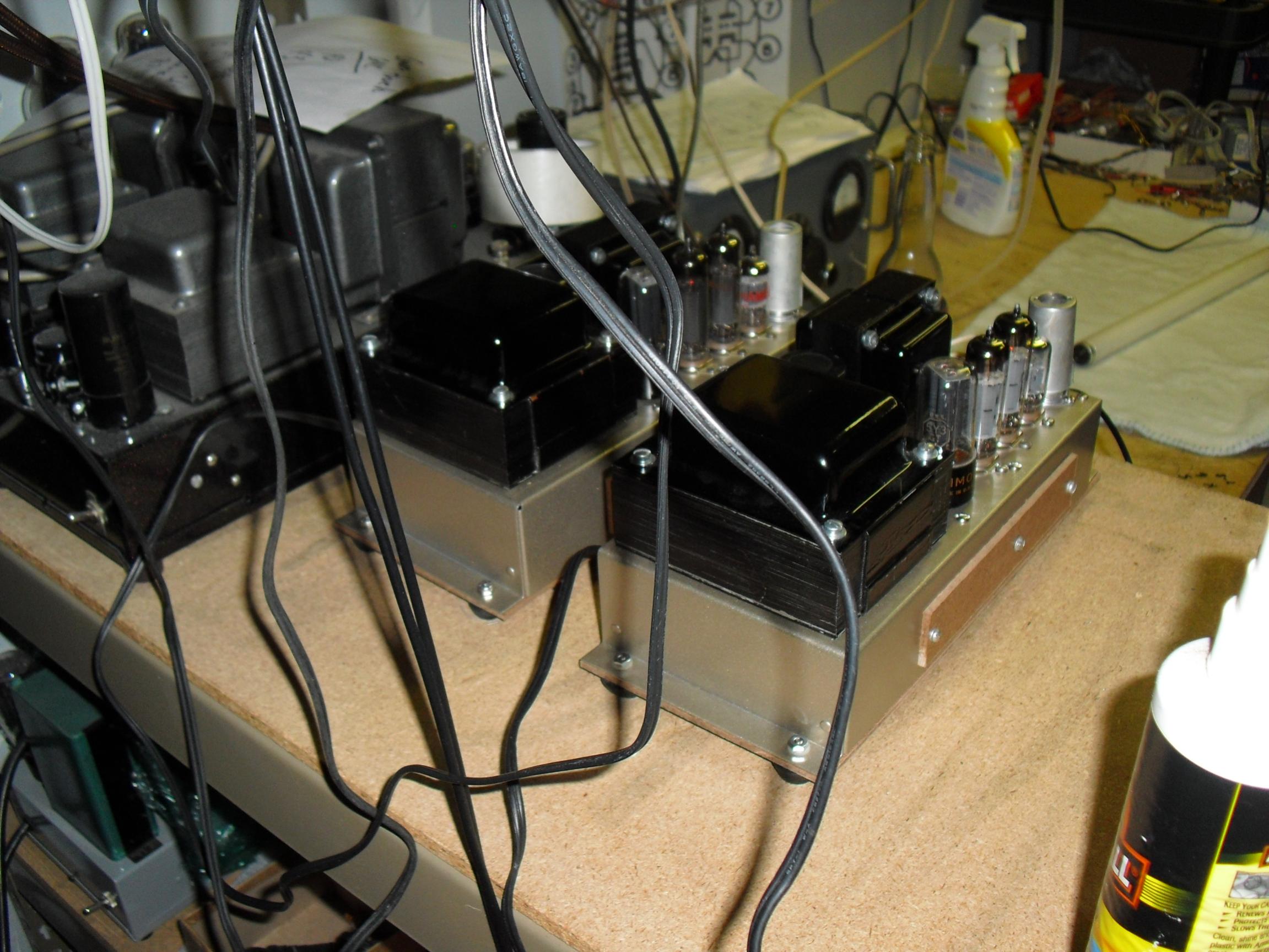

My Fisher X-100-3 w sockets labeled "7189" seems happy
enough with new JJ-EL84. Old 7189s found with amp were
unevenly lit, mixed bag that could not even claim to warm
at the same rate. Only one was an original Fisher (Mullard?).
I recall measuring 390 at the plate and 40 at the cathode...
Unfortunately, I don't recall measuring the screen.
Circuit is not a 5-10 clone, not that matters for purpose of
discussing EL84 operating voltage.
No screen glow, and the plates burn a dull brown/orange.
I've seen none of the blue that others report.
No, wait: I have seen blue w. Ruskie 6P14P-EB. But they
they didn't sound quite right at the original 7189's bias.
Nothing exploded due to voltages, they just didn't cross
smooth... Since the JJs worked with no hassle, I never
bothered dial in for any other EL84 types . Lazy I guess....

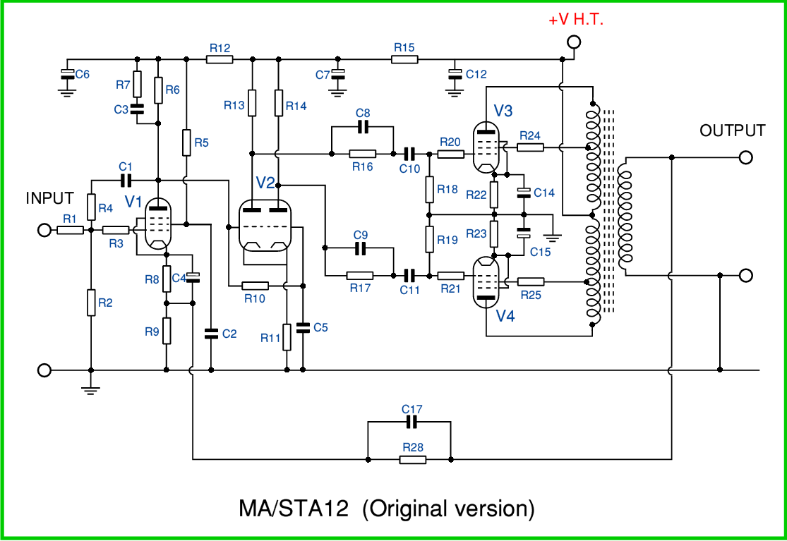

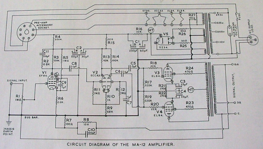

MASSIVE, MASSIVE SHOUT GOING OUT TO DIYAUDIO MEMBER - VOLKERW
Thanks again volkerw, I owe you $1,000,000 !!! You made my day as Clint once said.
volkerw mailed me this morning claiming to have a copy of one of the world's rarest circuit diagrams, you guessed it - The Heathkit MA-12.
And guess what ? HE DID !!! 😀😀😀
If any of you guy's out there can find another copy of it on the net, other than volkerw's, I would be prepared to offer a prize for endevour !!!
Having looked in every nook and crany on the net for WEEKS, I have to say that having searched for loads of schematics, for loads of things, over a long time, this one for some reason JUST ISN'T OUT THERE !!!
1,000,000 Million thanks again to volkerw & diyAudio for making it happen.
And without further ado about nothing - HERE IS TTHHEE HEATHKIT MA-12 !!!

6K version progressing
I have started assembling the 6K version. I was going for a classic UK look with a gold chassis and black transformers. Between the finished end bells and the top mounted tube sockets, it is ending up looking more like an early 1960's Japanese copy of a classic 1960's UK amp. It's not a bad thing and no offense is intended - I've yet to see a 1960's tube amp from anywhere that bothered me. My two gripes as I go forward are the position of the volume pot with relation to the input jack and the cheesy binding posts. I have used recycled organ amp chassis to save me the aggravation of sourcing a power transformer and cutting the socket holes correctly. The tube sockets were marked from the factory back when made 50 years ago. I can either ignore the difference between the input tube as marked (ECC83) and build it original (EF86). Or I can change the circuit to a triode input and use half a 12AX7. Not sure which direction I'll go - updates as I proceed if there is any interest in progress.

I have finally finished the 6K version of the classic Mullard 5-10. Nice sound and good looks. I still regret my choice of speaker terminals but will have to live with it. The parts selection was a little more stringent than with the 8K UL test mules. It is necessary, in my opinion, to fit a volume pot to these amps. The gain of the amps is such that they will be overdriven if the volume control of an average preamp is turned above the 3PM position (assuming the use of high efficiency speakers). The volume control is also nice if one wants to forego a preamp. Otherwise it can be used to dial in the correct gain for the user's choice of preamp and speaker.
