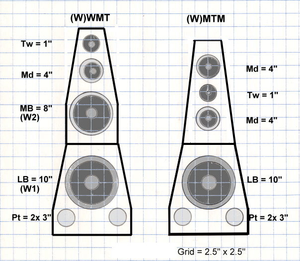

2.5-Way design? Indispensable? Can you expand on that?.
Steve/bluewizard
I apologise for the misunderstanding and thought your plan was a 2.5 way.
A 3 way with the woofer crossed to the mid at the baffle step will obviate the need for the extra 0.5. Can't figure out how an extra woofer will help, unless you want to extend the low end as low as possible by adding a subwoofer driver, crossed at about 80-100 Hz to your "woofer".

I understand the concept of the weaker driver setting the limits for the system. But I'm not quite sure how this is solved with a separate Low-Bass amp. Likely, with a separate amp, I would have to turn the 10" down to level match the 8".
The Dayton Classic 8" (for illustration) -
60w RMS / 120w peak
8 ohms
29hz to 3khz
88dB / 1W / 1m
Sd (relative) = 1.0
Sd = 211.2 cm²
Dayton Classic 10" -
70w RMS / 140w peak
8 ohms
25hz to 2.5khz
89dB/ 1w / 1m
Sd(r) = 1.63 (Meaning 63% more Sd than the 8")
Sd = 343.1 cm²
I don't see the gap between them as that great.
One alternative, would be to built the top section 3-way, then in a separate larger box, add another second 8" in a similar configuration to the original drawing on the Left. The larger box should allow the second 8" to go down as low as it is capable of going. But, I still like the idea of using the 10". But at the same time, I'm more than willing to learn that despite looking cool, it may not be a realistically functional idea.
But, if it is potentially functional, I'd like to know that too.
I'm also well aware that I can do anything I want, and yes, when I play music, I will hear music. But after spending all the time and money, I'd like the music to actually sound good; at least sound in reasonable proportion to the quality of components I used.
This is one of those ideas that pops into your head, and you just can't get rid of it. I still think it is a cool concept, but I also confess, I've never seen anything like it.

The 0.5 way principle really comes into its own for 2.5 ways and
3.5 ways with a relatively high x/o point for the midrange driver.
Makes a lot of sense in this design : Zaph|Audio - ZDT3.5
For a narrow MTM atop a pyramidal bass unit, making the MTM effectively
a 0.5 way in the midrange can make a lot of sense for some drivers.
rgds, sreten.
"For a narrow MTM atop a pyramidal bass unit, making the MTM effectively
a 0.5 way in the midrange can make a lot of sense for some drivers."
Could you clarify that. It sounds like you are saying make the MTM a 2.5-way, and let the Lower Pyramid cabinet be a straight up "W" bass driver.
It seems, if I understood the first part of your statement correctly, I've been somewhat going in the oppossite direction. I've been trying to make the Mid-Bass/Mid-Range crossover as low as possible, and I hear you saying (if I understand correctly) that I should have been looking at higher Mid-Bass/Mid-Range crossovers.
I'll read the ZAPH article and see what it has to say.
Again, thanks to all who are taking the time to respond.
Steve/bluewizard
True. If your looking at a low mid x/o point, two drivers and 0.5
way on the bass makes little sense compared to other options.
It makes more sense to 2.5 way a 2 way MTM top arrangement,
if the MTM is very narrow with a high BS transition frequency.
(And the drivers suit the full 6dB BSC of the 0.5 way arrangement)

I was planning to use one or two Dayton Reference 3" or 4" full range; depending on which project. Because they are full range they can pretty much support any crossover point without restriction ... above 100hz that is.
I guess because they can go so low, I was fixated on a low crossover. '
Using my drawing on the RIGHT, the MTM, with a W in a separate box. The baffle width for 4" speakers seems to be about 7.5 inches. That may not be right in practice, but it serves as an illustration for now. That equals a 608hz Baffle Step Frequency.
Using the formula F3 = 380/Wb.
Certainly the 10" bass driver will have no trouble going up to 600hz. But do I let the Mid go down as far as they can (80hz rated), or do I treat the system as a 3-way. I guess with a 10" bass driver, the 4" really don't add that much, so I might as well treat is as a 3-way. Tentatively with crossovers at 600 and using the 3-octave guideline, 4800hz. Though I notice the virtually no one adheres to the 3-octive midrange rigidly.
With a roughly +4khz Mid/High crossover, I should have a vast selection of tweeters to choose from.
As this discussion compels me to ponder the potential problems, as has been mentioned there is an in room boost to the bass. But with the 10" relatively close to the floor, can I count on a floor boundary boost? And with all that boost, can two 4" Mid driver in Series keep up? I suppose rather than 2x 4ohm in series, I could use to 8 ohm in parallel, but one of my other design objectives was to create a speaker as close to 8 ohms as possible. But I can probably get by with 4 ohms in the Midrange.
Logically, I should probably start with the (W)MTM. Once I have the lower bass box, I can try various configurations of that bass box with existing full range speakers just to see if there is someway to make it work. If I can reasonably find a framework in which it works, I can then go ahead and build the 8" 3-way.
The problem is, I'm obsessed with the original 3.5-way design because I think it would make a very cool looking speaker with the tapered boxes. But, am I willing to trade "looks cool" for "sounds good". I don't think that is a trade off I can make. But, if I can think of a way to make it sound good, then I'm certainly willing to give it a try.
Again, thanks to all who replied. Even though I'm starting to see the folly of the design, I still want it to work.

The driver arrangement could be made to work if you know what you are doing,
(modelling), with BSC aspects to the slopes of all the three bottom drivers,
and thus the relative senstivities of all three chosen drivers, its complicated.
Chuck in boundary reinforcement and its gets even more complicated.
rgds, sreten.
Again, thanks to everyone for taking the time to help on this.
I have conceived of a new variation on this theme. If we still accept the Tapered Bass Box, but continue the slopes of the box up into the MTM upper box, how does that confuse the BSC. Referring to the sketch on the RIGHT.
The upper box would be a Midrange/tweeter/Midrange with all the bass handled by the lower box. Not that is Mid-RANGE not Mid-Bass.
But by continuing on with the sloping sides of the lower cabinet consistently up into the sloping sides of the upper box, I have have two Baffle Steps, one at the lower Mid Driver where the cabinet is wider, and another at the upper Mid where the box is lower.
I'm guessing about 8" (from the drawing grid) at the bottom Midrange and about 6" at the top Midrange. Though likely, the bottom cabinet will be slightly larger than shown, making the width of the top section also slightly larger. (8" = f3 = 570hz, 6" = f3 = 760hz)
See attached Diagram.
