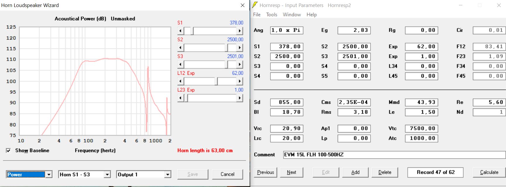

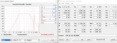

Hi Schlager, I seem to recognize these midbass horns. My friend picked them up for me some months ago and it took some other months to get them from Denmark to my place. Now they are waiting in my garage for a bit of cosmetic overhaul. Is there any chance you still have the Hornresp file for these? I figured one out by measurement of the dimensions. I would like to try to extend the throat to try out 8PE21s in them.
If you remember, I would also appreciate some information about the type of finish you used. Basically, I would like to sand them a bit down and spray or paint black.
Some of the horn is actually made of kitchen doors, they were very heavy I remember. The curved sides inside the horn is mdf board. You should be able to sand them down a bit and then paint them, enjoy 🙂
