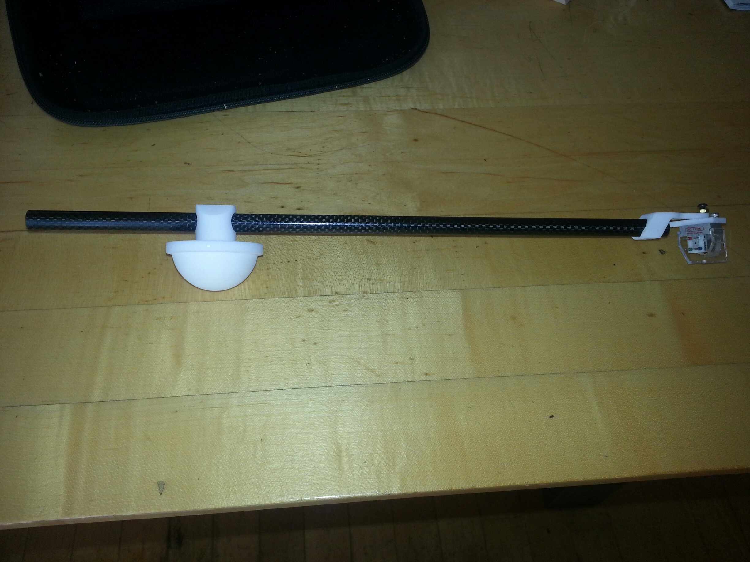

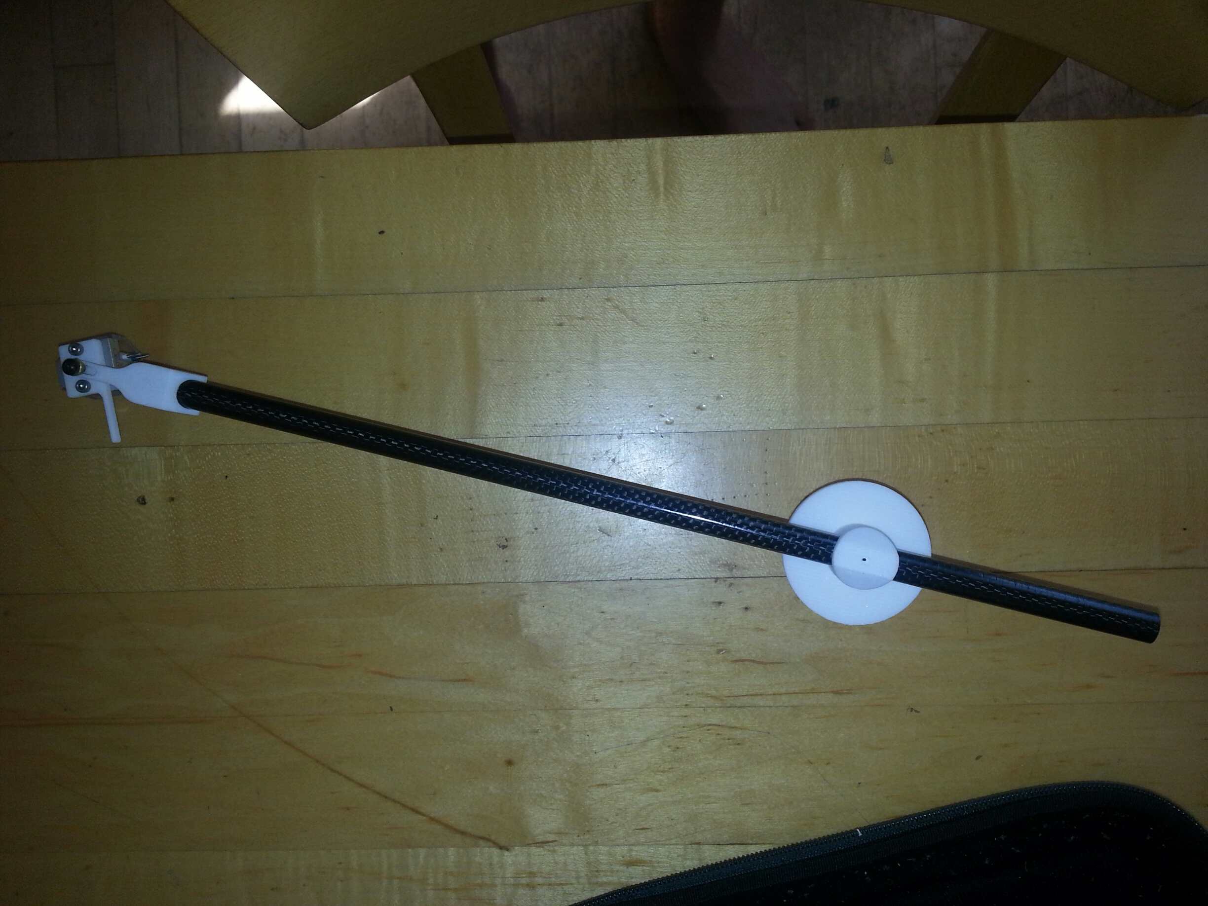

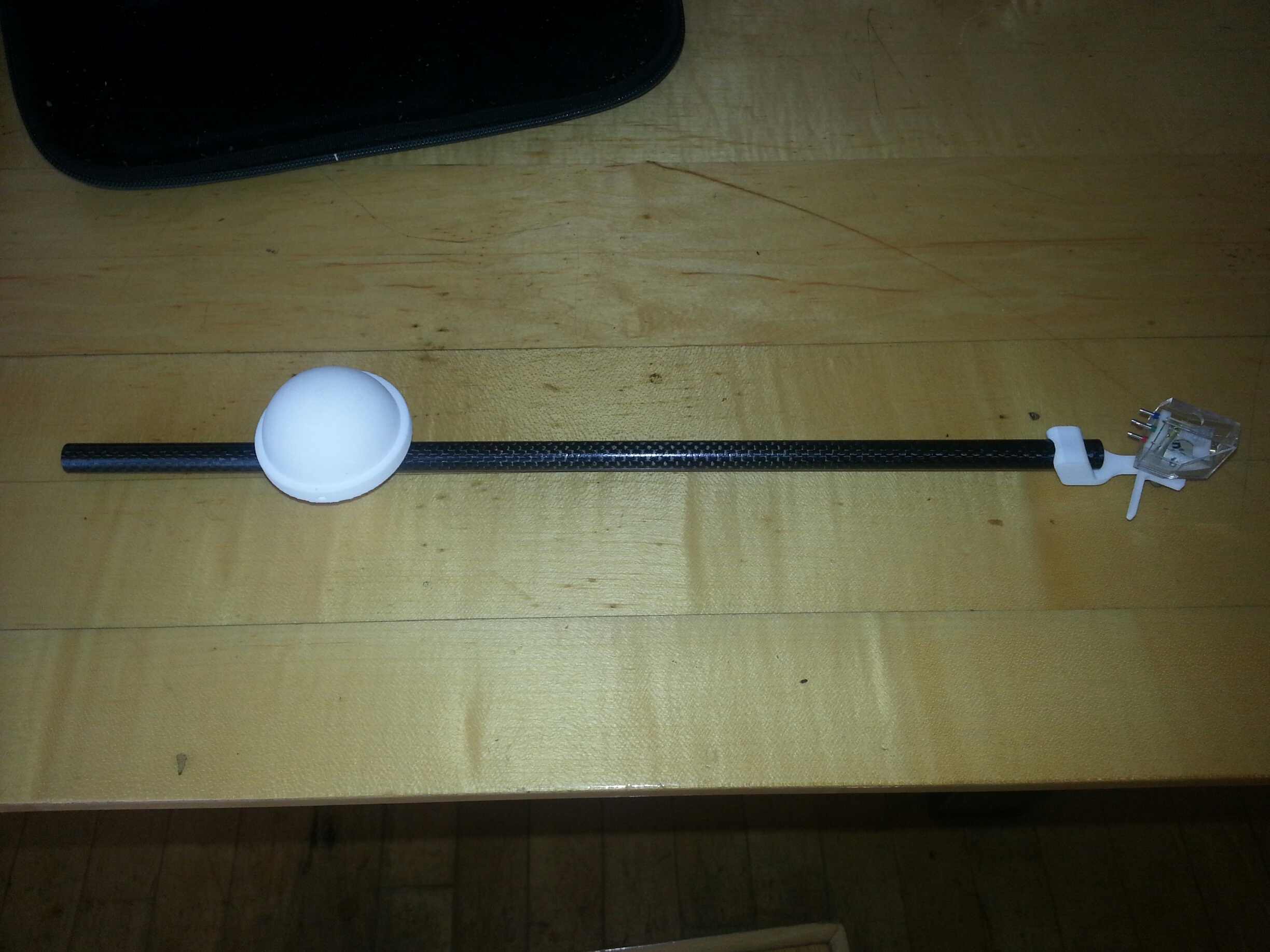

I am also building a tonearm.
The tube is precission carbon fiber.

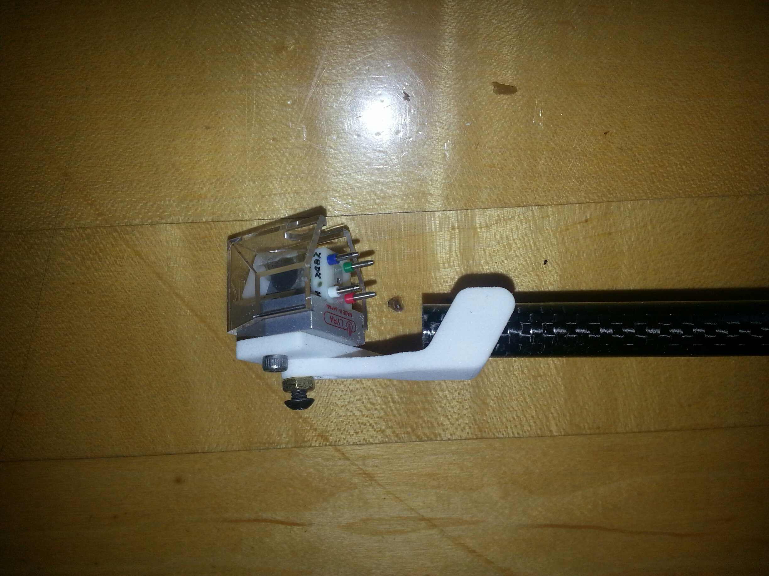

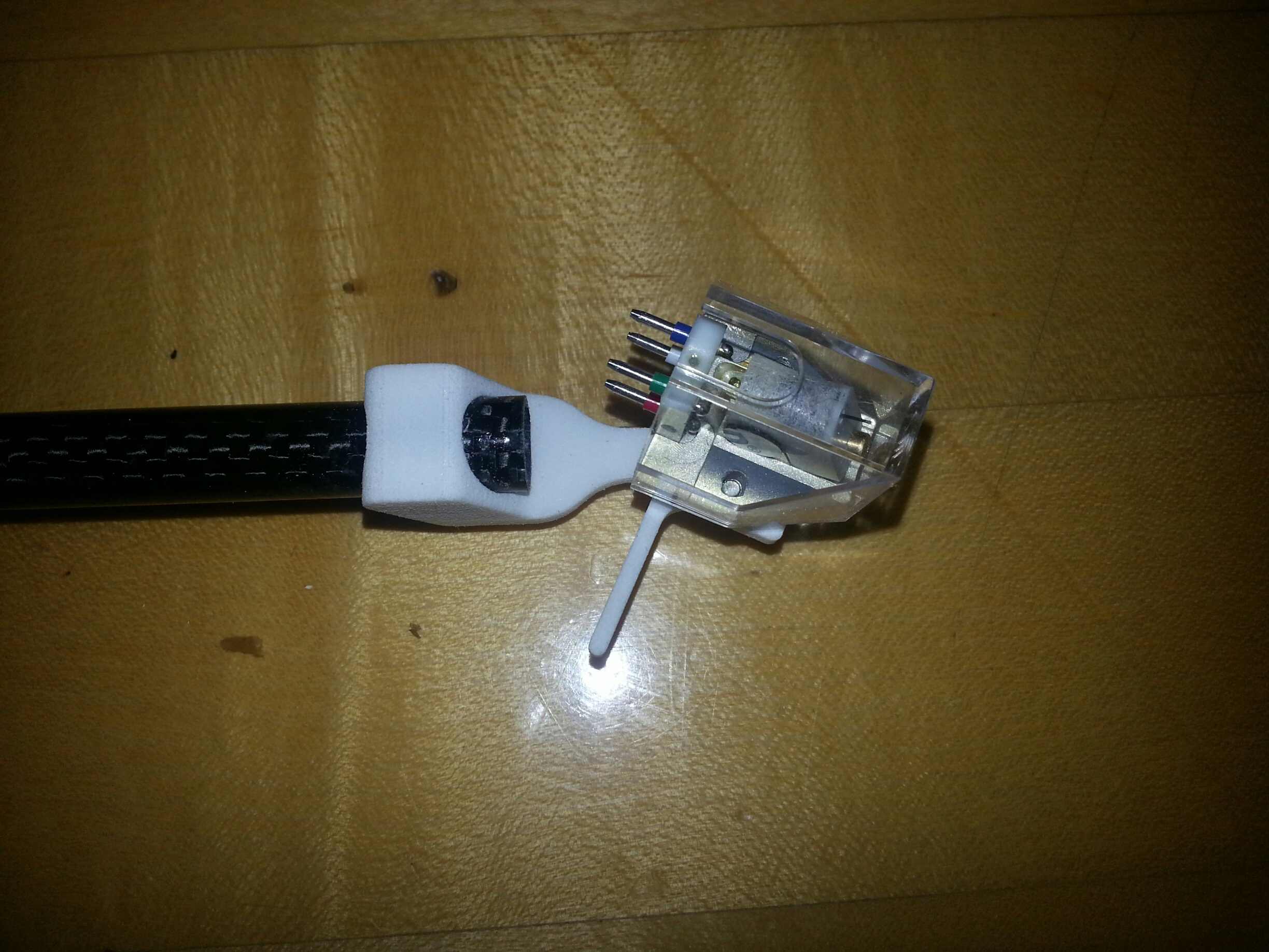

The white parts come out of the 3D printer.
It works after the Well Tempered system.
Dominik has designed the parts.
The arm has some unusual proportions.
I arived at the values because i started with a 270mm Pivot to Spindel distance.
Compatibility is not important for me.
Effective Length : 284.8 mm = 11.2" so a bit shorter then 12"
Overhang 14.77 mm
Offset Angle : 19.156°
Linear Offset : 93.445mm
Inner Groove : 60,325 mm
Outer Groove : 146.05 mm
Inner Null : 70.285 mm
Outer Null : 116.604 mm
Maximum Error : 1.63°
Maximum Distortion : 0.816 %
Average Distortion : 0.297 %
This is a Löfgren B alignment.

Looks like a golf ball and carbon fiber club shaft could work too. 🙂
The tube is precision carbon fiber. The white parts come out of the 3D printer.
This is great, there's a lot of potential in printed tone arms. Are you thinking of sometime making one printed piece that includes the arm tube?
I am also building a tonearm ...
...It works after the Well Tempered system.

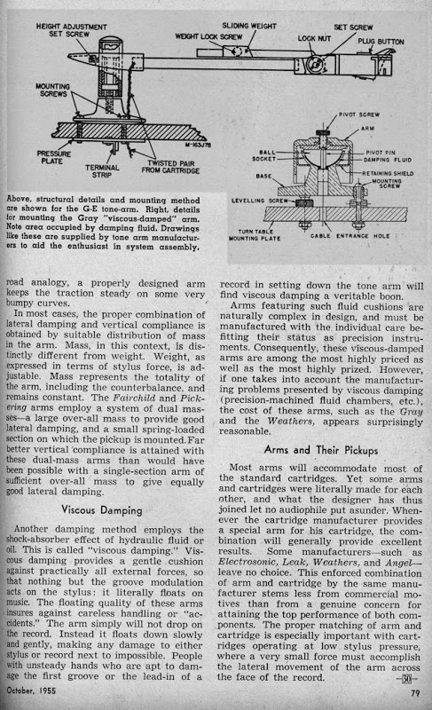

Or, like the vintage "Gray viscous-damped arm" ... could be .
A complete arm could be 3D printed.
VPI has a commercial model i think.
At this moment i prefer the carbon tube.
It is more ridgid then a printed alternative i think but 3D printing moves on so we will see more printed arms in the future.
If i will make one ? Who knows, maybe.
Carolus, when you search hard and long enough you may find more or less every principle has being tried in the past to make a tonearm.
The Well Tempered principle is attractive for DIY because it is so simple and gives good results.

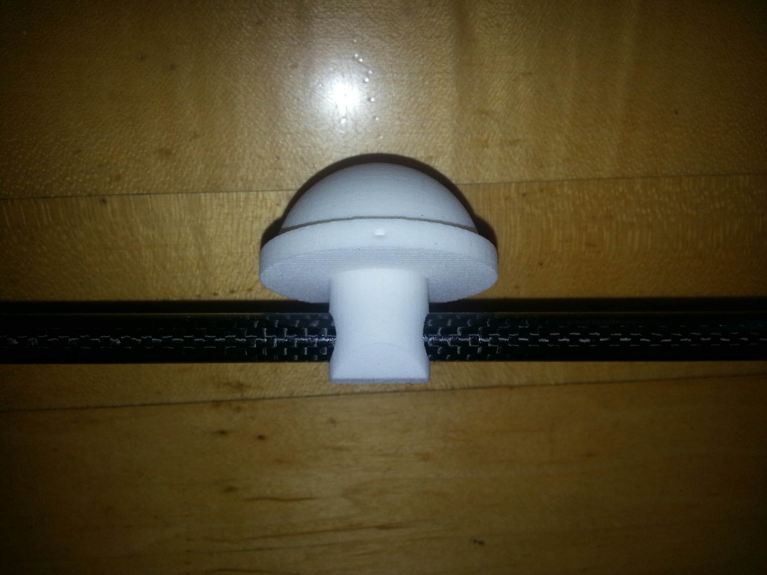

I have not totally given up to lift the platter on magnets. We then whould need magnetic rings with a hole in the midle.
The Spiral Groove SG1 does that. I heard a small improvement but it was in no way radical.
cool. seems like the centriod is calculated minus the compliance or spring force of the cartridge. else the centriod would extend past the bearing cage. Would be neet to fond out if the bearing axis is angled from the perpendicular, again aligning to the centriod and moment.
