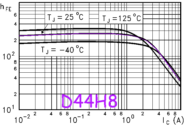

> interesting if there were some transfer function for hfe
There is. Are!
1) There's the datasheet. Shows some marketing idealization of hFE vs current. The D44H8 sheet suggests "some" fall-off before you get up to the ~~3.5A that 30V supplies promise. Some droop below 100mA. And this is one of the flatter hFE curves I have seen. But always take datasheet "typical" with a large grain of salt.
2) There's A.S. Grove 1967 Physics and Technology of Semiconductor Devices, sections 7.2 and 7.3. Low current hFE is dominated by recombination. At high current the injected carrier concentration exceeds the base doping concentration, so it isn't the transistor you thought you made/bought. Modular Series on Solid State Devices: Volume III: The Bipolar Junction Transistor George W. Neudeck 1989 probably has more gruesome details, but is tough to chew.
3) And if you prefer to believe SPICE, plot hFE vs current over a wide range for some reasonable Vce. What you are really doing is making a picture of 2 or 3 parameters in your SPICE model. IK shapes the top end, and ratios of several other parameters seem to set the slope on the low side.
If the stages were designed with some "slugging" resistances so hFE mattered less, this might be minor. But you've stripped it down so the gain is dominated by final stage hFE and similar poorly-controlled parameters.

Then we have the thing about the behavior of hfe. The curves that you show are the usual ones. It's seems that the hfe varies quite a lot. I will now conduct an experiment with my simulator to figure out whether it simulates these curves reasonably good.
I will be back with the results.
I'm back with results of my simulator.
From 50mA to 2.5A it reports an increase of 77 to 101.
PRR: Your submitted sheet must be wrong, the figures are unrealistically good. The real specs shows an increase of ( from 0.05 to 2.5A ) 80 to 125.
Lets say the simulator is wrong with 50%. That will probably generate THD figures that are not more than - generously - double as good as of the real circuit.
When using the FJAF4210Y/42310Y that has a larger beta, the figures probably will match my simulation.
So I think we must have some sort of gut feeling of what makes sense in this particular circuit.
I snipped that image from the ST sheet.
I now see that the Fairchild sheet gives a different curve.
I do remember saying, though, that "SPICE has an in-built assumption (unless specifically declared) on low-I fall-off which seems to be pessimistic for many modern device processes (recombination is not as bad as the old days)."
hFE *WILL* fall-off at low and high currents. But what is "low" or "high" depends a lot on process parameters. Generally, on a more complete sheet, there may be Min hFE specs for several currents, but a Max hFE is usually specified for some medium current. This cleverly avoids specifying just where hFE falls off, and leaves leeway for "better" processes, or not, at the maker's convenience.
Thank's PRR for digging up this information. I think not many knows the mathematical behavior of the hfe since most constructions simply relies on approximations.
Whats interesting in this very case is the un-linearity of it since that is what creates the distortion. I found out that my simulator indeed estimated a proper "curvation" even though it was bended "the other way around". So regarding the amount of cross over dist, my simulator probably gives a worse result than real life.
