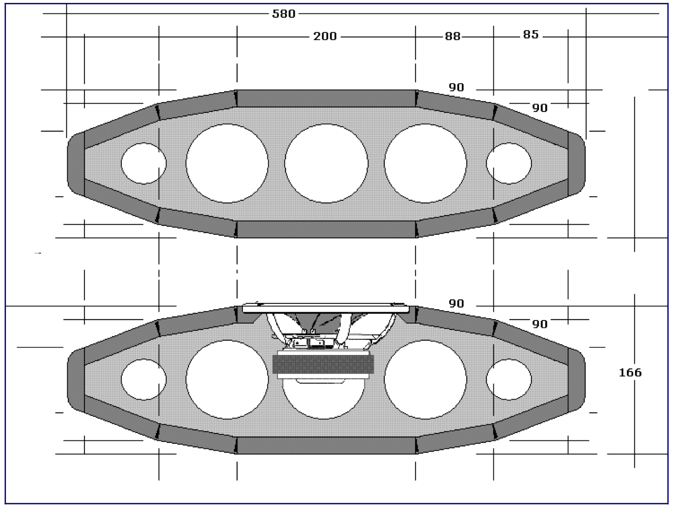

These were inspired by Ellipsa, we even just call them the Eipses
And i note that the link to Troels in the thread that got me here, has much the same polygonal shape the above started out as… but Chris decided to make those a proper curve. Troeals beat us by over a decade (but i had never seen his project).

Elipsa wide baffle speakers
