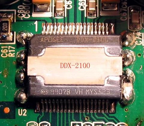

I have a few evaluation boards with various DDX controller chips. I like them a lot.
Neil D probably knows these chips the best, in fact he has a couple of my eval boards that he is doing surgery on.
The nice thing about the these chips is that they take an I2S signal in and give you the PWM out. So you don't need no stinkin' DAC or preamp. Just digital. And that has some definite sonic advantages.
What I like about them:
What I don't like about them
I do think this type of digital to PWM amp is the wave of the future. Done right, the results can be quite surprising. And as Neil says, there is the possibility of DSP EQ and crossovers right there in the amp. Pretty cool. 😎
- Very high S/N ratio. You just don't hear noise. They are clean, clean, clean. As there are no analog stages before the DDX chip, you don't have the buzzes, hums, hiss, etc. that analog stages can bring. What you will hear is a lot of noise IN the original recordings. Maybe a little too reviling!
- The amp can be set to shut off when it receives a string of zeros. So it auto-mutes between tracks or during pause/stop. Dead silence. That's nice.
- Detail is rather amazing. Going straight from the digital signal to the PWM signal seems to mean a lot less error. Detail goes way up. As good as a very expensive, well built analog signal chain for a lot less money and fewer parts.
- The quiet and detail really bring out a lot of the music you didn't know whas there.
- I2S is the standard input so you need a receiver chip to go from spdif or toslink. But so do most DAC chips.
- If the receiver chip is not well implemented it will pass the jitter along to the DDX. This sounds awful. If you don't think interconnects make a difference, just try a few different ones with these eval boards. Yikes! Getting the right cable is a must. Reclocking would be even better.
- My eval boards sound a bit "thin". Don't know if that's the chip, or just the way the board is laid out and the components used. I did mod a few and got better results, but no quite as full sounding as I'd like. Need to dig into that more.

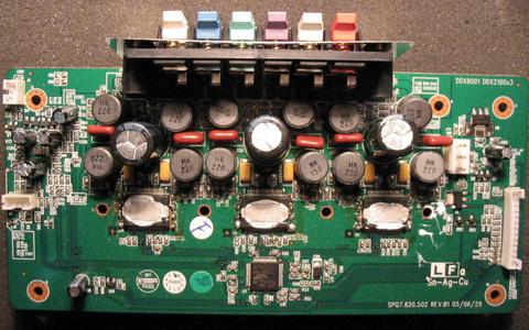

I'm still in for one of these but I need help getting one!
I got a message from cac liu but when I mail him back all I get is chinese again
Panda do you want to sell me yours?
panomaniac said:And as Neil says, there is the possibility of DSP EQ and crossovers right there in the amp. Pretty cool. 😎
The amp has some built-in "auto" modes that provide a 5-band Equalizer and some preset EQ settings. The interface that I've got will let you play with them. But if you have a way of calculating the biquad coefficients yourself, the amp becomes very interesting. There is a briefing that I gave at DCDIY this past weekend that describes some of the capabilities:
DIY Digital Crossovers
Michael--the second amp is almost done, and I'll get it to you shortly. I had to build another controller board, but that's done and working, and I actually fired it up last night. I just have some final wiring and assembly to do. I'll need to add a little more code since yours uses two rotary encoders instead of one, but that won't take long. The picture shows the first one I made. Yours isn't as pretty.
hoka said:I'm still in for one of these but I need help getting one!
