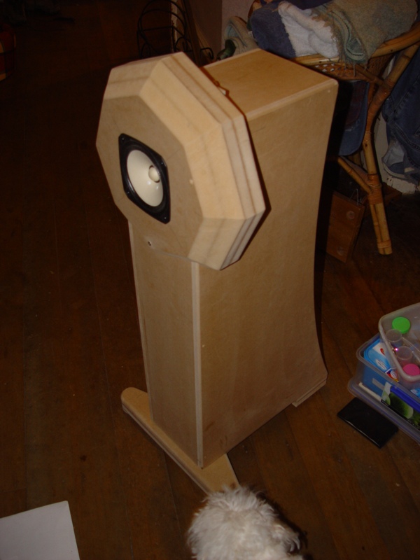

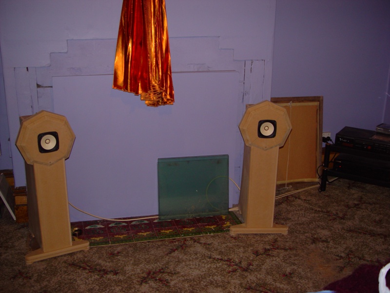

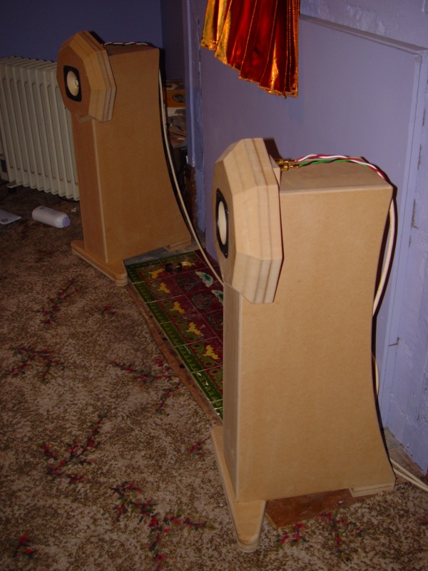

I finished building my first ever pair of speakers about 2 weeks ago and love their sound.
Haven't finished the deflector yet so there could be further improvements to come.
They were built from mdf because in the small town where I live there's no decent plywood to be had, however I'm in the process of sourcing some suitable ply to build better cabinets.
I'd like to build the wedgie version if it's an improvement.
Your thoughts please.

Horns are designed for a particular driver. Sometimes you get lucky and a different driver sounds good. I'm not sure what the frugel horn is optimised for the fostex drivers model horribly in them. I found a $5 Aiwa speaker at a surplus store that blows the FE126e out of the water when it comes to bass response in the Frugel horn. The Frugel horn was the first horn speaker I experimented with but when I learned how to use Hornresp I discovered it was a real waste of a fantastic set of drivers (the 126s) Your always better off custom designing a horn for the particular drivers you have.
The Frugel's were in fact designed for the fe126's/fe108ez,s

Nice job, brendanr!
Don

Yes I am aware of that, I was being sacastic. The frugel horn is an greatly compromised design. The only way to truly realize the potential of the Fostex drivers(or any full-range driver for that matter) is with a compound horn that maximizes the speakers efficiecy and dynamic range. Despite what all the nay-sayers say (and this site is full of them) they are not difficult to design or impliment. The benefits of this design far out weigh any percieved problems (I don't know of any real problems).
Here's a thought: the gentleman is happy with his build. How about not trying to take the shine off it by pontificating on your own views immediately afterward? I might add that your remarks are your opinion only, not fact, as you present them.
For myself, I had little to do with the FH design, which was intended to meet a very specific requirement, but it's remarkable the number of people who have built them and are delighted with the results isn't it? Just to echo the above sentiment, nice job brendanr. 🙂 Glad you're enjoying them. In response to your query re whether the wedgie version is superior or not, I suspect the jury's still out. On paper, it should have a slight advantage IMO, but whether or not that translates into an edge in practice is more open to question; it might have a slightly cleaner roll-off above the upper-corner.
