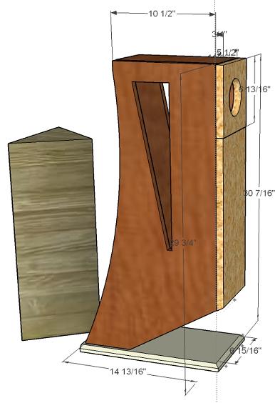

A few questions.
So I'm looking at how much ply I'll need... you said a few pages back that you can manage to squeak 2 horns out of one 5'x5' sheet of ply.
I can't for the life of me figure out how! Unless you meant only the Level 0 version... Happen to have a cut-sheet?
Can I get away with 1/2" 7-ply Birch, or is that asking for trouble? Mine aren't going to be cranked to high volumes, so I won't be putting huge vibrational stresses on 'em.
Also I'm considering cantilevering it somewhat, as suggested earlier in the thread. Like so: image link. (attached to post as well.) I'll glue it and screw it into the base from the bottom with nice long wood-screws. Any comments/concerns?
klocwerk said:So I'm looking at how much ply I'll need... you said a few pages back that you can manage to squeak 2 horns out of one 5'x5' sheet of ply. ....
The inner panels are 1/2" (12mm) the front, side, top & bottom are 18mm. You could build it of all 1/2". If you rebate the driver you might to double that up.
That should work... you could further improve it by extending it to underneath the deflector andsand fill theat and it should make sure nothing moves. You might well be able to lose the front part of the bass completely.
dave
I had considered that, but I'm still not certain if I'll be able to add the deflectors. Gotta do some measurements of the living room. If I can pull it off, I'll definitely lose the front piece of the base.planet10 [/i][B]The inner panels are 1/2" (12mm) the front said:
That should work... you could further improve it by extending it to underneath the deflector and sand fill that and it should make sure nothing moves. You might well be able to lose the front part of the bass completely.
Thanks again Dave!

Taperwood said:Another pair will have to be built to be absolutely sure (of which I heartily volunteer). They're fun speakers to build.
Well crap.
I just took my new set of 126E's and held them roughly where they'd go in relation to my TV set.
BWONG! gausification. I thought they'd be far enough out to avoid any effects, but apparently not.
What tweaks do i need to make to the CC in order to use a pair of 127's instead? or is that simply not recomended for the Frugel, and I should find a 127 based horn project?
*edit*
or is there another shielded full-range that would work well in the FH?

Yup, those honking big magnets can play havoc with a CRT display!
IINM, there may have been a couple of builders us 127E's in the FH, but I'd personally suspect the FR will not be as neutrally balanced as with the type driver for which it was optimized.
If circumstances force you to use the shielded drivers, and you've not already cut material for the horns, you could consider any of several other designs posted on Dave's site that are proven to work well with the 127E i.e the PAWO, Fonken, or Mileva (new design for Mass Loaded Voight Pipe). I've built several of the first 2 named, and will shortly complete my first pair of the last. The PAWO and Mileva are floorstanders, the Fonken needs a stand.
While the Frugel horn outshines any of the monopole 127E based designs I've yet heard,(i.e. none of the SPAWN BVR family) the 3 listed above are still quite satisfying. Of these the Mileva is by far the easiest build, and according to my source on the subject, has high WAF, since it's not 60" tall with dual gaping mouths!

klocwerk said:126E's ... TV set.... rainbows
The answer to the question about FE127 is still not definitive. Josh in Atlanta has built 2 sets (actally 1 + a friend built a set after he heard them) with FE127 and they are quite happy with them. They built with the smaller chamber, but i would recommend starting with the larger and filling it up with blocks unti you hit the seet spot.
The alternative is to shield the TV or the FE126. I noted as i paged back to this question that Moray has some pointers on this subject, i'll read that post before i comment further.

I played with shielding a bit... another approach is to shield the TV instead of the speaker (as the magnetic field decreases with the square of the distance. A sheet of magnetic material (steel, iron, muMetal or the like on the side of the TV.
dave
dave
Joined 2002
planet10 said:I played with shielding a bit... another approach is to shield the TV instead of the speaker (as the magnetic field decreases with the square of the distance. A sheet of magnetic material (steel, iron, muMetal or the like on the side of the TV.
dave
Wouldn't you want something that is not magnetic ? Like copper or aluminum ?
Id like to make my new speakers shielded. Can i just put a piece of aluminum tube around the magnet ?
jleaman said:Wouldn't you want something that is not magnetic ?
No. to shield a magnet you need something that sucks up or redirects the magnetic flux. A magnet field will pass thru Al or Cu more or less untouched.
Fortunately the advent of the flat panel spells a day sometime soon (i hope for me personally anyway) when worrying about driving CRTs nuts will be a thing of the past.
