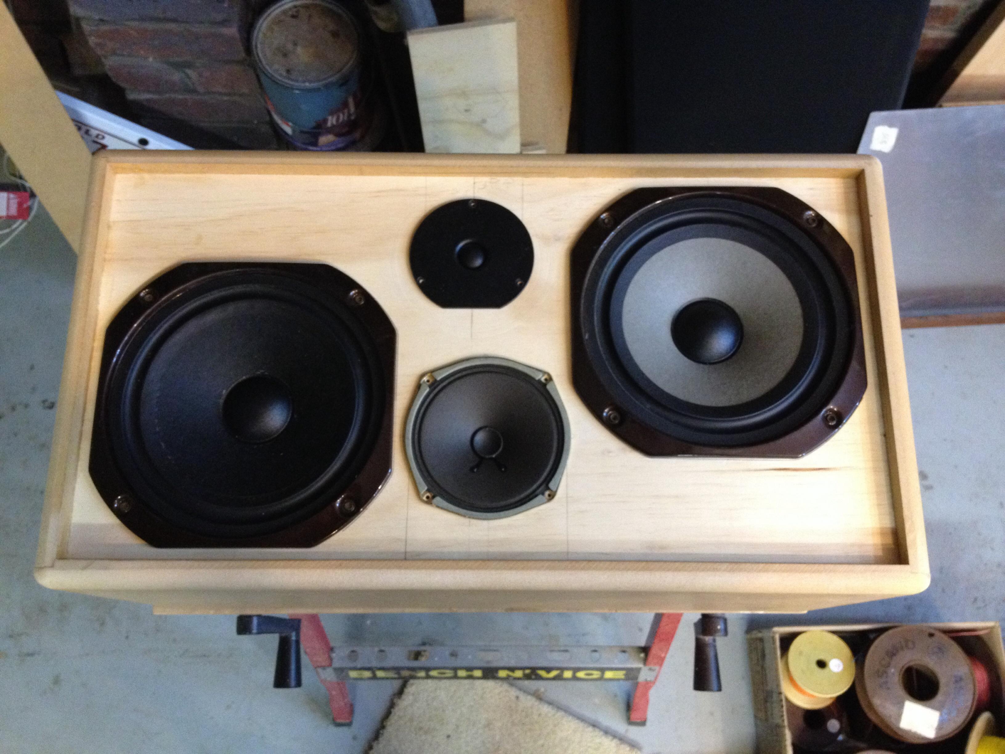

For this "detour" design I have to hand a pair of potted Coral 5M-12, 8 ohm, 40W, 800hz-14kHz, plus a pair of Vifa D19TD-05-08, 8 ohm.

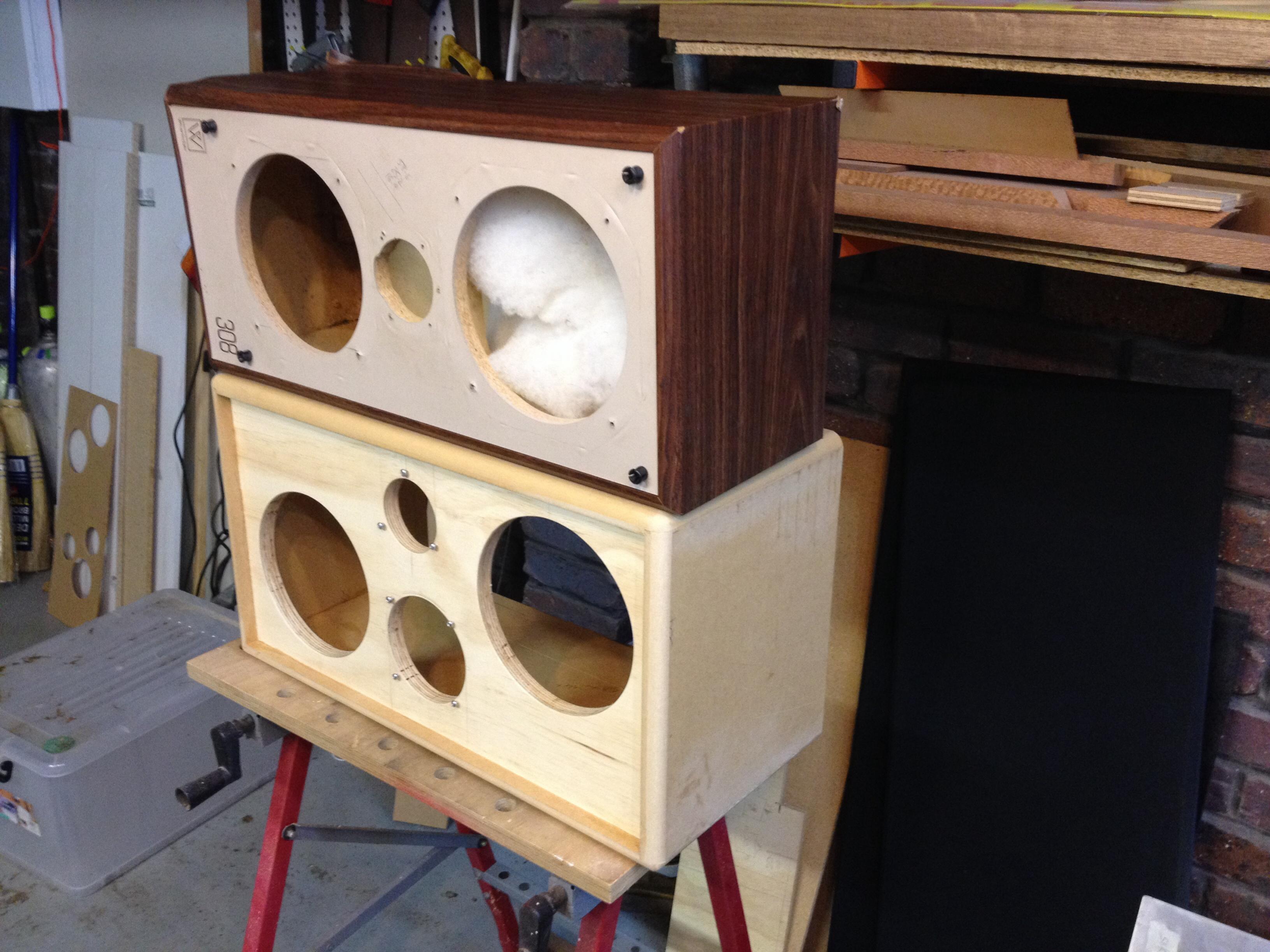

... and here is the prototype (mule), along with the bass driver donor.
The mule is made to the same external dimensions as the GS401A.

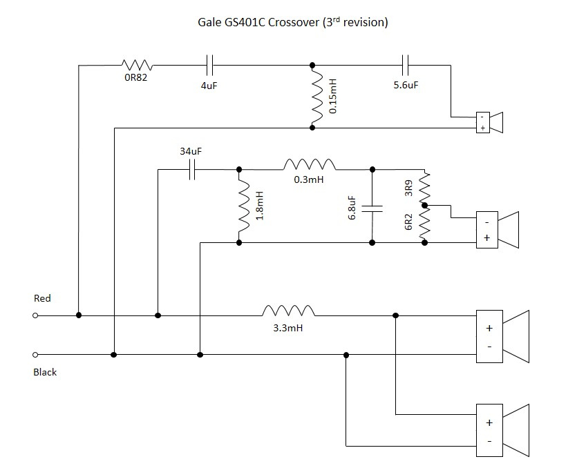

Well, for somewhere to start, I've tried this XO. (The Gale 3rd revision.)
RESULT: the mid needs to be padded a little more heavily. What values should I use to replace 6R2 and 3R9?
The mid is 8 ohm, 40W.

I think a bit of method and investigation is in order here, Austy.
You need to measure the working drivers for DC resistance to start. Use a multimeter on the bare drivers.
Looking at the schematic, one mid might sound louder if the 6.2R has gone open circuit. It really surprises me if one mid has gone quiet, unless they have AlNiCo magnets which can lose magnetic field strength over time. There is a specialist machine that can "Recharge" AlNiCo magnets

The tweeter can be measured in situ, since I don't see a DC path there. Use 200R meter resistance or ohm setting and common and the adjacent socket.
If the meter is working right you'll get about 0.2R when you touch the probes together and about 6 ohms across the tweeter.
The mid is best disconnected at one point, because there are DC components in the crossover that will affect the reading.
Make notes of any wiring colours before disconnecting too much. Test all 4 mids and tweeters.
