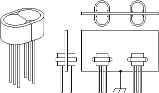

Far as the drivers and VBE. I always wanted to try to bond all 3 transistors
using a method from a 70's CFP amplifier called the gemini.
All 3 transistors mounted between 2 copper plates.
Or just track one driver mounted back to back, as shown above with copper band

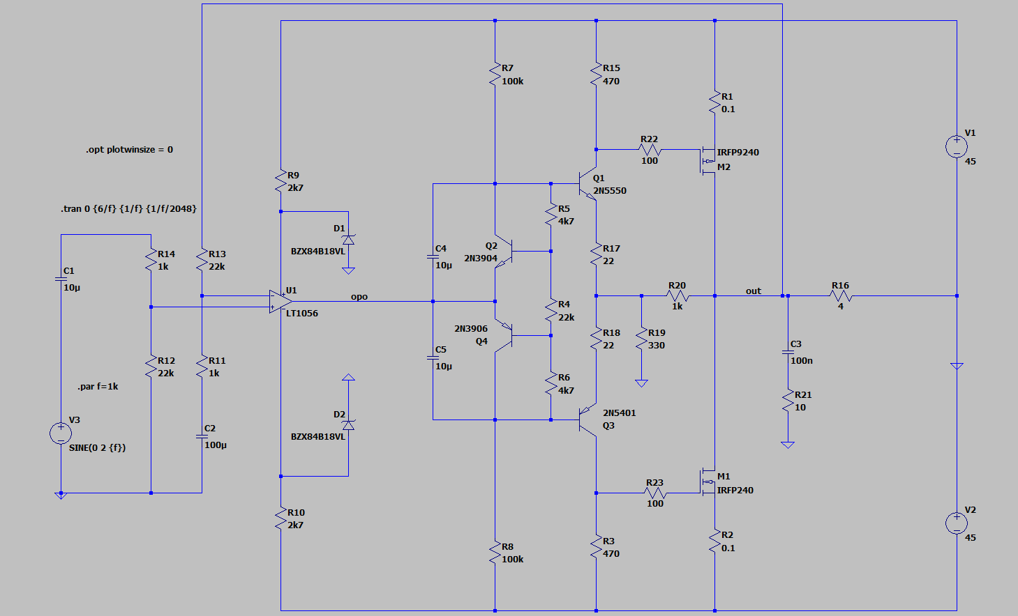

Some good ideas but:
1.R20 and R21 are unnecessarily low resistance which means they will run very hot. 75 Ohm gate resistors requires 50mA+ to drive VMOSFETs, much more than is useful.
2. 0.1 Ohm resistors are only useful in the source; of no value in the drain circuits.
3. The driver DC bias need only a tiny current with the AC drive coming from the op-amp.
4. More CFP gain allows more output voltage/power.
If I remember low values for r20, r21 helped reduce distortion.
But yes exactly, run hot. around 3 watts. I was thinking 5 watt resistors.
But exactly as suggested would just be better if they didnt get hot.
I will try and play around with everything suggested.
All straight forward and makes good sense.

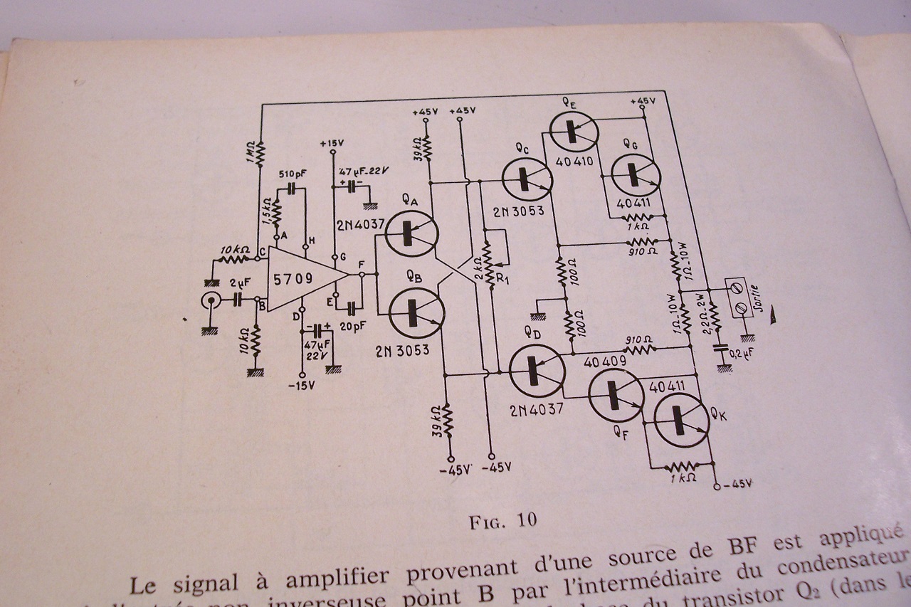

The topology has been around for a long, long time.
Here is such an early example, with opamp and everything:
attachment.php
Of course, in the seventies there was no question of usng MOSFETS.
attachment.php

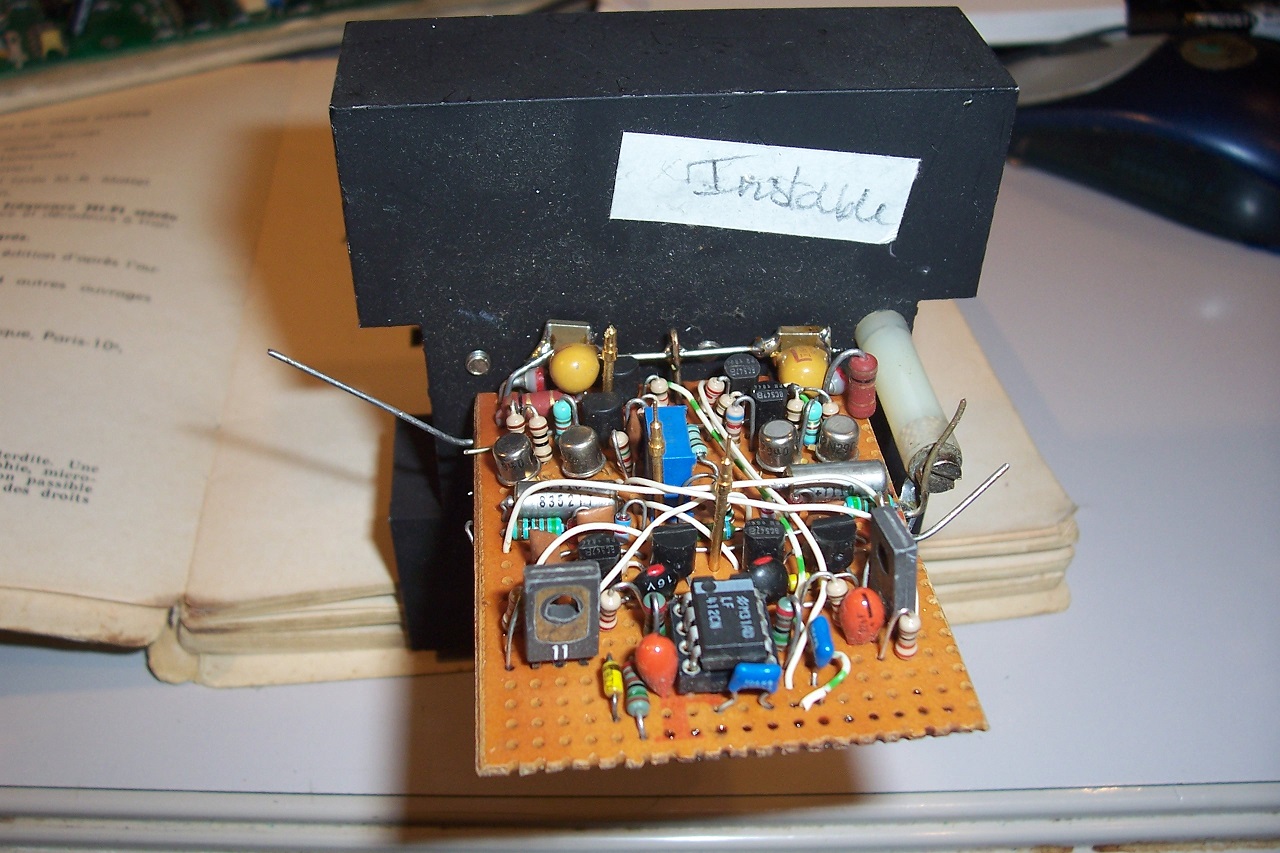

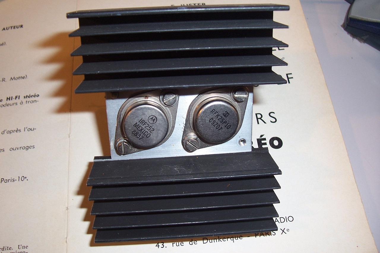

I have myself experimented with it, and had mixed results.
Here is one of my (~failed) prototype:
attachment.php
attachment.php
I had aimed at an insane bandwidth, and as a result the thing was not very stable.
But it's like anything: with good engineering, it is certainly possible to make it work.

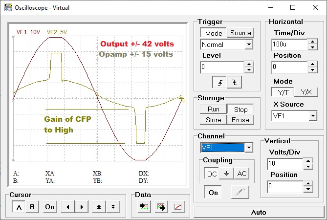

These things like to oscillate and then blow up, because cross conduction is worse than with unity gain stages. WHEN it oscillates, the result has a higher photon torpedo yield than a follower would. If you get it stable, that problem is solved, unless you try to drive it with a high enough frequency square wave that it becomes a problem. On only an 18 volt supply (with a current limit, even), you probably can’t generate enough energy to do any damage if something did happen.
The other issue is what happens when the stage is over driven. When the output transistor clips, the driver will continue to try to supply voltage and current. If this is managed, there will be no issue. Failure to manage it could result in overcurrent in the driver stage, and overvoltage at the mosfet gates. Try simming with a +/-50 volt supply, and drive it with close to +/-50 volts, and monitor the internal workings - the result will (and should) make you very nervous. With only a +/-18 supply, I doubt you could generate enough voltage to punch thru the oxide on the hexfets or overheat those ZTX’s. In amplifiers like the QSC PLX, baker clamps are used on the output darlingtons and the op-amp’s limited swing kept the driver current under control.

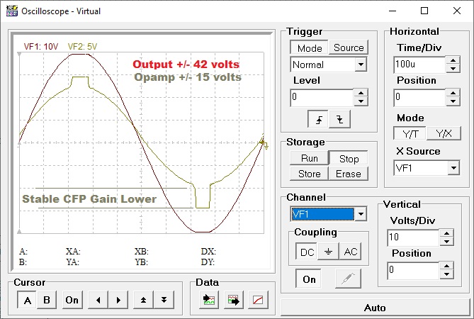

Best way to tell if the gain is too high.
Is to look at the output of the opamp
and drive the amp into clipping.
The opamp
will try to compensate for the clipping of the output stage.
Till it hits the top of its 15 volt rails.
If the gain is way way to high. You will see huge towers in the signal.
And you should minimize the CFP gain to reduce those towers to the bare minimum.
Of course the opamp will now use more signal swing under normal operation.
But it helps set the minimum gain needed of the CFP to keep the amp more stable.
Below the scope shots show
Red output of the amplifier on a 10 volt division for a +/- 42 volts
Gold trace is set to a 5 volt Division for the opamp +/- 15 volts.
Output is driven to slight clipping and, the opamp tries to compensate.
The height of those towers shows how high the gain is set on the CFP.
So yes you are driving a amplifier to +/- 42 volts. But you are using
way way to much gain in the CFP, and it will be unstable.

Next scope shot shows the CFP Gain significantly reduced.
But still drives output to full +/- 42 volts.
Reduce gain to bare minimum and the amplifier will
be more stable.
