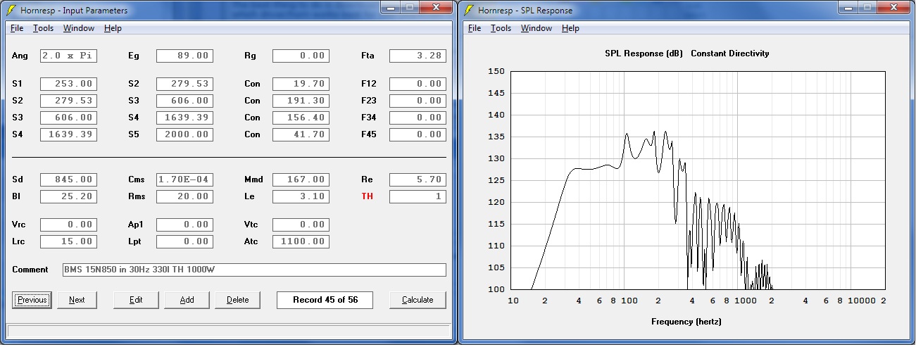

This box posted by ianb from post #61 of the 15" tapped horn with RCF thread is about a 3rd bigger than the SS15 volume wise and will do around 30hz. Considerably higher compression ratio though.
The same design modeled with my sub in it.
So -3db at 30 hz which is within the rules of this challenge. Much higher compression ratio, would be interesting to see if the driver stays intact. Could we make this box from 1 5x5 or 4x8 sheet plus a 2x4 sheet?
