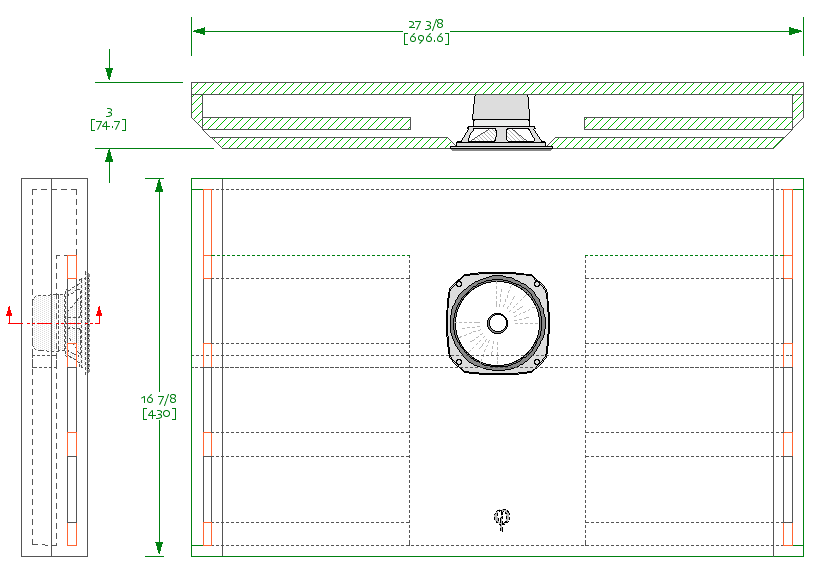

Over on the Full Range Forum we were talking about wall mounted Fonkens, so i quicjly threw togther a couple concepts... i have a 3rd version gestating.
the 1st one....
Before we build any i'll go thru are least 1 more design iteration. I have learned some tricks from speakers that have been built since then.

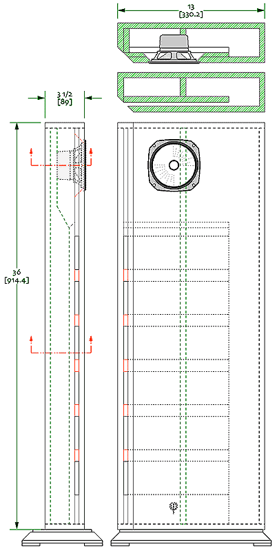

and the second thinner version... keep in mind that the longish shallow spaces could cause some expected "anomalies"
dave
The appearance reminds me of some of the early Wharfedales ?
Could this be redesigned to be tall (er) and slim (mer) like floorstanders up against the wall ?
